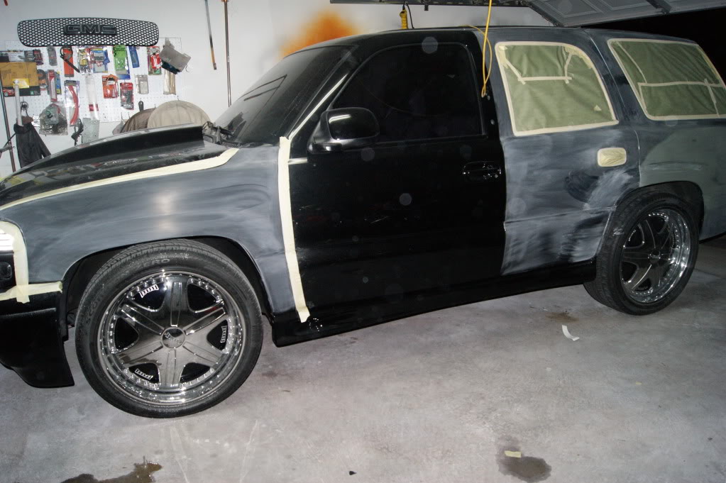

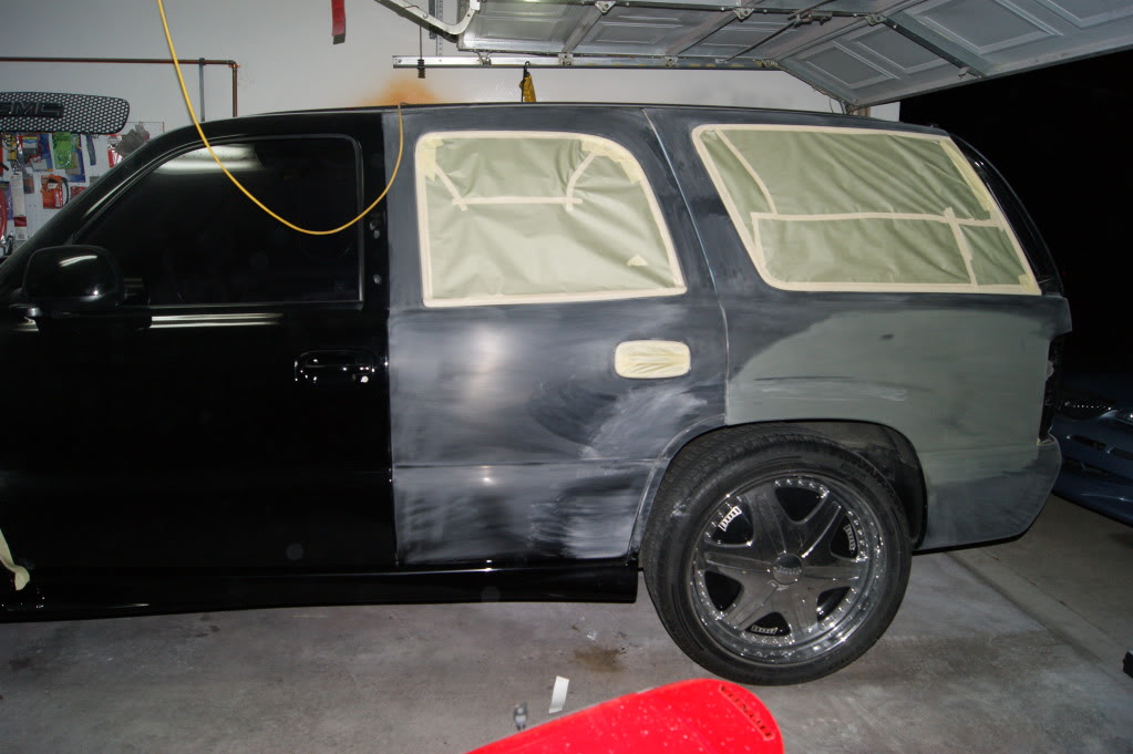

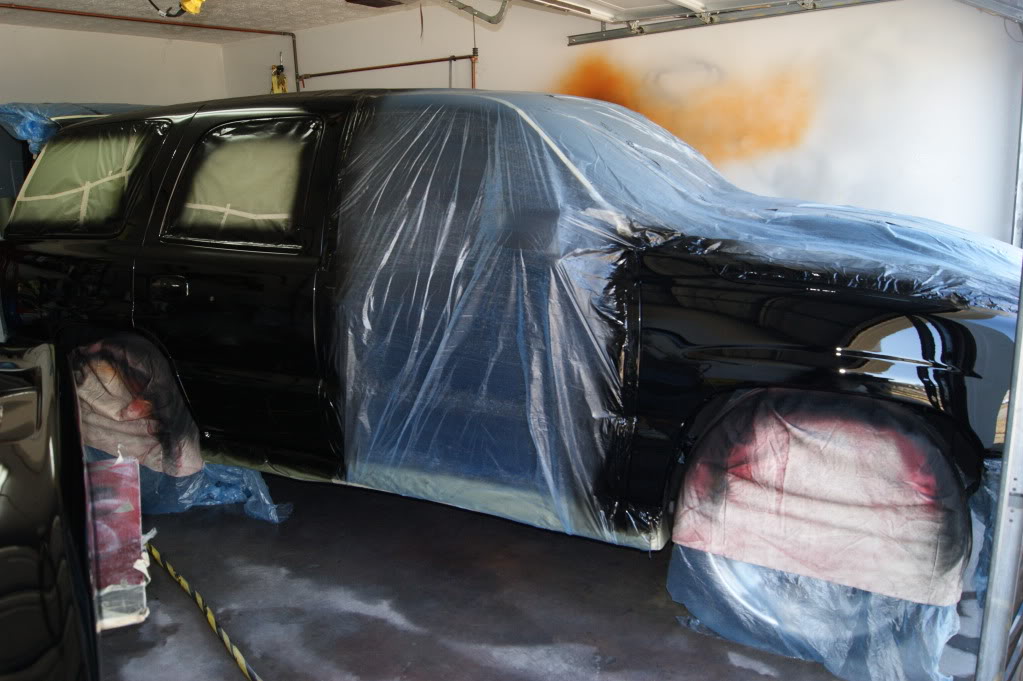

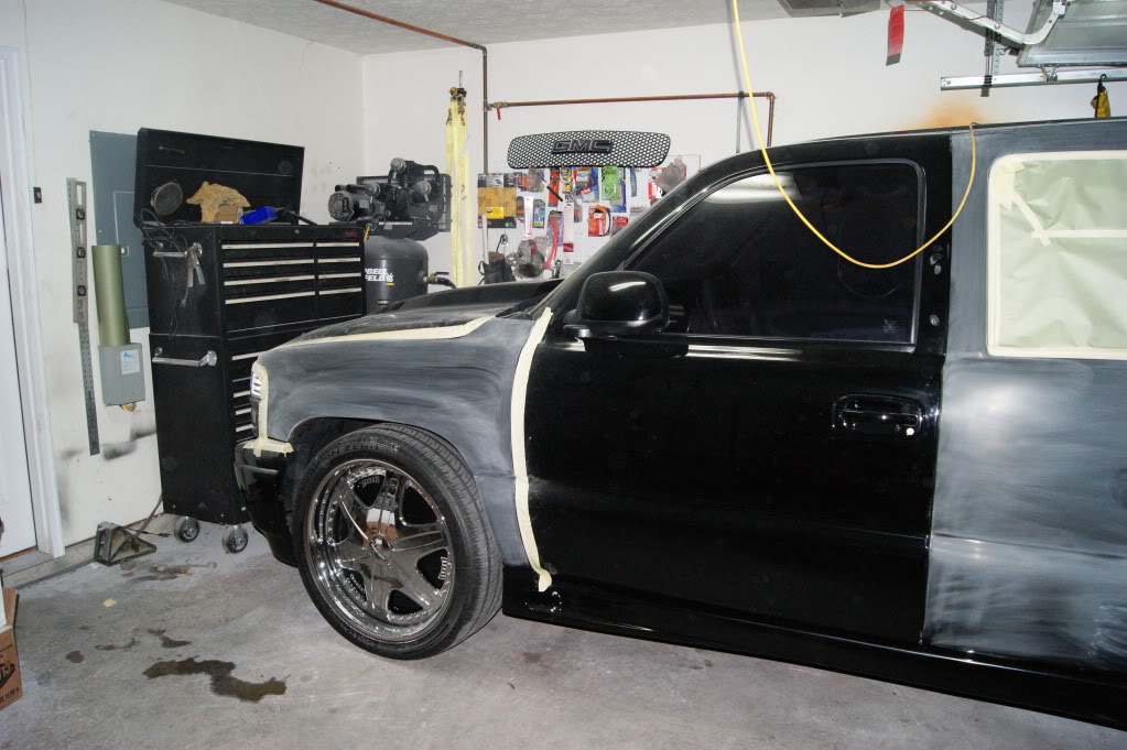

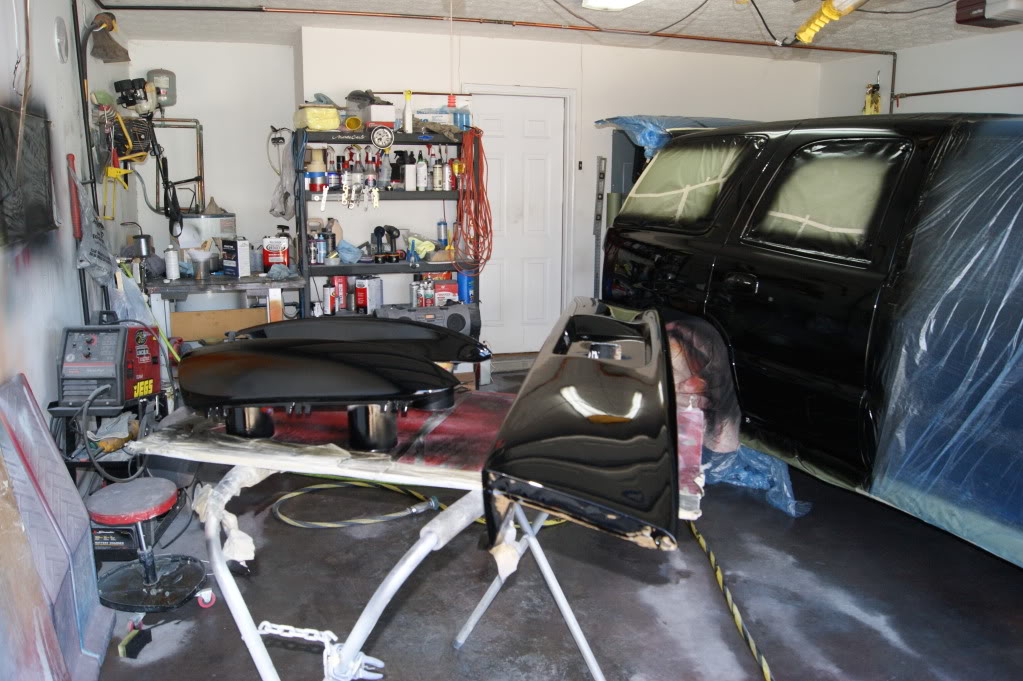

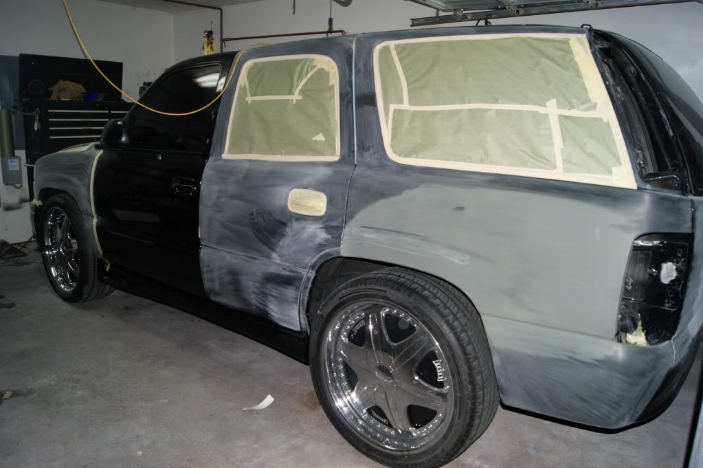

builds looking good. word of advice though. never prime to a solid tape line. longstory short, you think the tapeline is sanded out but its not. from certain angles youll still see it when its painted. cover the body work up and then pull the paper back if that makes anysense. other then that. looks real good man.
carcrz
carcrz
Dec 21, 2009
875
80
Georgia
i agree 100% with you the reason for the tape was to keep me focus on that area i tend to wonder off when i dont do it like that but i will be sanding and primering a couple of times before i lay the paint down but yeah i know what you are talking about.

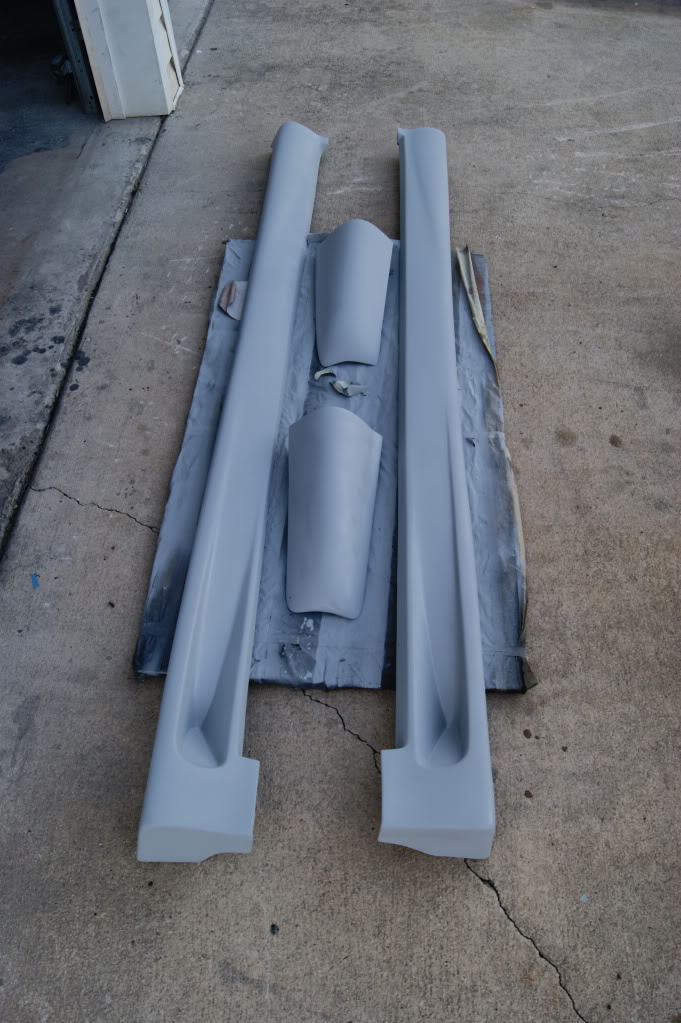

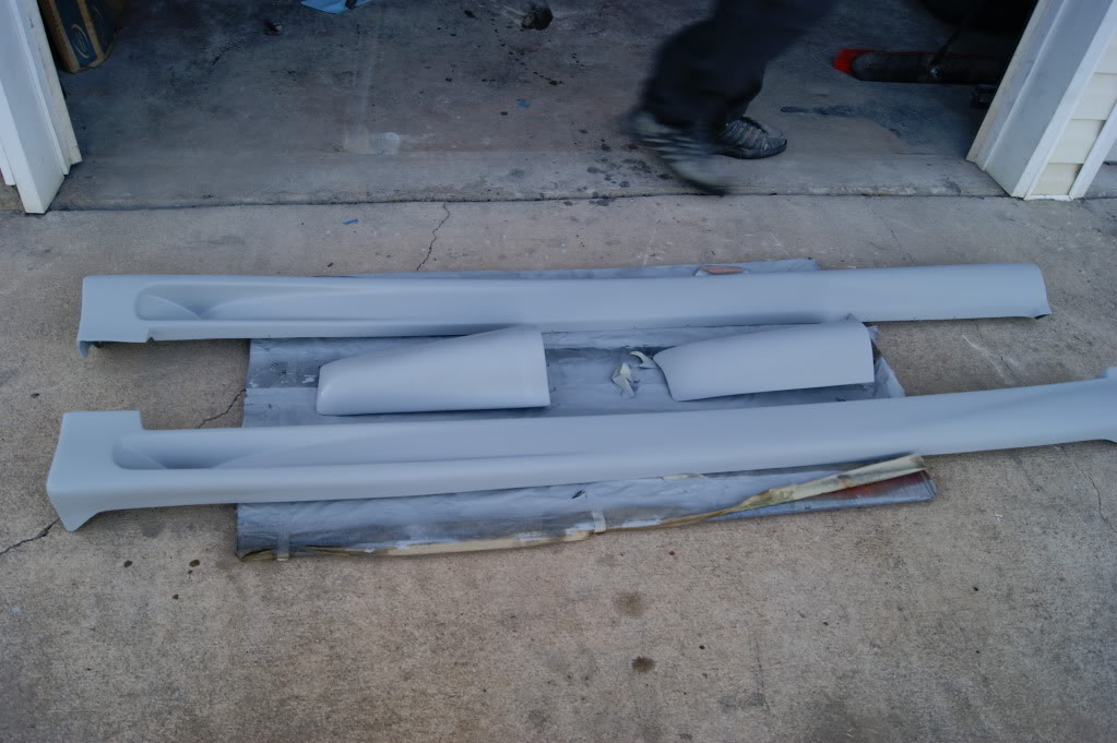

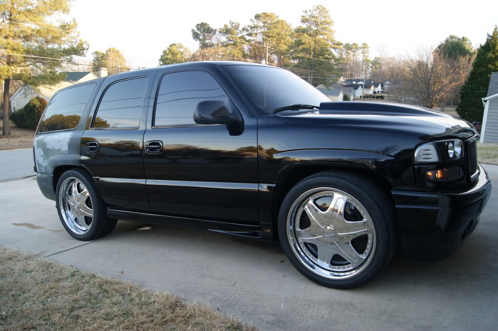

well i finally took the running board off and it looks funny, cant wait till i get my skirts
hopefully by friday
