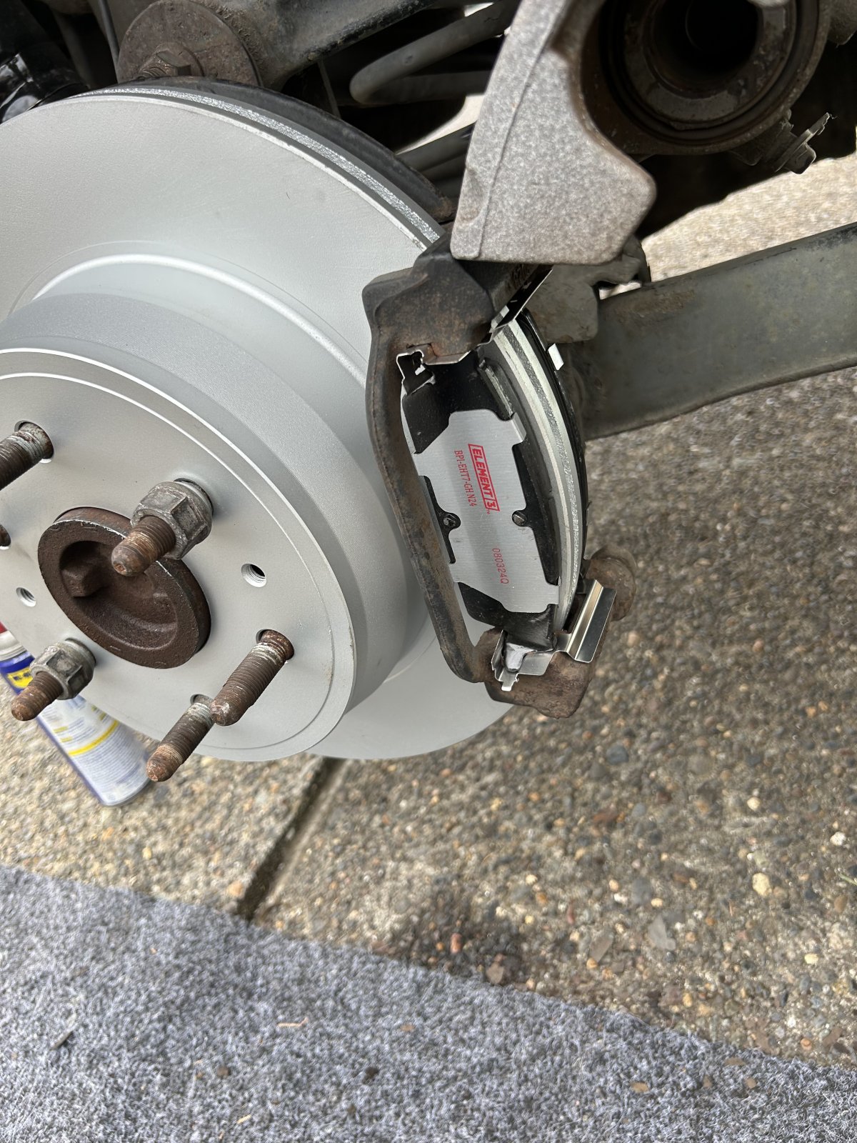

Finally got a break in the weather today so I installed the new rotors and pads. The lowering springs and shock relocators were supposed to be delivered yesterday via FedEx and then it was changed to today
and now they say “weather delay” even though they’re in town and the weather is nice. So maybe tomorrow? Stupid FedEx is the worst. I have the bolts and spacers for the front to remount the struts to under the control arm for a 2” front drop. The springs are for a 4” rear drop. I pulled the rear ride height sensor rods off to modify.

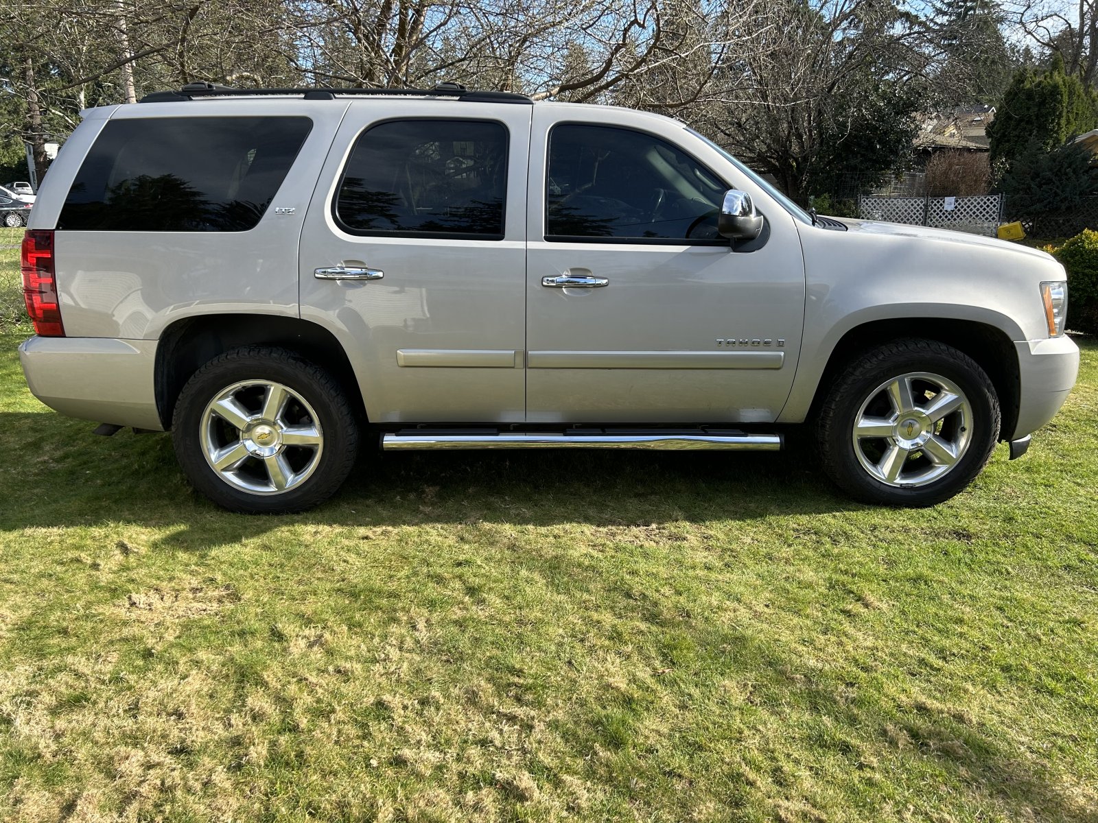

Did the drop today, and so far it’s a 2/3 not a 2/4 but the rear is still settling I believe. Plus I need to do a ALC trim set with the Tech 2. I shortened the rear ride height rods from 4” to 3” on a guess and I might have to tinker with them. The compressor came on but didn’t lift it but I had started it up while the suspension was hanging so the shocks might have had extra air in them. It should have exhausted any extra on the test drive though. Turns out the front LCA’s are aluminum so I didn’t need the spacers I bought. Just flipping the struts to under them gave me a near perfect 2” front drop. I have a tiny bit of rubbing on the LF on sharp right hand turns due to an inner fender liner hanging a bit but otherwise the test ride was great, the EBay springs ride nice. It cost a whopping $230 in parts. The yard shot is before.
Looks great!!
