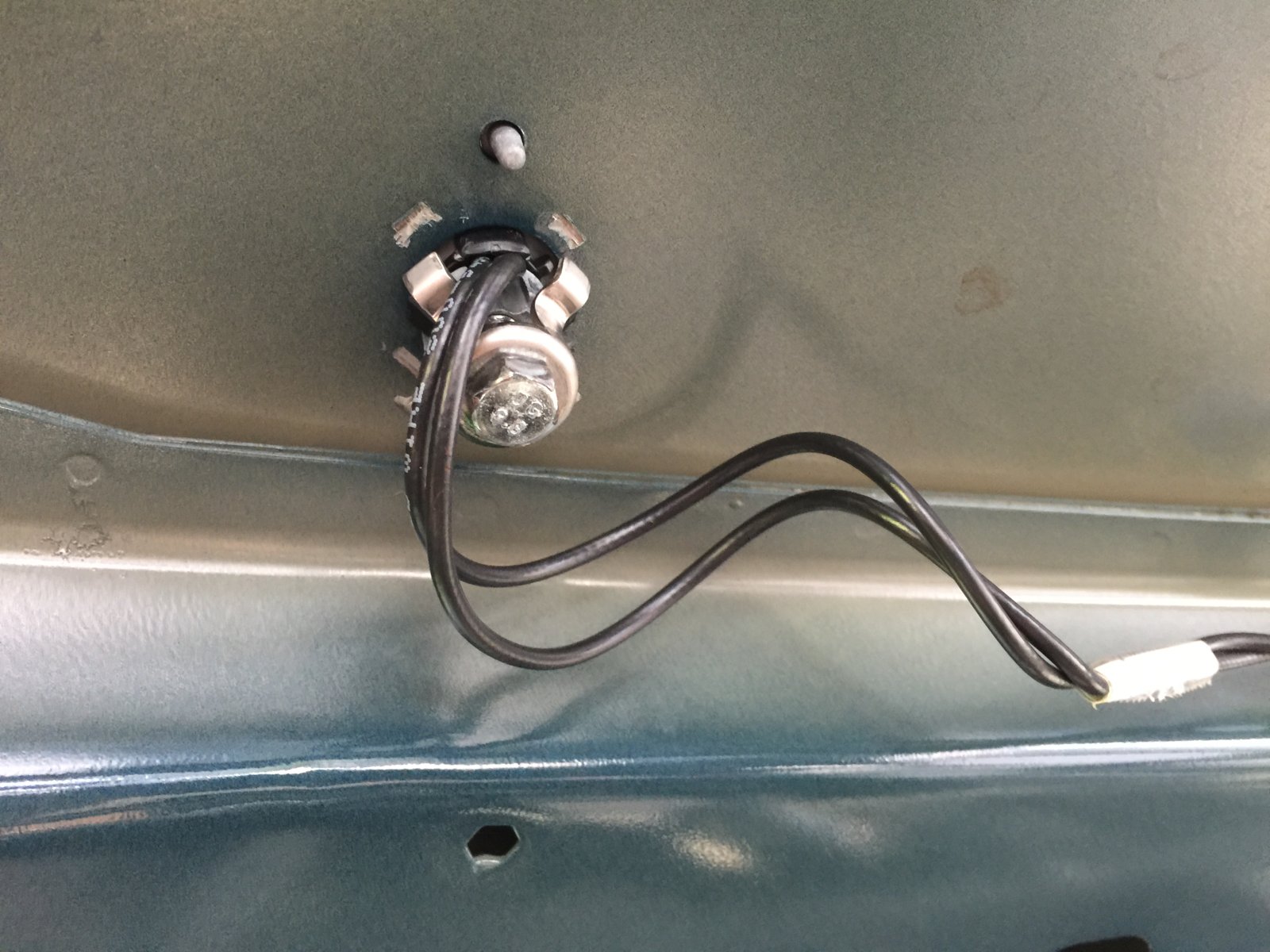

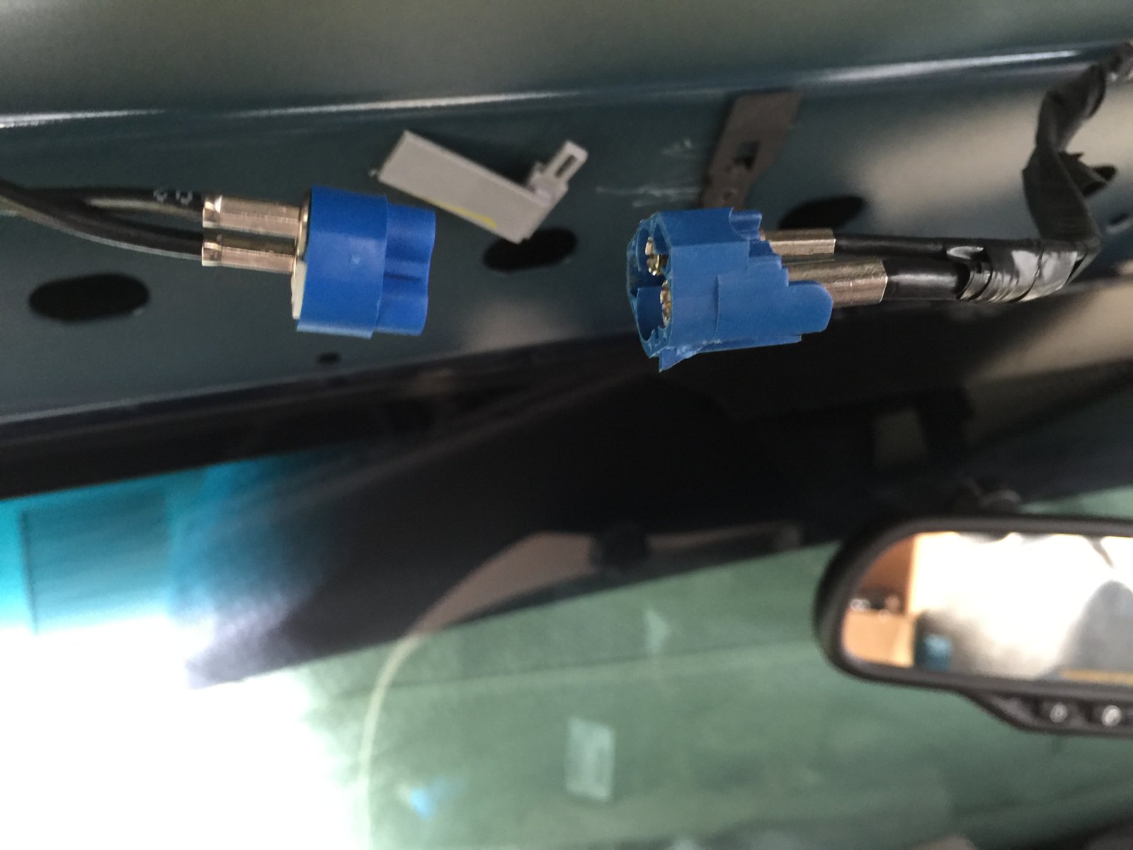

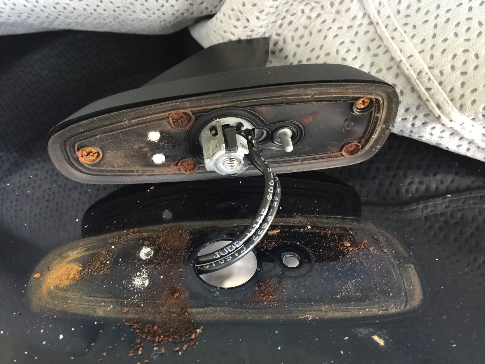

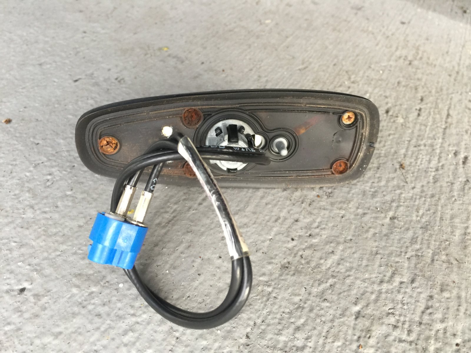

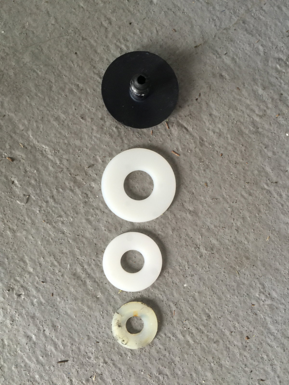

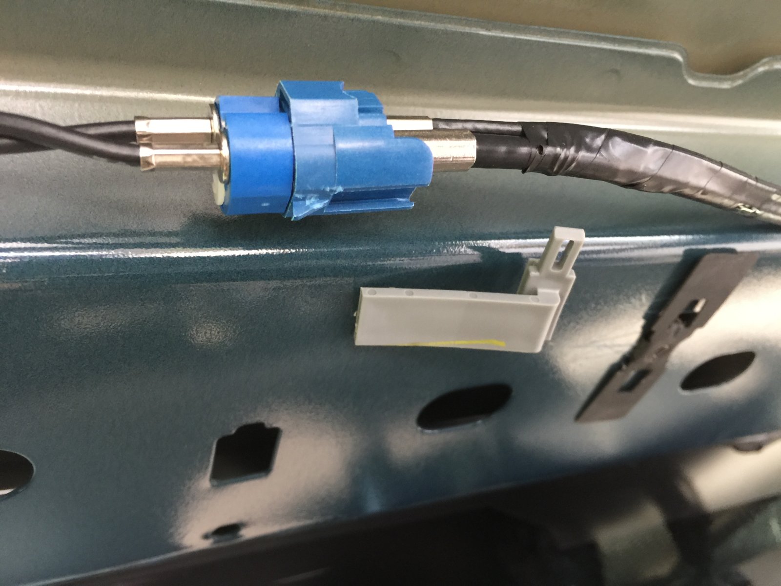

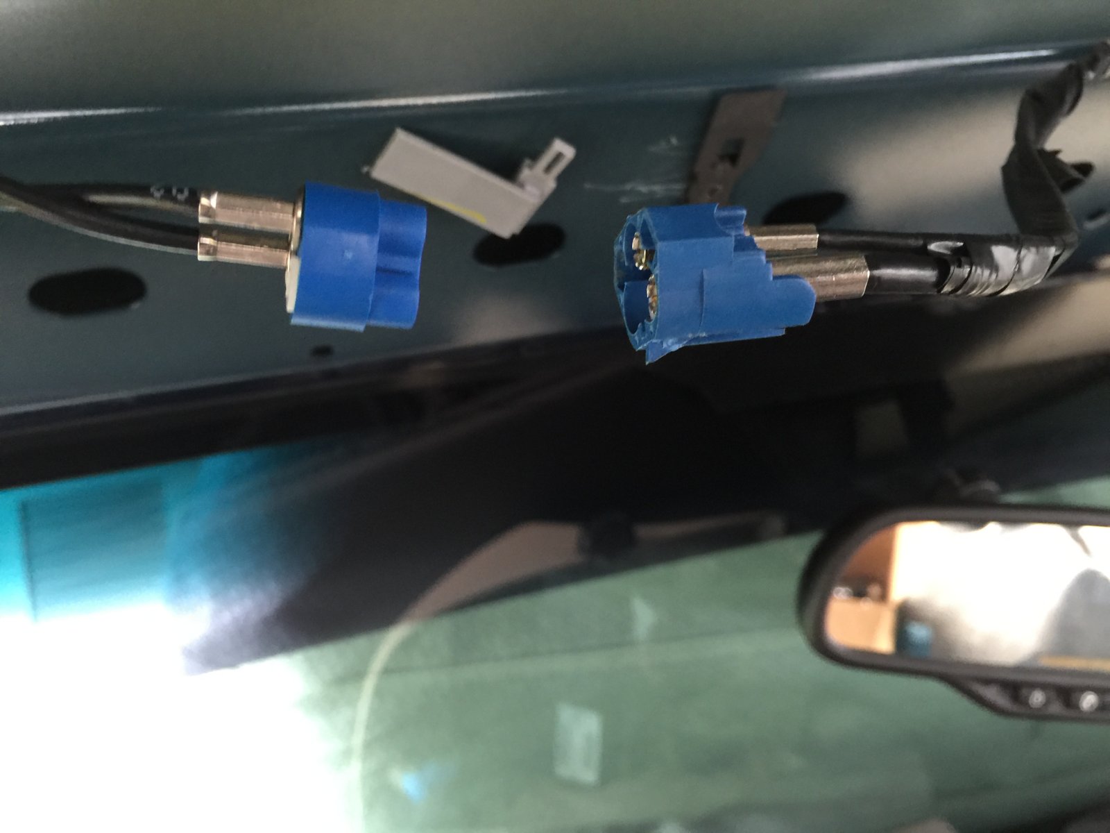

Here are some pictures of the OnStar antenna.
One nut inside snug against the roof.
The plug that runs at the top of the windshield to the overhead console to unplug. I also pulled the little black microphone and tossed it along with the shark fin thereafter.

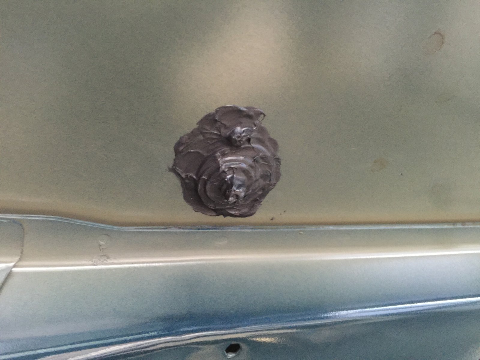

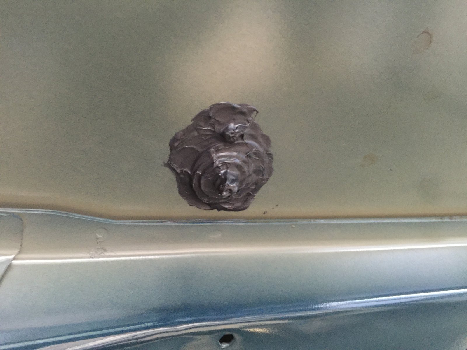

Plugs are just plastic body plugs from Lowes or local hardware store that had big enough head to full cover the hole in the roof.
Checking the fitment. I also got ones that had the plastic thread so that I could fit a nylon washer on the back and push it up tight against the inside of the roof to help seal the black silicone to the roof, inside and out. Plus no metal on metal contact, thus no corrosion either. The smaller hole takes a very small plug. I cannot remember the sizes, but less than $5 for all plugs and goop, plus your paint.
I color matched them first, gooped them up so that every millimeter was covered and put extra on the inside as it was under the headliner, pushed them tight against the roof and wiped off the excess on the outside. I left the inside with excess for good measure. I followed the same plan on the liftgate when I deleted the rear wiper. I have had no leaks in over 2 years.
OnStar antenna deleted and you can see the plug.

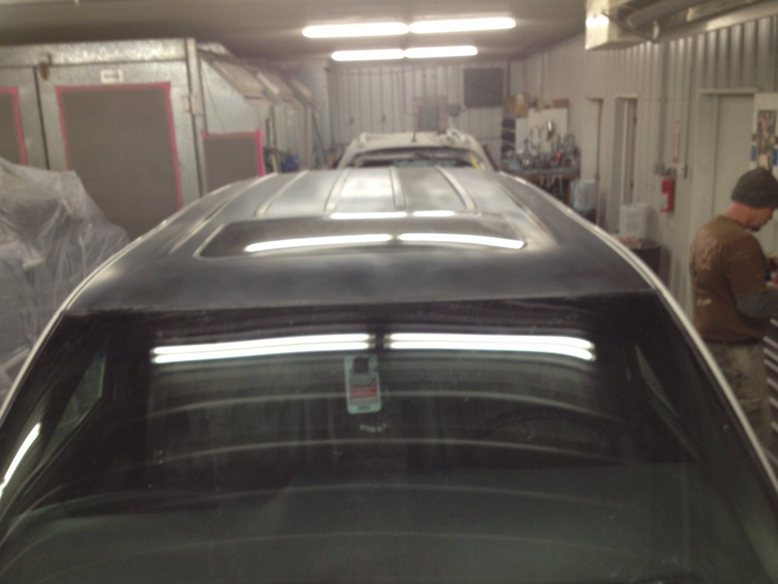

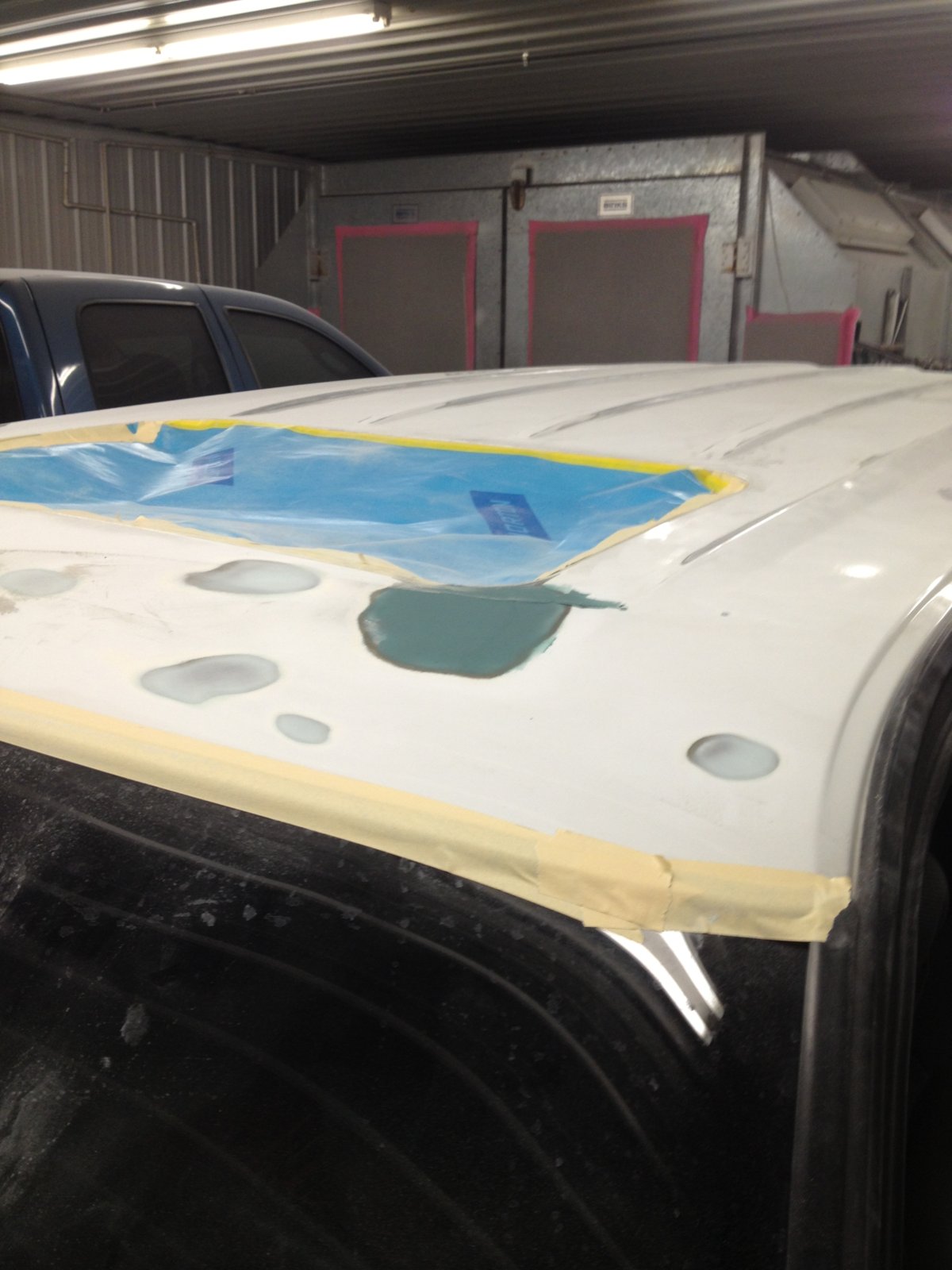

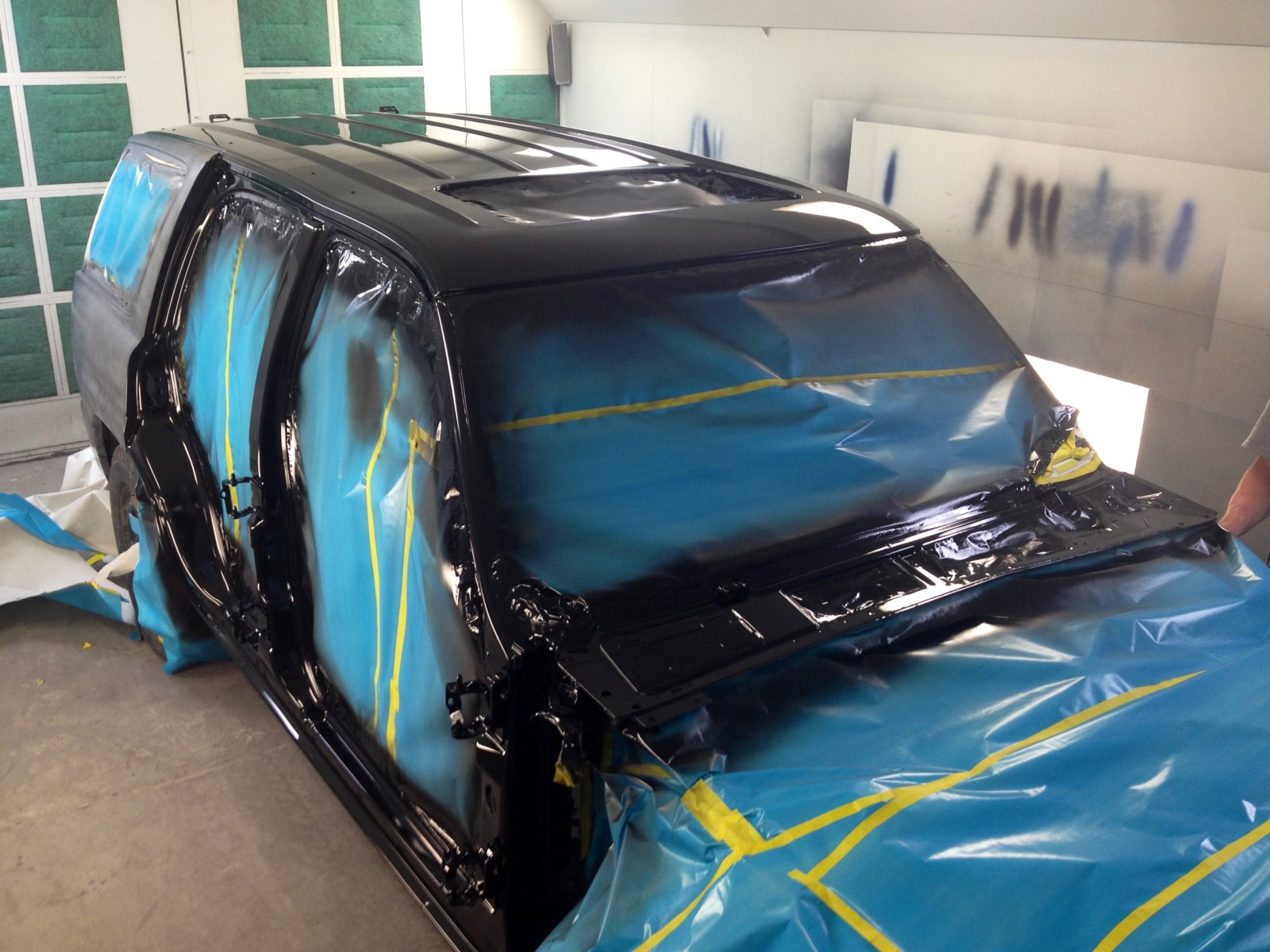

I shaved mine as well. Fosscore already gave a great explanation on removal. I welded in a plate and smoothed mine out since the whole thing was getting painted anyway but the plug method sounds like a great alternative as no one is likely ever going to see up there anyway.
