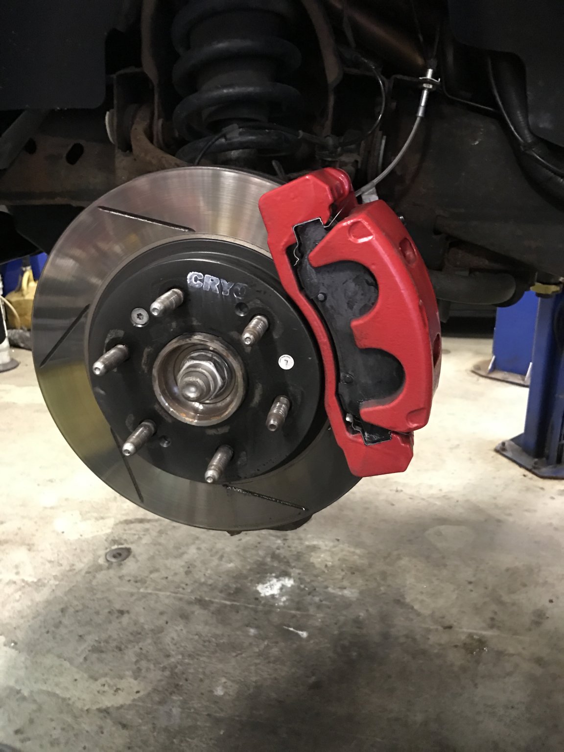

I did stoptech slotted rotors. These with stainless steel lines and brakes grab with no fade and is still like you pumped the brakes with the truck off.
