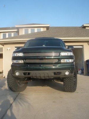

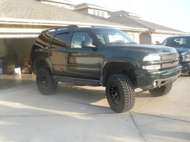

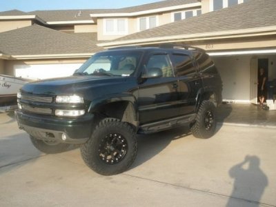

Just got it installed! Rides well so far, lets see if it holds up to the beach...

what wheel/ tires size are you running?
what offset or backspacing on that wheel? any rubbing issues?

looks great from the looks of ur pics u didnt have to trim near as much as i did on the fenders what tire size u running and wheel offset

They are 35x12.50 trail grapplers and 18x9 addicts with 4.5 inch backspacing(-12mm offset) Ive had some rubbing issues due to my bumper sagging a tiny bit because of a fender bender by the previous owner. Ive managed to grind off some of the bumper at the fenderwell to keep it from rubbing until i can afford a better bumper!
