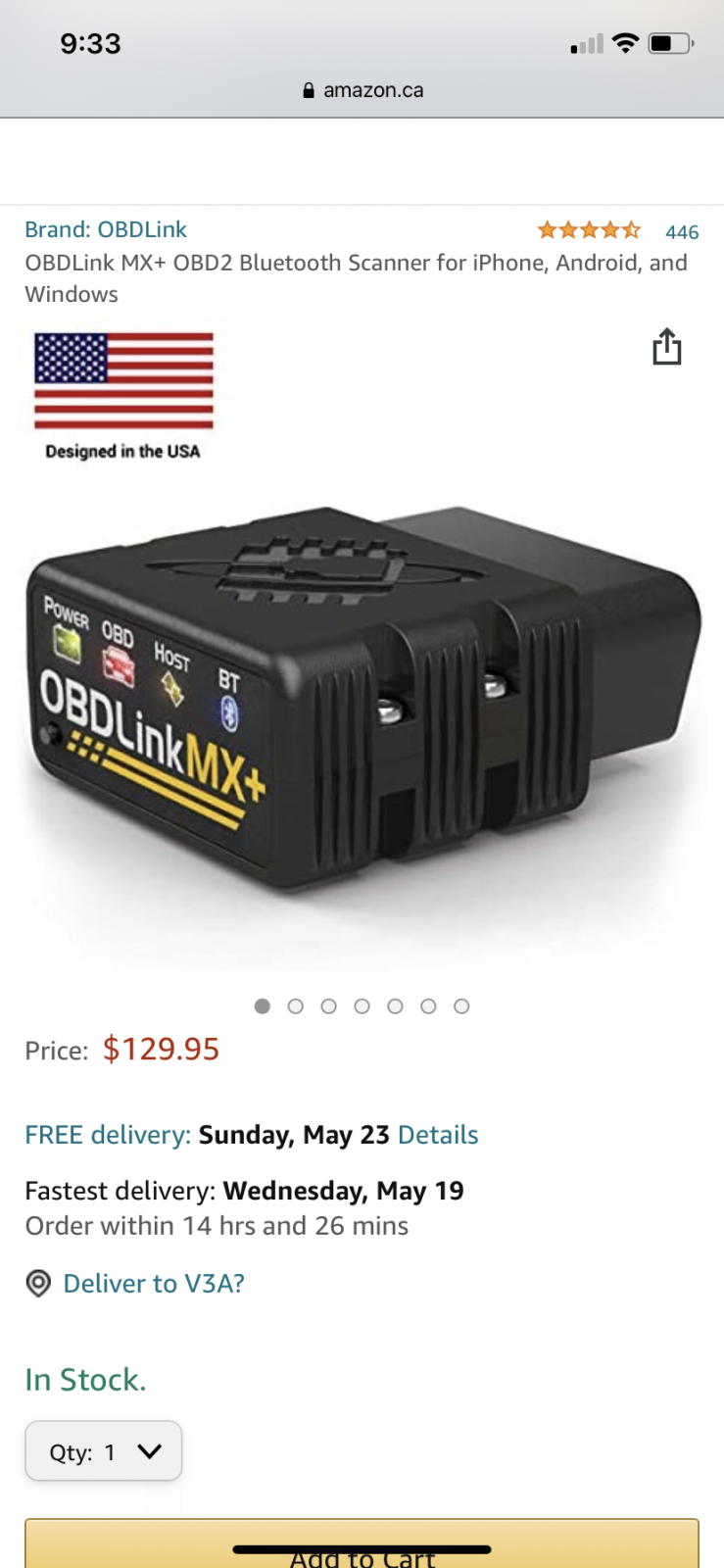

I went with OBDLINK MX+ bluetooth scanner. I downloaded DashCommand off the App Store, and did the in App GM Extended Parameters for $9.99, which allowed me to read Cam Retard Offset to dial in the distributor.

I also ordered a bafx-OBDII reader and will then use the DashCommadn-app like YukonGTmaster recommends or the Torque Pro-app in order to set the right timing of my new distributor (idling could still be a little smoother I guess).
