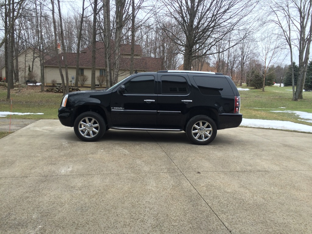

Because I did a 2.5'' front and 1.5'' rear on my truck. I measured and there is less than a quarter inch difference front to rear, BUT when you look at it it looks like it is leaning .75-1''. You really have to look close, but it's almost an optical illusion. The way the truck sits from the factory the wheel gap is proportional so when you lift like i did at a 2.5:1.5 ratio, the wheel gap changes and it looks a tad bit saggy. Just a heads up!

Thanks for the explanation and the pics, I definitely see what you mean. For the rough country lift, it looks really straight forward of an install on the front. Not so sure about the rear. How was the install of the rear blocks in your opinion?

You're welcome! The black makes it tough to see and this driveway it slightly slanted. Looking at it on a perfectly normal drive, it is literally dead nuts level front to back. It looks bigger, but it's still subtle and retains that Denali class.
