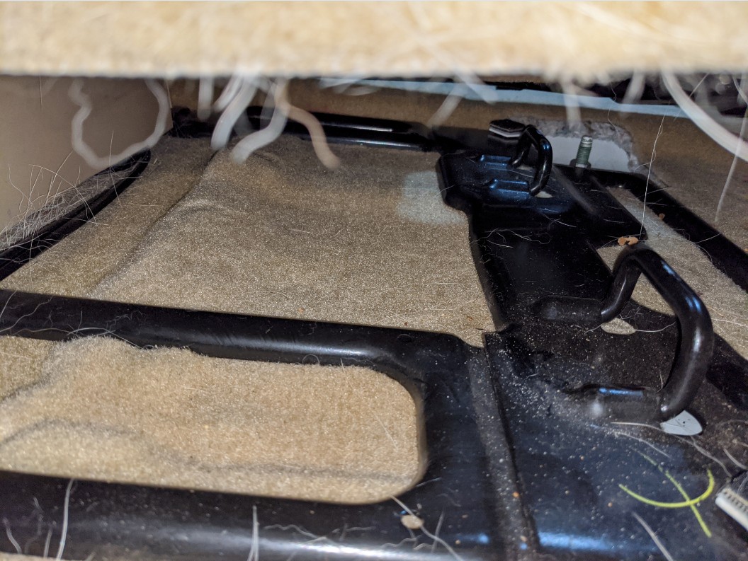

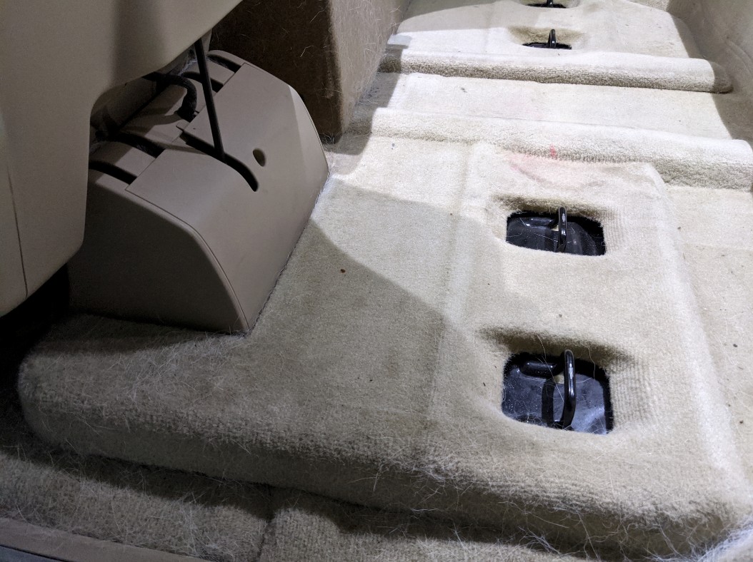

As @2010gmcyukon stated, you are missing some mounting/frame hardware that secures the seats to the floor. My 07 Yukon XL Denali has captains chairs in the second row, and I have uploaded some photos below that show this mounting/frame hardware for the second row captains chairs. Please excuse all of the dog hair accumulated by my two 90+ lb. white shepherds, who go with me, whenever I leave the property.
My recommendation is that you go to a salvage yard and obtain the frames and carpeted aesthetic covers (one for each captains chair) from another vehicle.
Other folks will chime in, as well.
