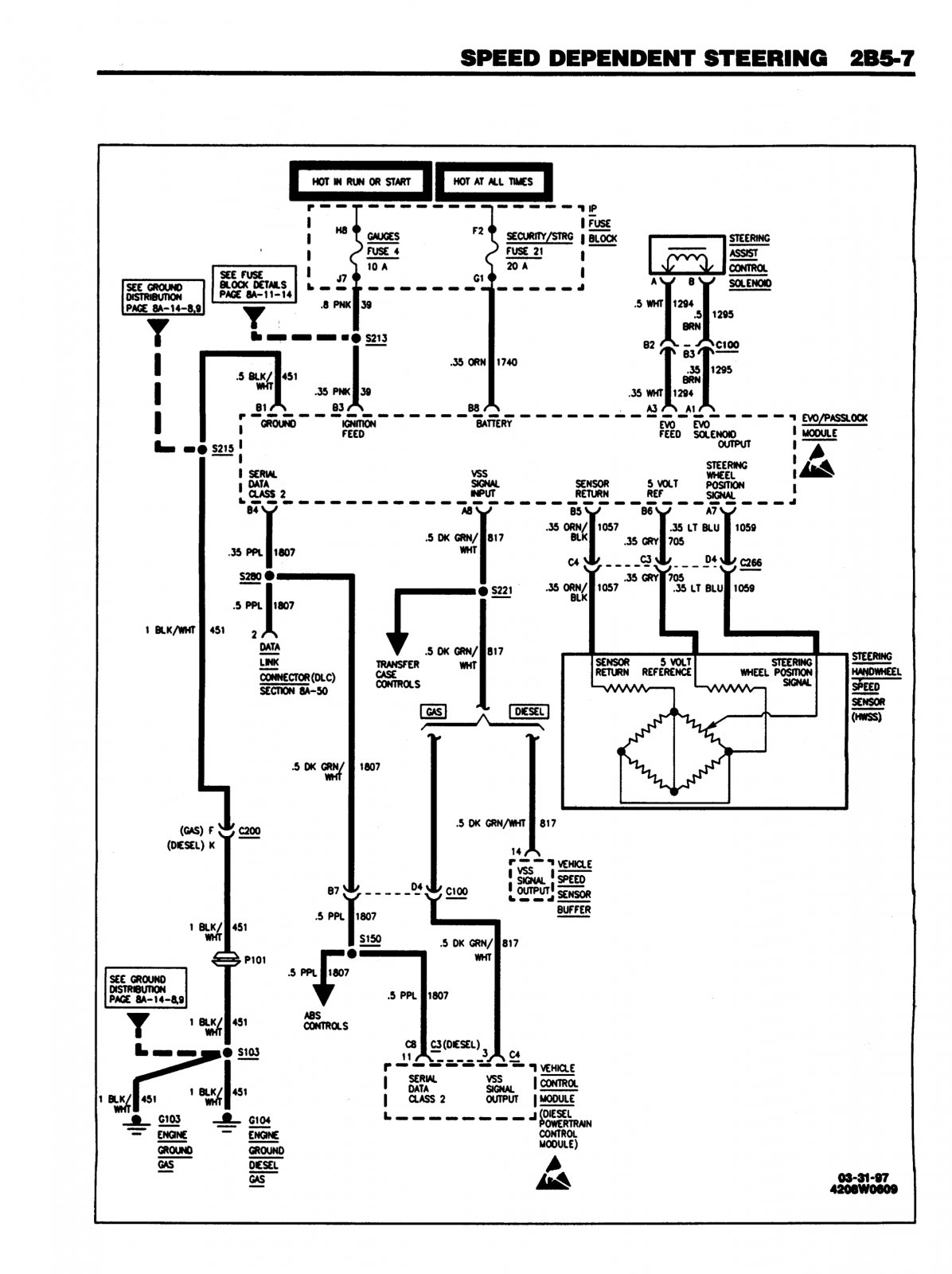

So, doing doing more testing. I noticed that on B6, there is supposed to be a 5 volt reference. Mine is showing almost 0 voltage. Can anyone tell me where this reference voltage comes from do I can track down why it is not showing up? Or is that generated from the passlock module itself? I looked in my manuals and found circuit 705, but it only shows to the steering column connector and could not find where it went from that point.

Is the EVO/Passlock module supposed to get the 5V reference from the Passlock sensor on 1836? It looks like it then uses that for the signal to the EVO sensor on 705.
For 1998, they show it in Volume 2 with the EVO/Passlock module.
