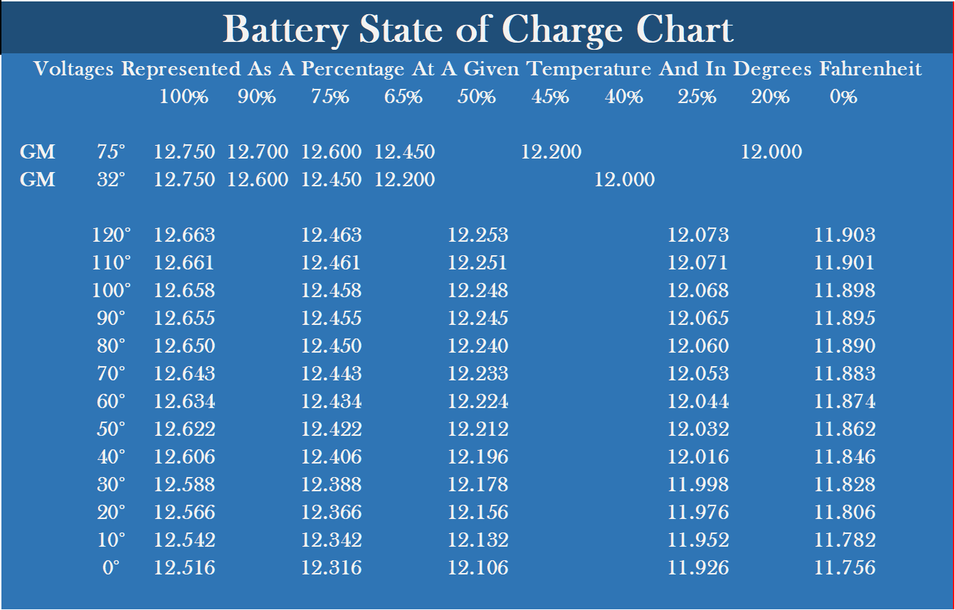

In the morning, before you start the truck, put a voltmeter on the battery and note its voltage. Compare that with the ambient temperature at the time and looking at a battery chart online you can determine its state of charge.
If you have a bi-directional scan tool like the Tech-2, you can see this inside the BCM under Charging Info and also test the output of the alternator and of course, pull up the internal codes related to this.
A battery with a state of charge of 64% or less after sitting 24 hrs is considered discharged and in need of replacement.

To be clear about the chart - let’s say it’s 56 in the morning - if the meter reads 12.224, it’s considered discharged?
Sorry for my ignorance - I have not seen a chart like this and want to be sure I understand how to read it.

So, battery seems on low side of charge based on the chart, but alternator is working…not sure where to go from here other than check all connections and wires.
