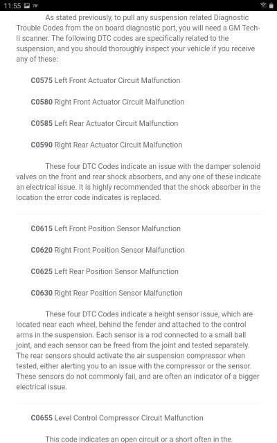

OK, so I got C0585, which is rear left actuator circuit malfunction code.
What exactly is that? I, so far, found a spread from bad strut(?) to bad compressor. Compressor starts as it should.
What am I looking at?
Thank you
How old are the shocks? If the electrical connector to the shock is on correctly the problem might be the shock and it needs to be replaced.
