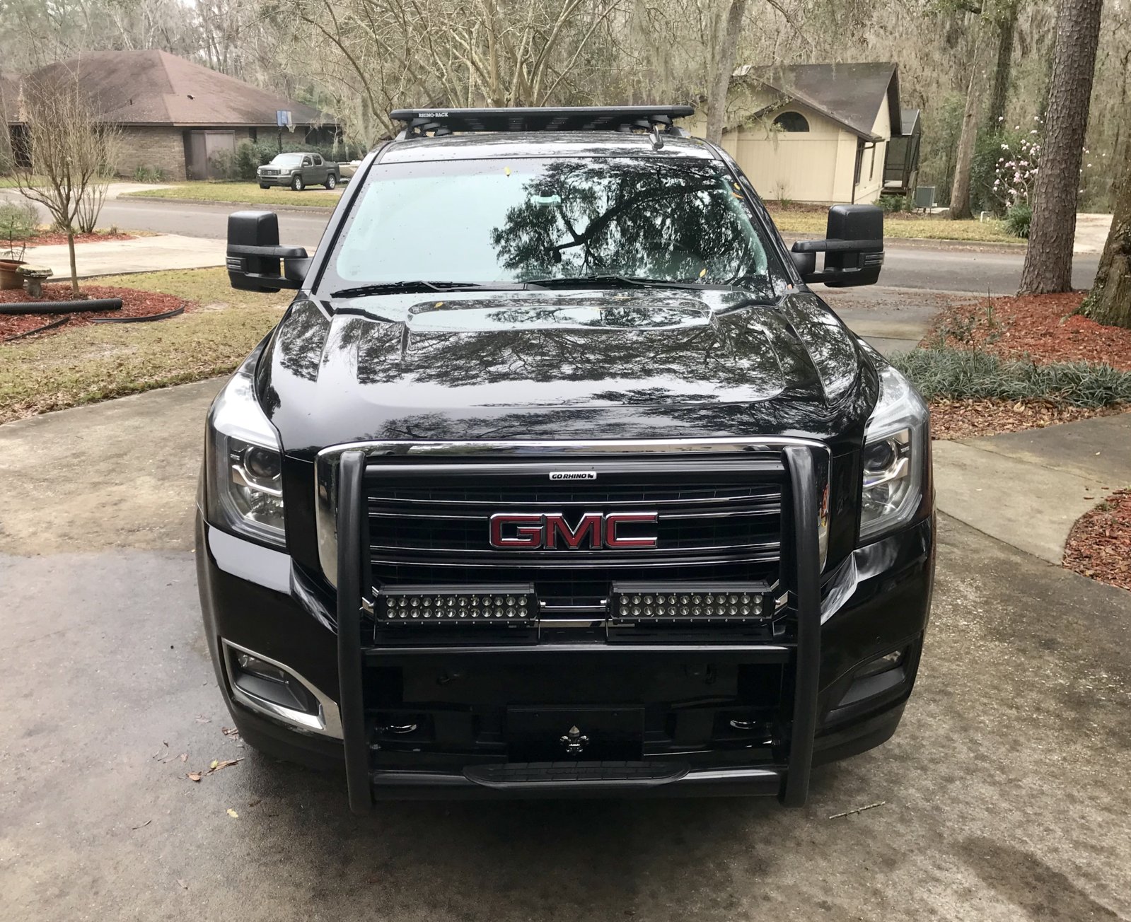

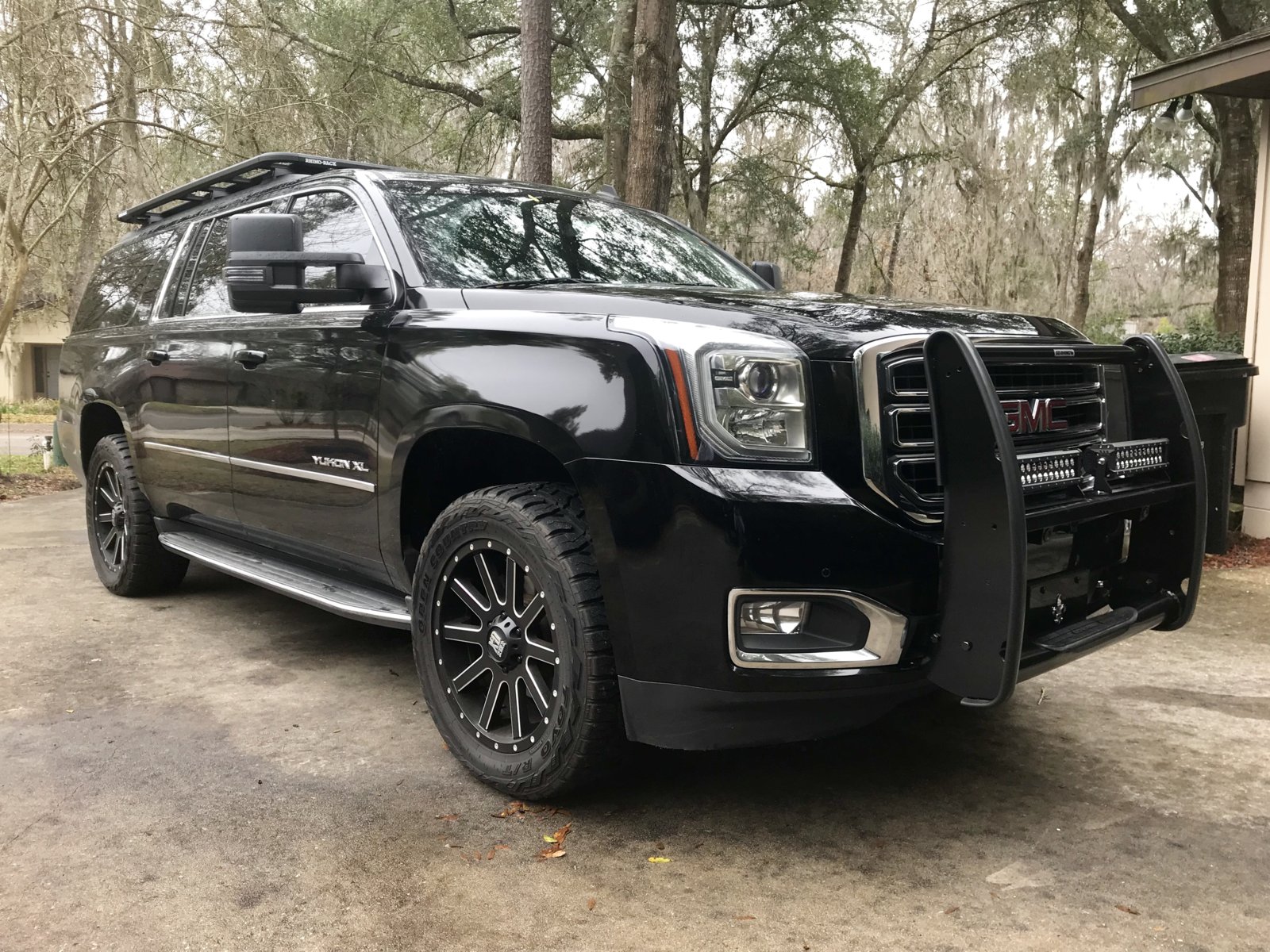

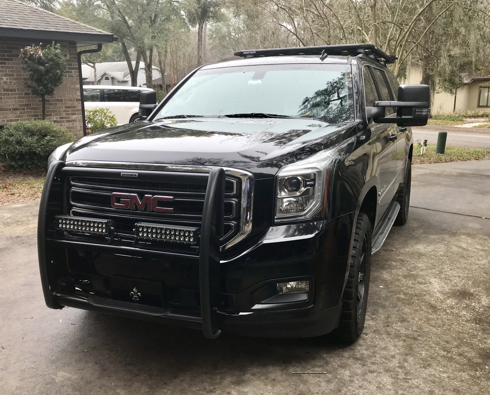

So I specifically told setina that it was a 2015 model and yet they sent me a 2007 model. The frame mount fit fine into the frame rails. However you have to cut out holes in the bumper for the the rails to slide through. The actual push bumper fits too close to the bumper so what I did is put the most forward screw from the rails on the most rear screw hole on the push bar. Then I drilled through the push bumper to mount the two other screws. I'll take pictures in a little bit to explain more.
TahoepPPVFan
Sep 25, 2016
So it took a month for delivery and a bit of modification but here it is. The lights for the push bar should be in soon. I'm putting two led off road lights, and some emergency ones up top and on the sides as well as two siren heads. I'm going to also relocate the front parking sensors onto the push bar. What do you guys think? bubu9yne.jpg
Nice job! Whelen Nano Pioneers would be a good choice for front scene lighting. Aren't you the one that parks in front of the Cos Cob Fire Station?
