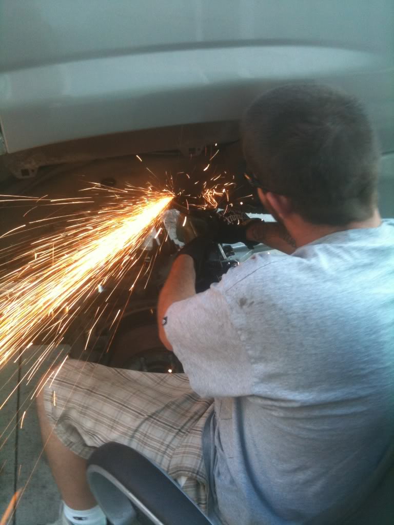

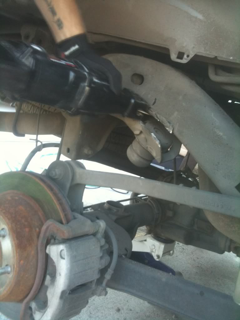

Yea I would deff cut the rear bumpstop bracket off completely all the way to the frame and grind it smooth so you do t have any sharp edges and then spray some rustoleum on there. And for the shocks get ahold of NorCalSS (Tony) and heres a link to his store http://tbssowners.com/store/
Here's a cpl pics of my truck with the bumpstops cutoff.
