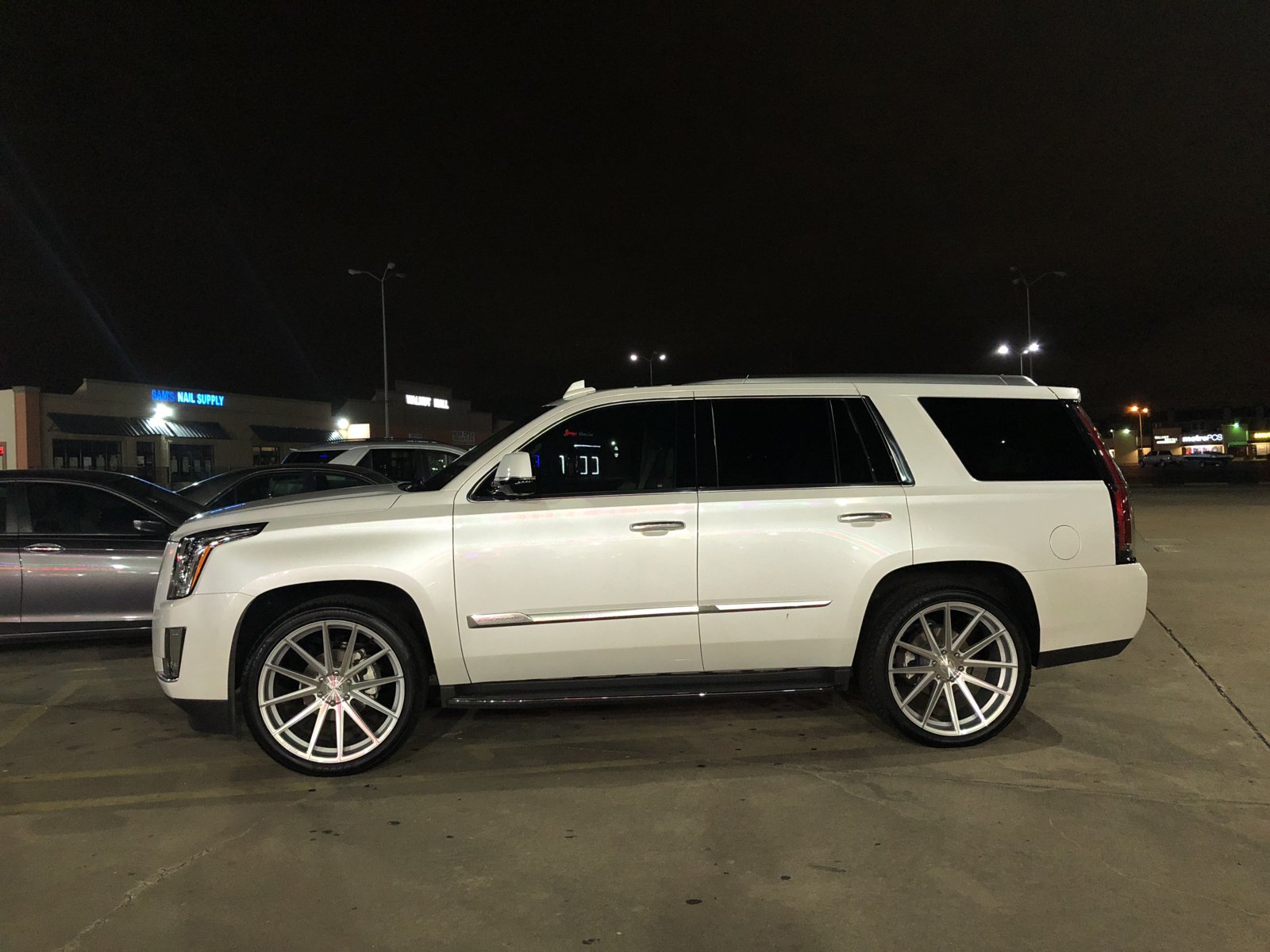

Need to drop this one a bit more. Had Callaway do the suspension on this one when i first picked it out. Now I am rolling on the Callaway Black Chrome wheels

^ looking good hundhaus
if you are running the BR black chrome rims, be mindful of potholes in road. the metal seems overly soft.
i am on my 2nd set & maybe a 3rd set in near future. :\

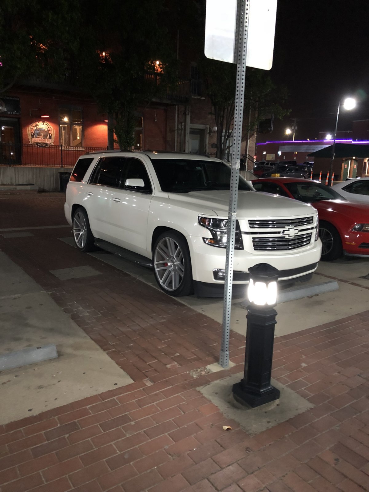

2017 LT 2wd running 3" DJM UCA/LCA combo & Tony's Belltech 3.5/4.5 rear. This pic has Thick Isolator installed AND a 1" spacer on axle. Currently, the Thick Isolator is pulled, heater hose installed on upper end & 1" spacer on axle. I know it's a crazy combo in rear but I was trying some different things & that's where it landed - slightly lower in rear than this pic. I had to add the 1" spacer cuz my wife thot the spring only made the rear sit too low.
