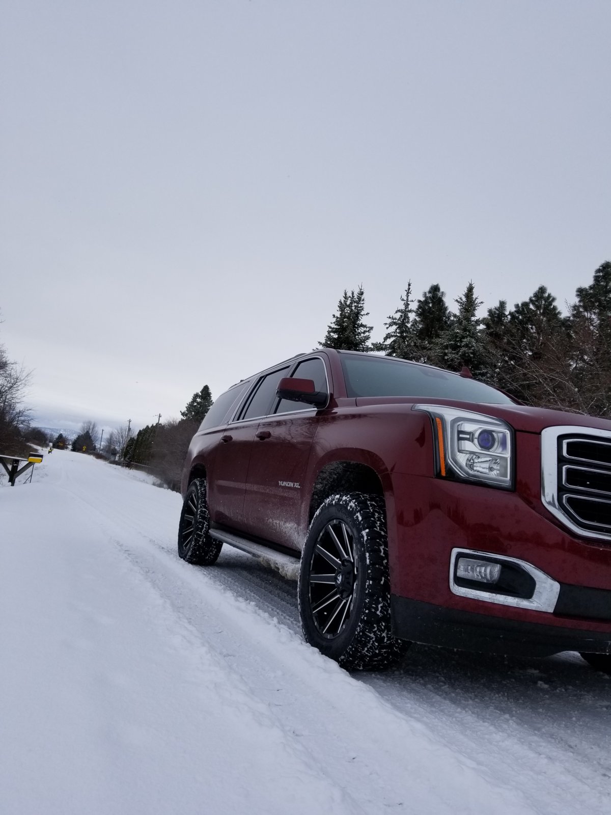

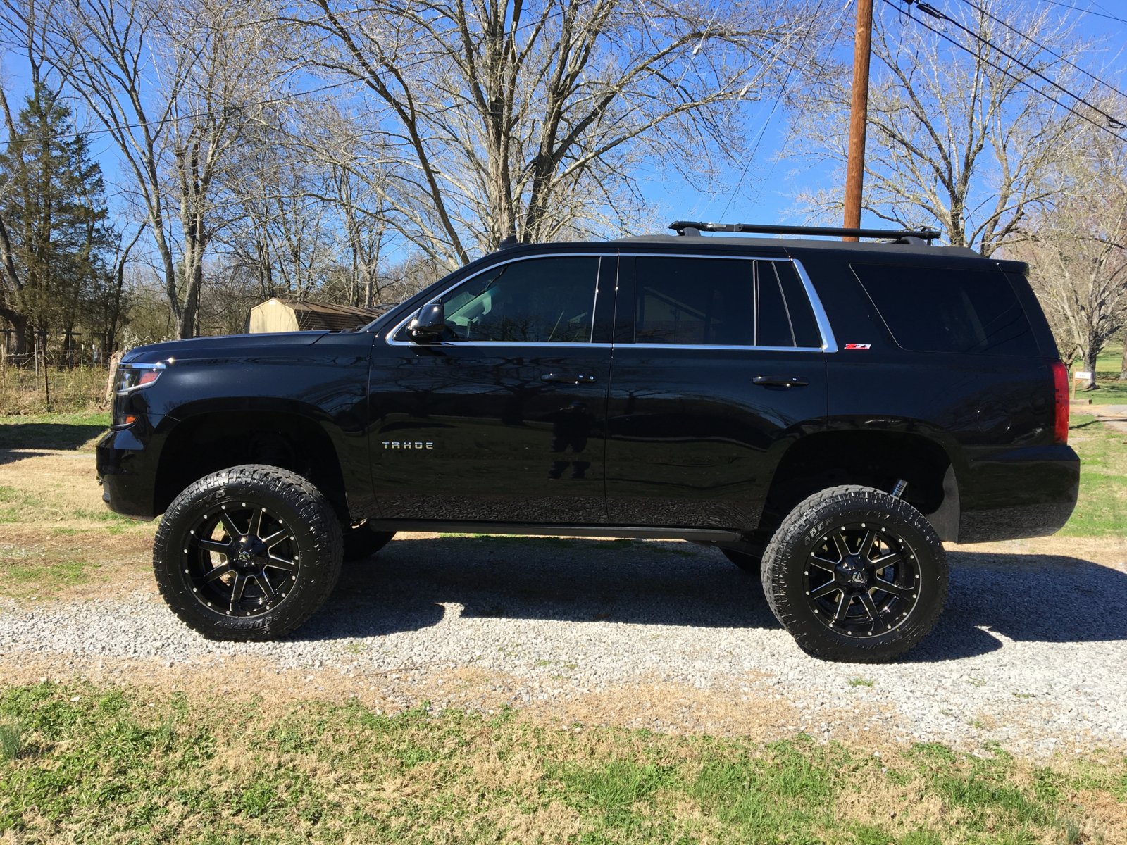

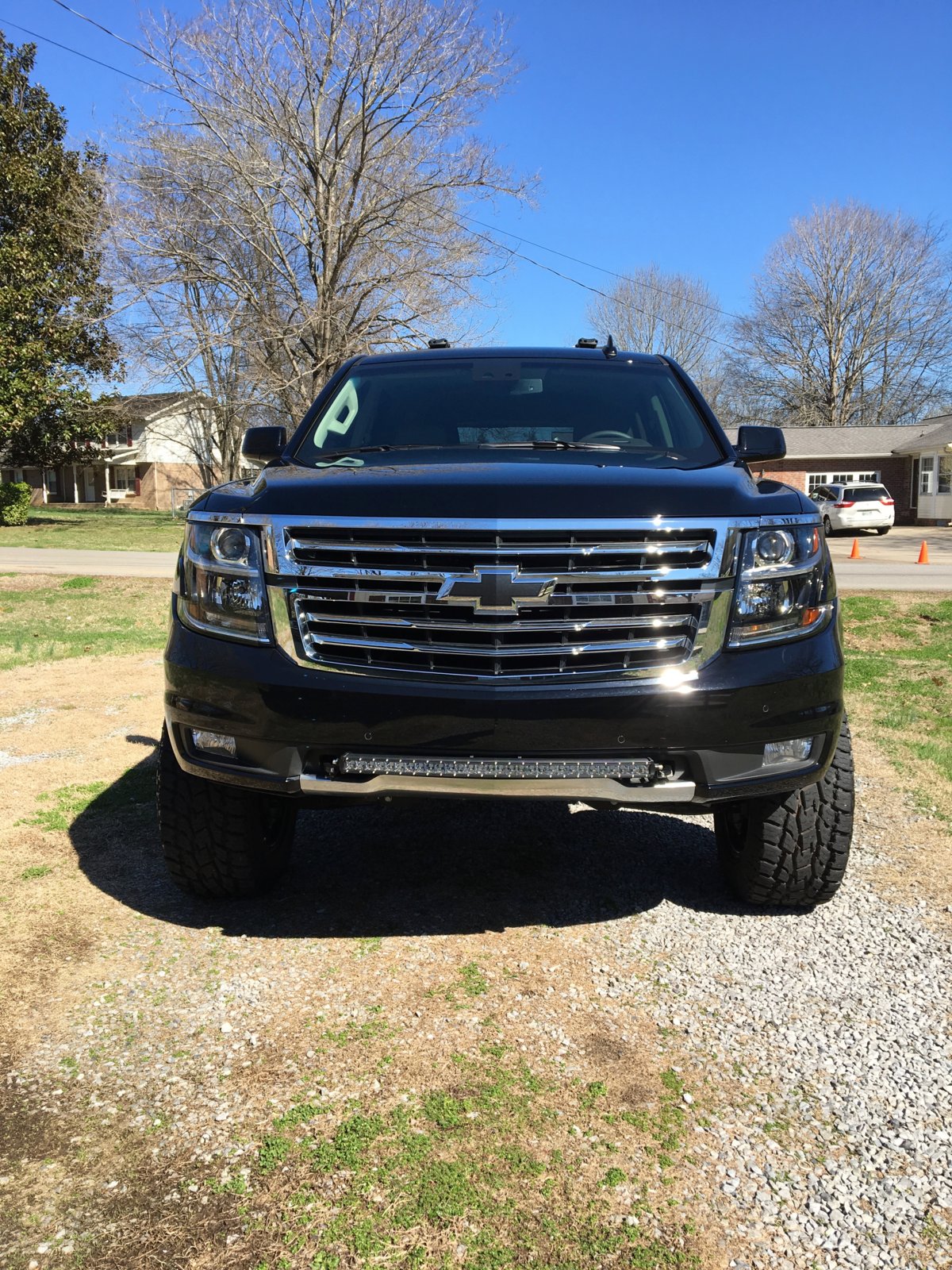

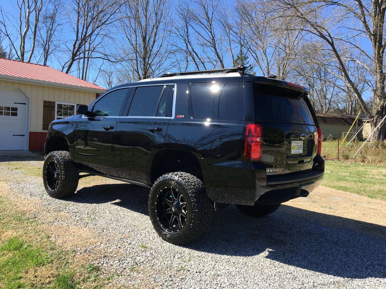

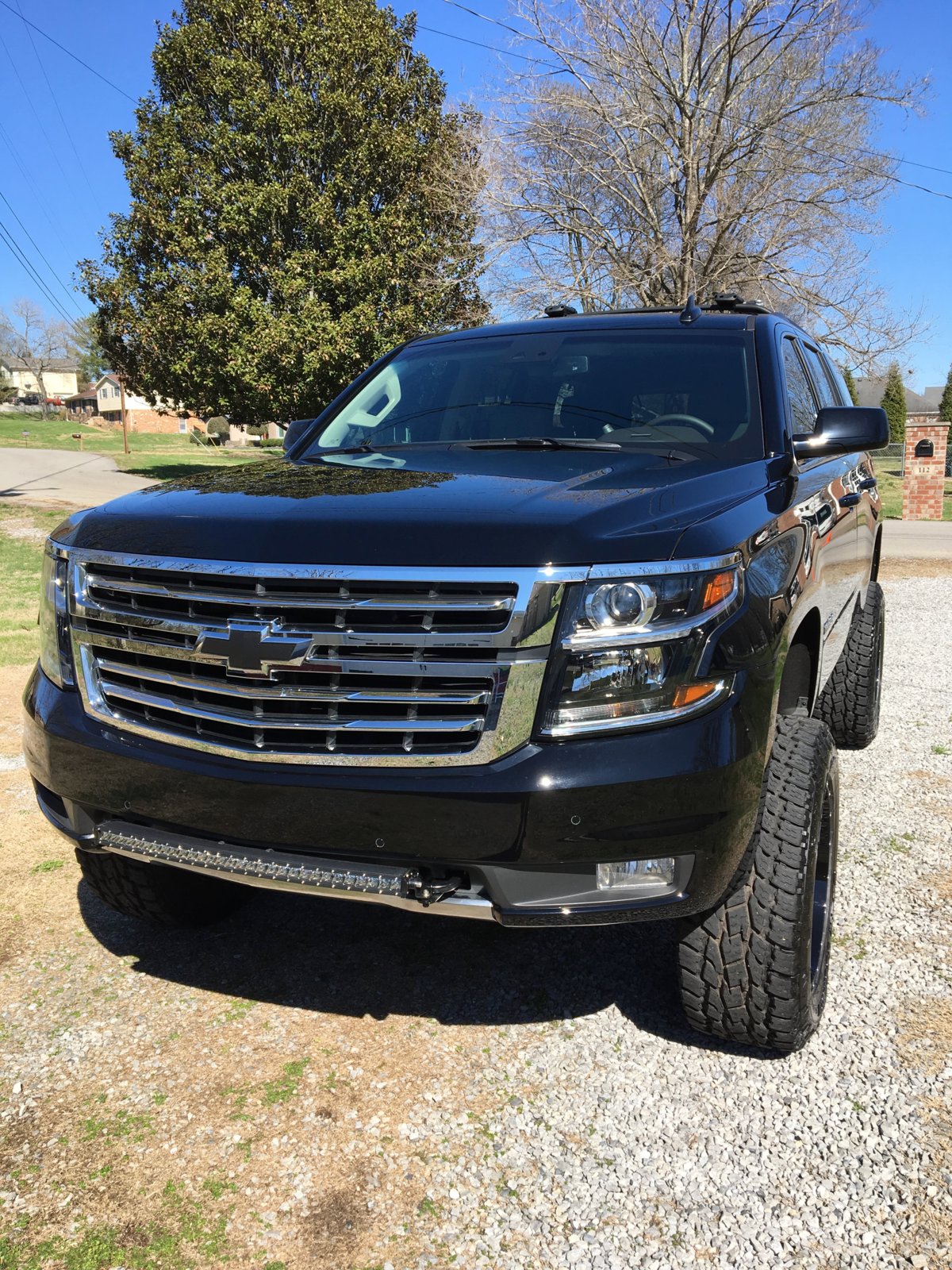

I couldn't find any info about 33x12.5" tires fitting. I mounted these 33x12.5x22 ridge grapplers today on replica 22x9 wheels 6.25" backspacing. The tires gave me about 1" of lift. I am running a 2.5" suspensionMaxx front and 1" rear spacer. I can make it rub at a full turn with body roll, it only rubs on the cloth wheel tub a little bit. Easy fix to just heat and push over or just pull it over with a ziptie as many others do.
Looks good! Now trim the front air dam.

Thanks. I was considering removal but access to the screws didn't look easy. Have to check more into it. May end up trimming it back instead. Also found that the sidewall barely rubs the swaybar at full lock. 6" or less backspace would be better.

Look into installing a PPV front deflector that is about 1/4 of the size of the stock piece.
I did it to mine, many other people did too by now, and others have cut the stock piece
