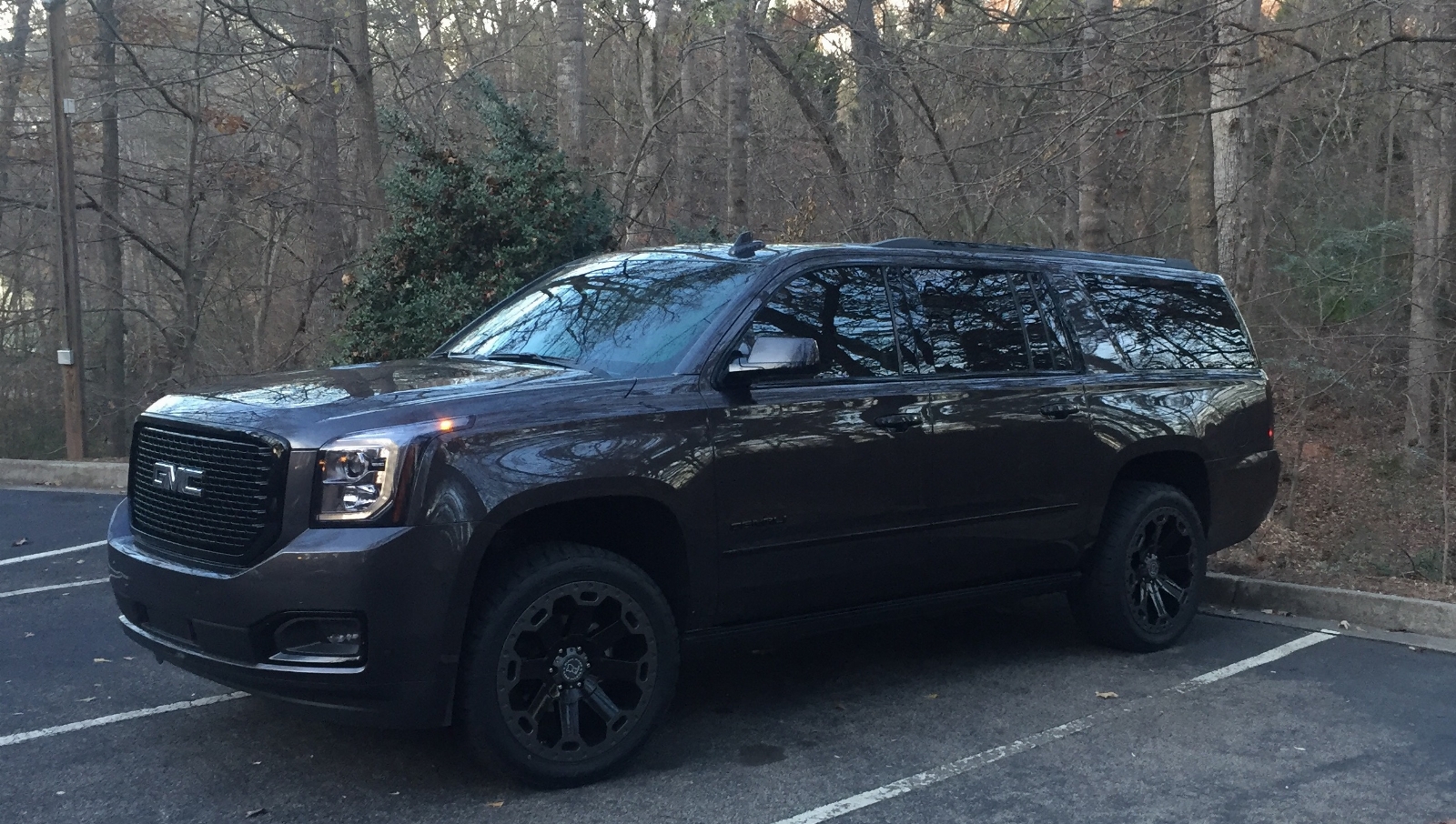

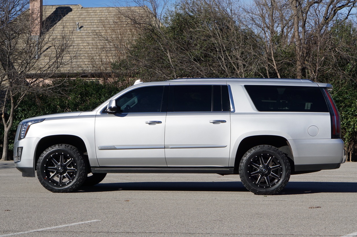

My '16 Denali XL with Fabtech 4" kit, 20x10 Fuel Tritons and 33x12.5 Fuel Gripper M/T's.

There is some cutting, well more like trimming, mostly to provide clearance for the front diff to drop down. The truck rides like it did stock. Fabtechs way of adjusting the magneride sensors up front is not adequate, but fabbing a bracket up fixes that and re-centers the sensor. I also think they should reduce the rear lift height by 1". With kit installed there is 2" of rake still, not a leveled stance.
