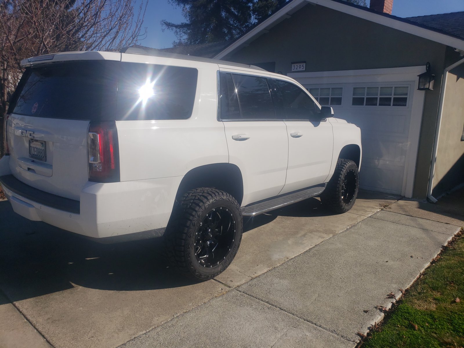

Just finished this weekend.
3.5" front spacer with cognito upper control arms/kryptonite tie rods/Movotech lower TTX with Blistien 4600 shocks/struts F + R and +3" rear spacer/extended sway bar links (sits actually pretty level) and angle are good (no CVS)
Rims are 20x10 ultra hunter with 4.5 backspacing and 33x12.50r20 tires.
Slight rub on full lock/driveway (bump) but normal driving no rubbing. Drives really nice and solid feeling.
