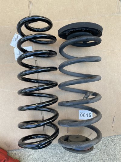

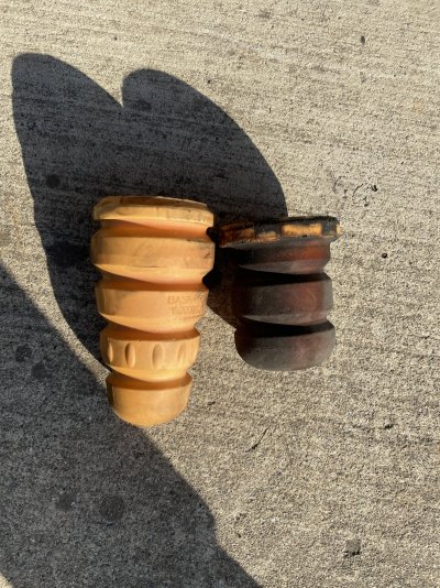

308er
Dec 7, 2021
Before and after. Installing rear springs today. So I’ll post the final pics later.
Hoping for around 2 inches lift all around.
Ads 2.5 coilovers front and 2.5 remote reservoir rears. Lift springs and z71 bumps out back.
RC uca.
