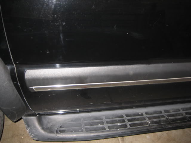

IS there anything special i need to know about removing the side molding on my 2005 Yukon? Is the paint going to be alot brighter in the area where the molding was. Should i just take a heat gun to it? Would that help

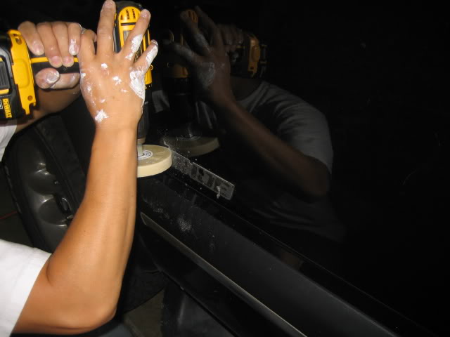

Takng a heat gun to it would help, all that does is it makes the adhesize/moldings come off easier.
Once you got them off, you can get some adhesize remover and go at it manually. Or I would highly recommend that you get a 3m adhesize removal wheel. Basically a big rubber eraser that you attach to a drill. That makes the removal extremely fast.
That should be it. Oh yeah, my paint was the same shade, it wasn't darker or anything like that.

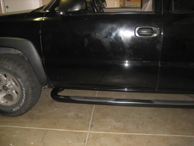

Don't forget to give the areas a nice wash, polish, & wax when you are done. That way it'll look like the moldings were never there. This is how mine turned out with the Yukon XL's obnoxious huge chrome moldings:

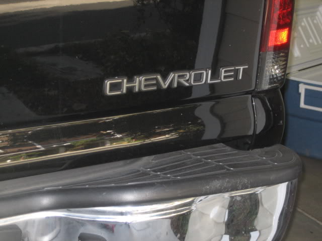

I did this a few months ago to my 02 Yukon XL. Hairdryer, strong fishing string, and bug & tar. Worked great and too me, looks so much better. Wasn't planning on debadging but after i got through with the molding, kept on going.
