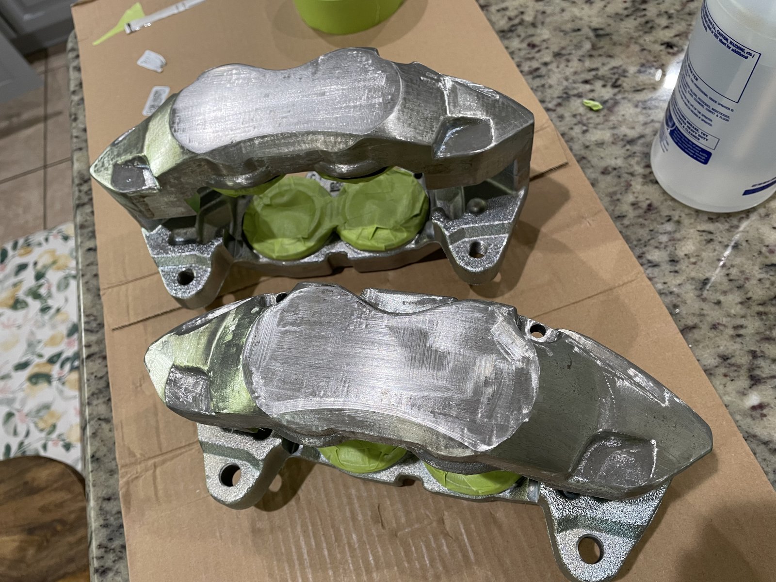

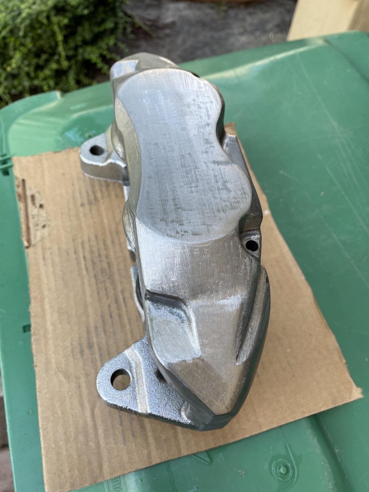

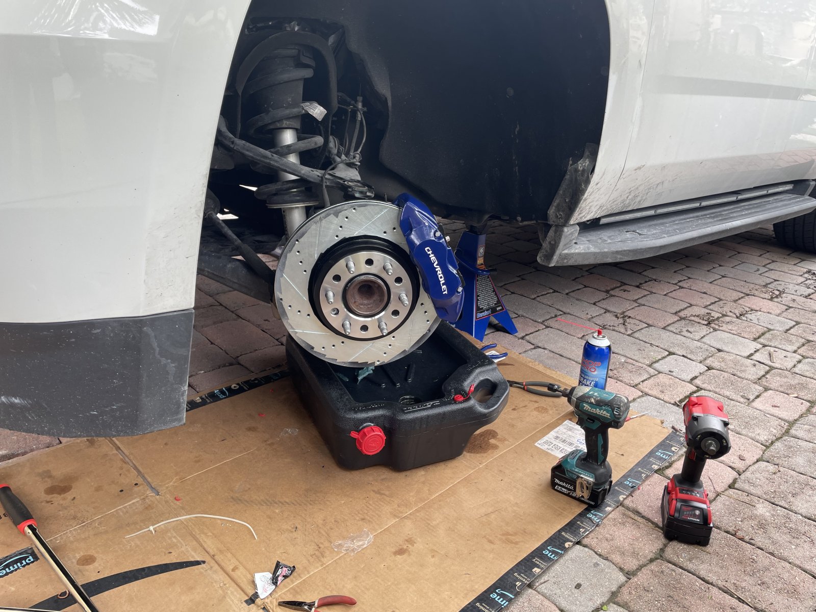

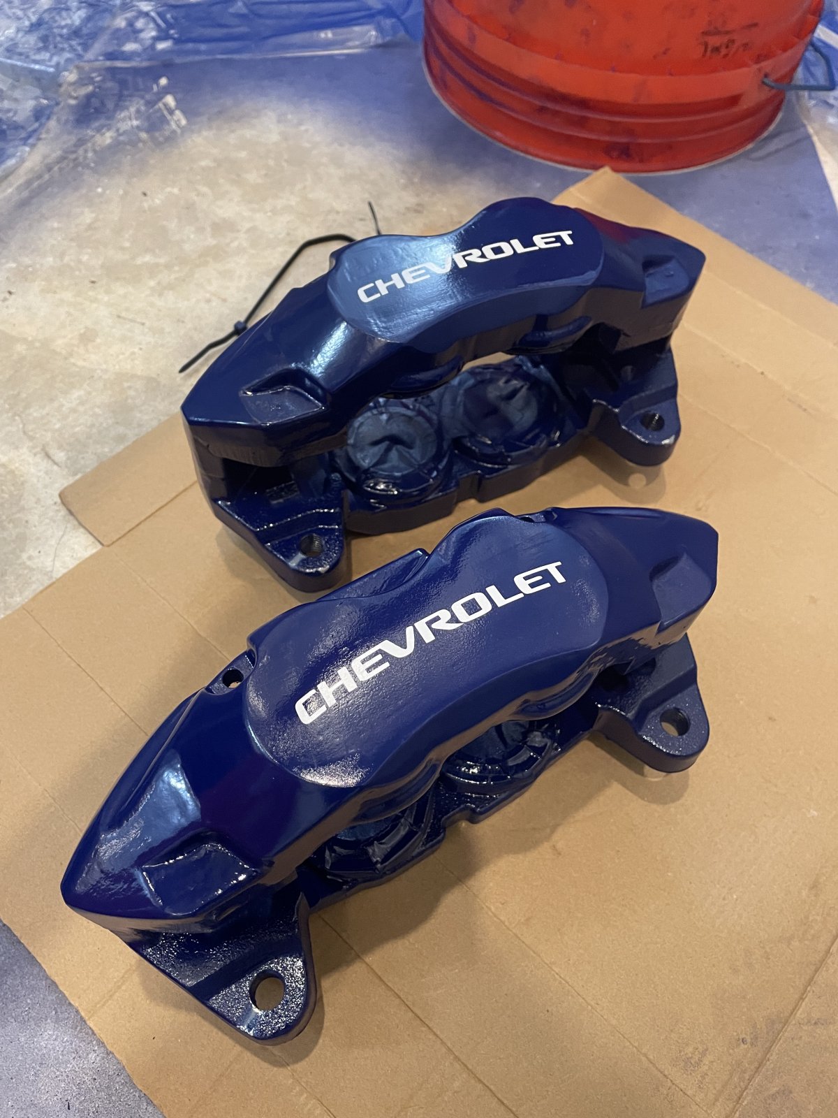

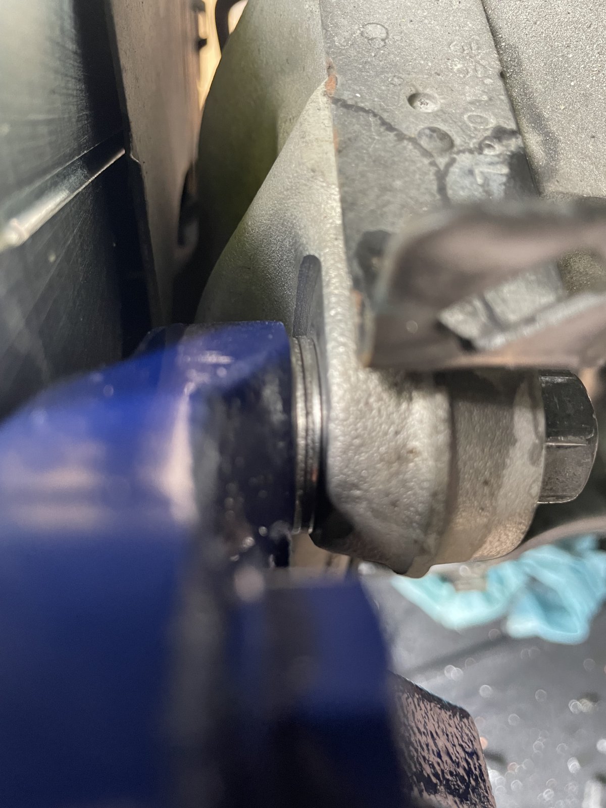

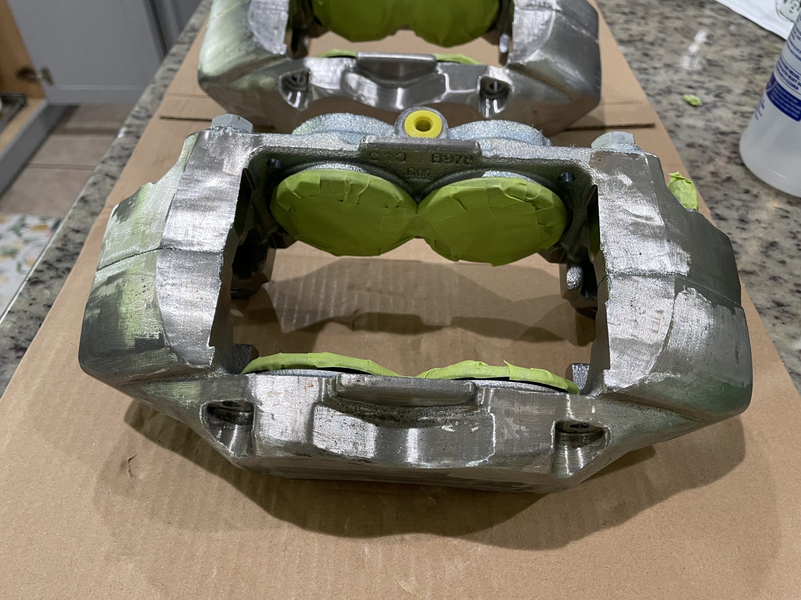

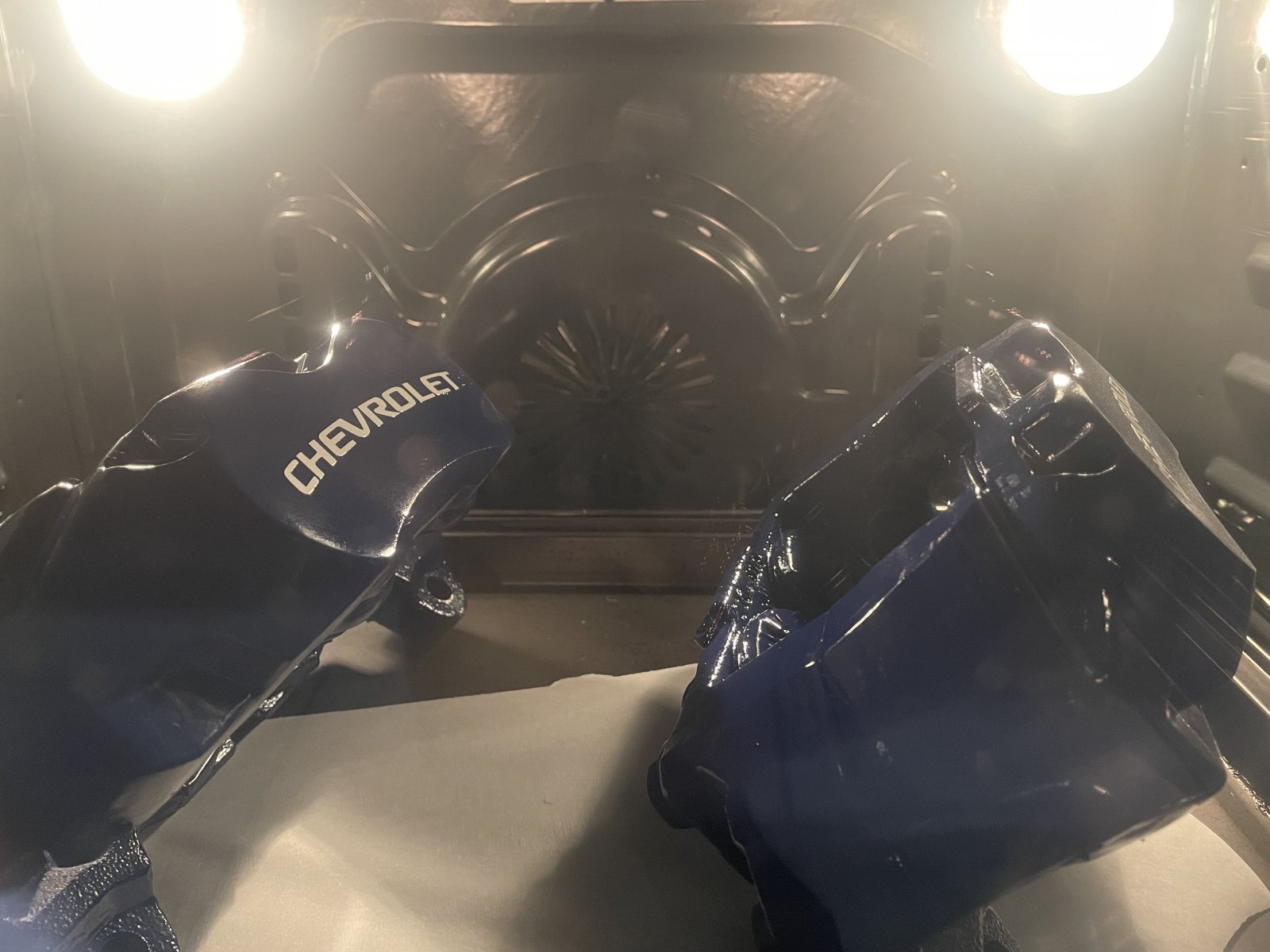

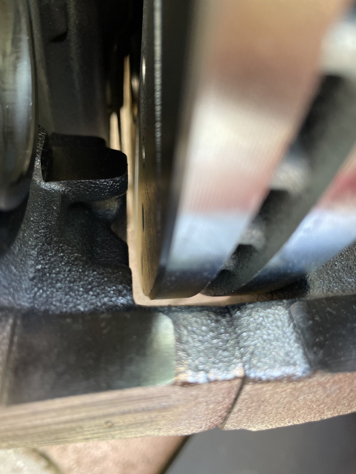

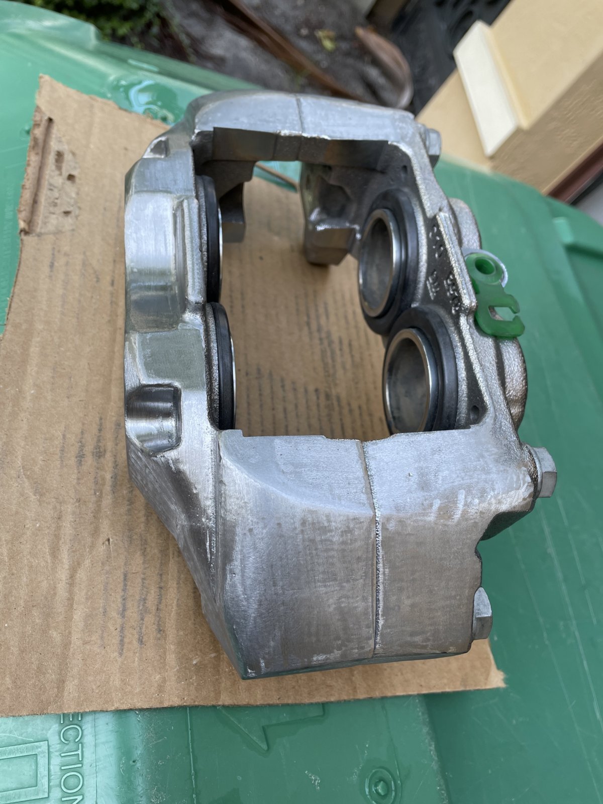

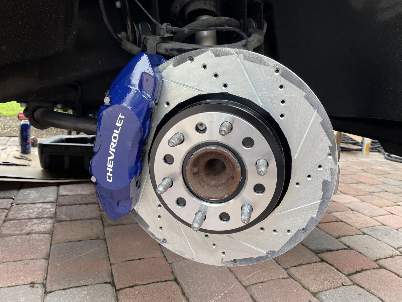

I noticed there's not many or any of these caliper swaps for the 15'-20' models so I'll post up all the info from my upgrade.

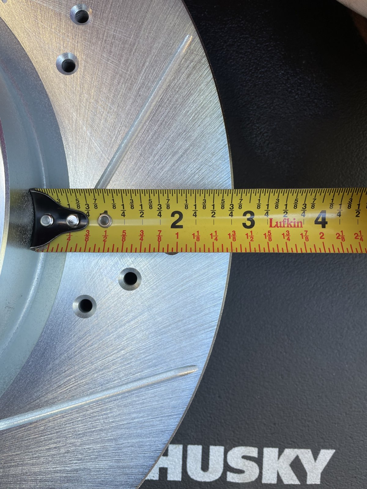

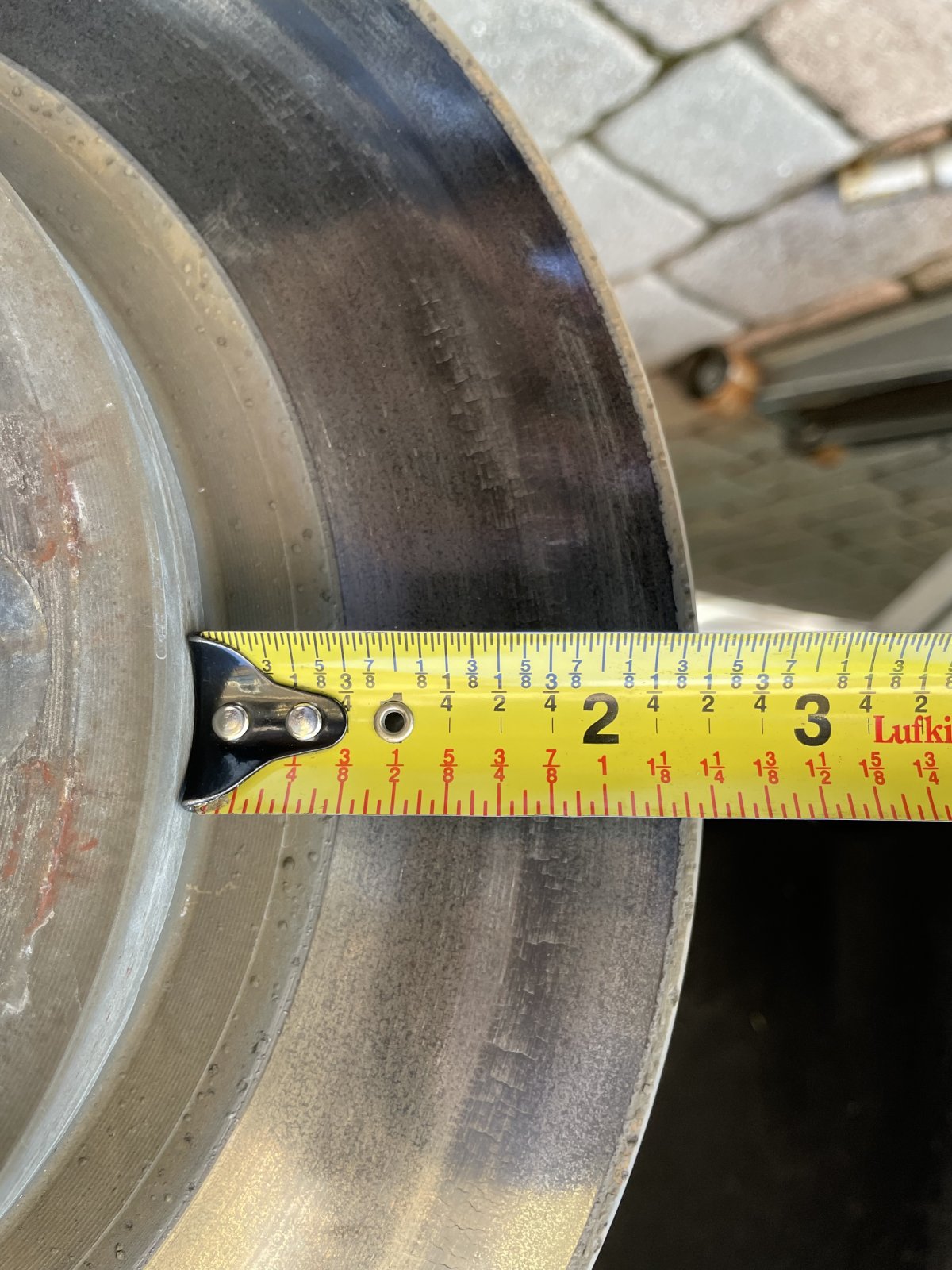

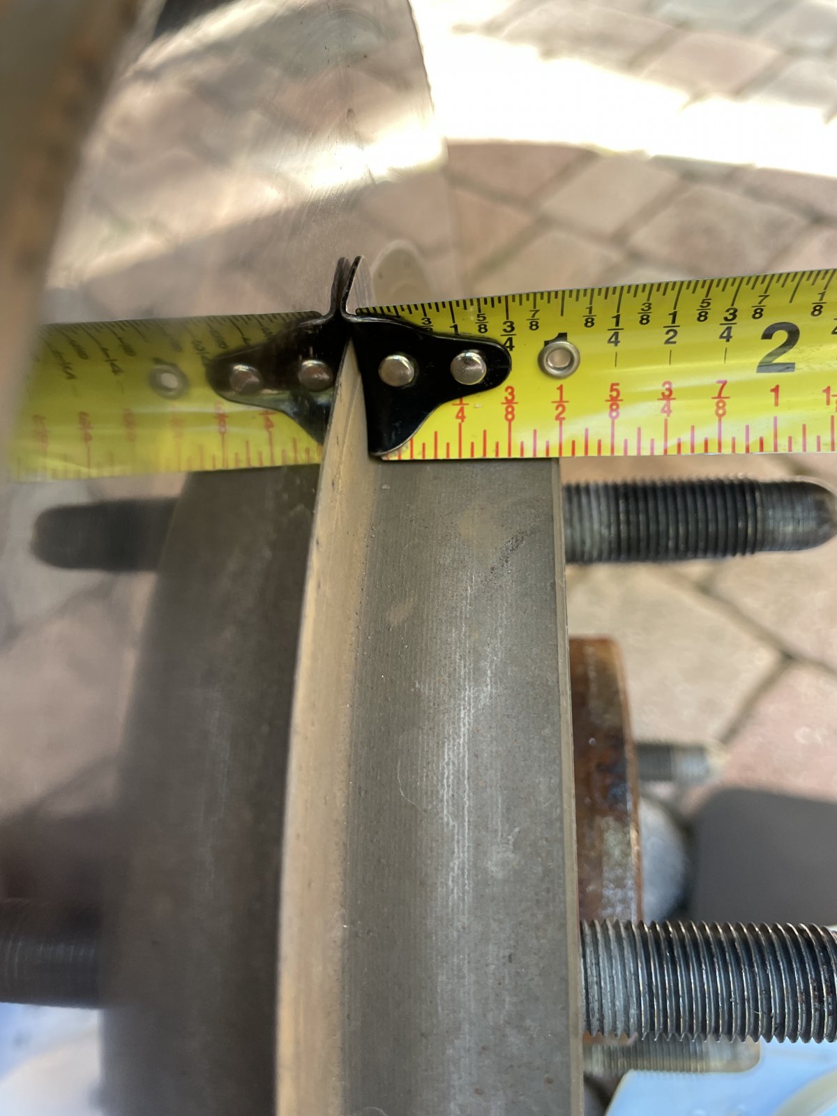

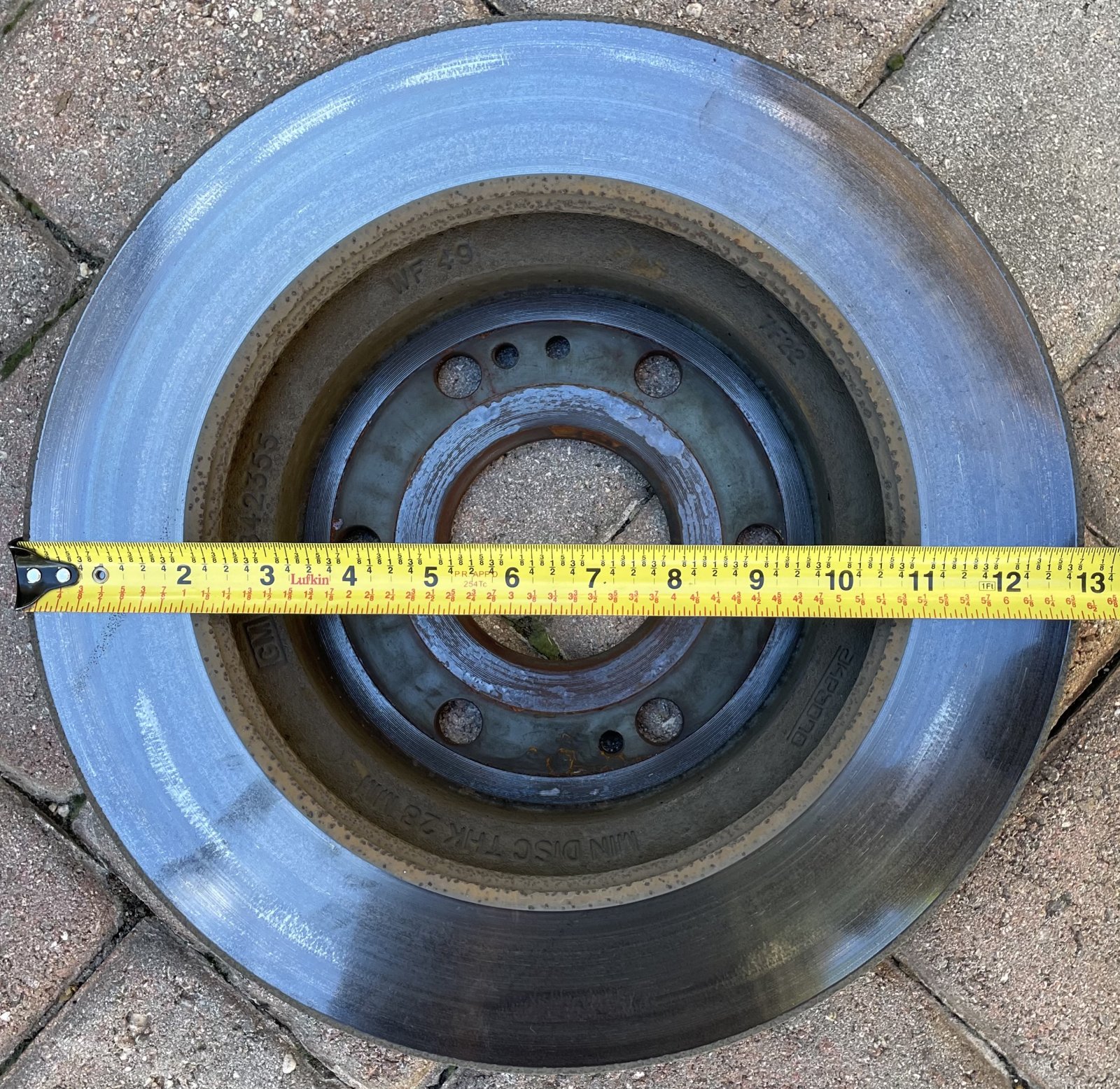

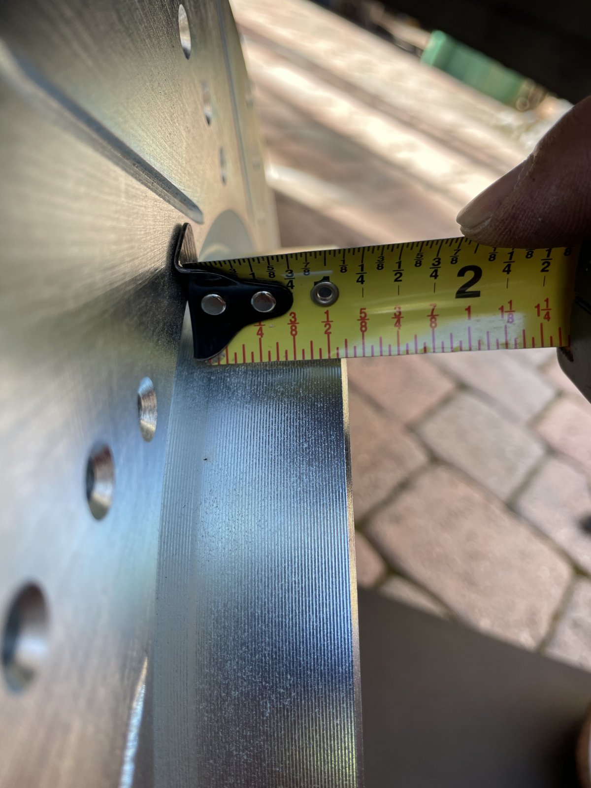

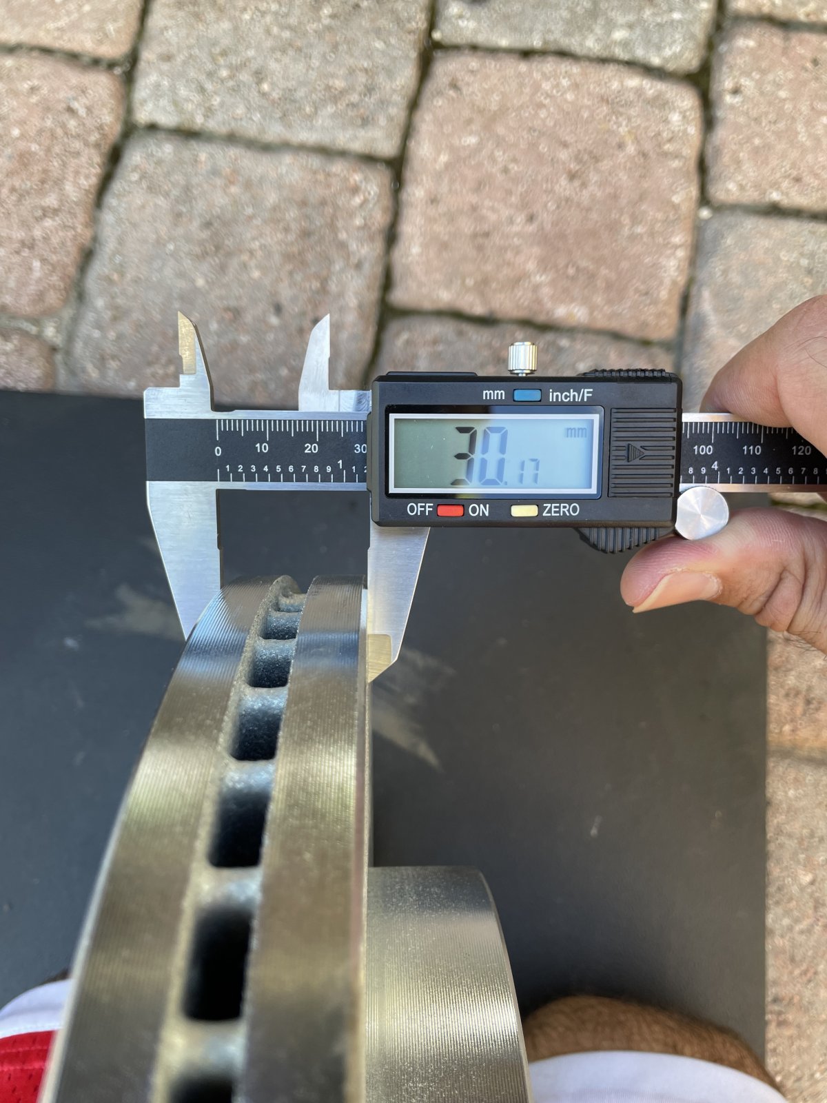

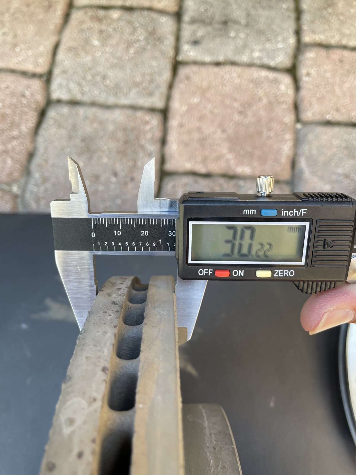

OEM Rotor specs:
Diam: 12.99”
Thick: 1.181” / 30mm

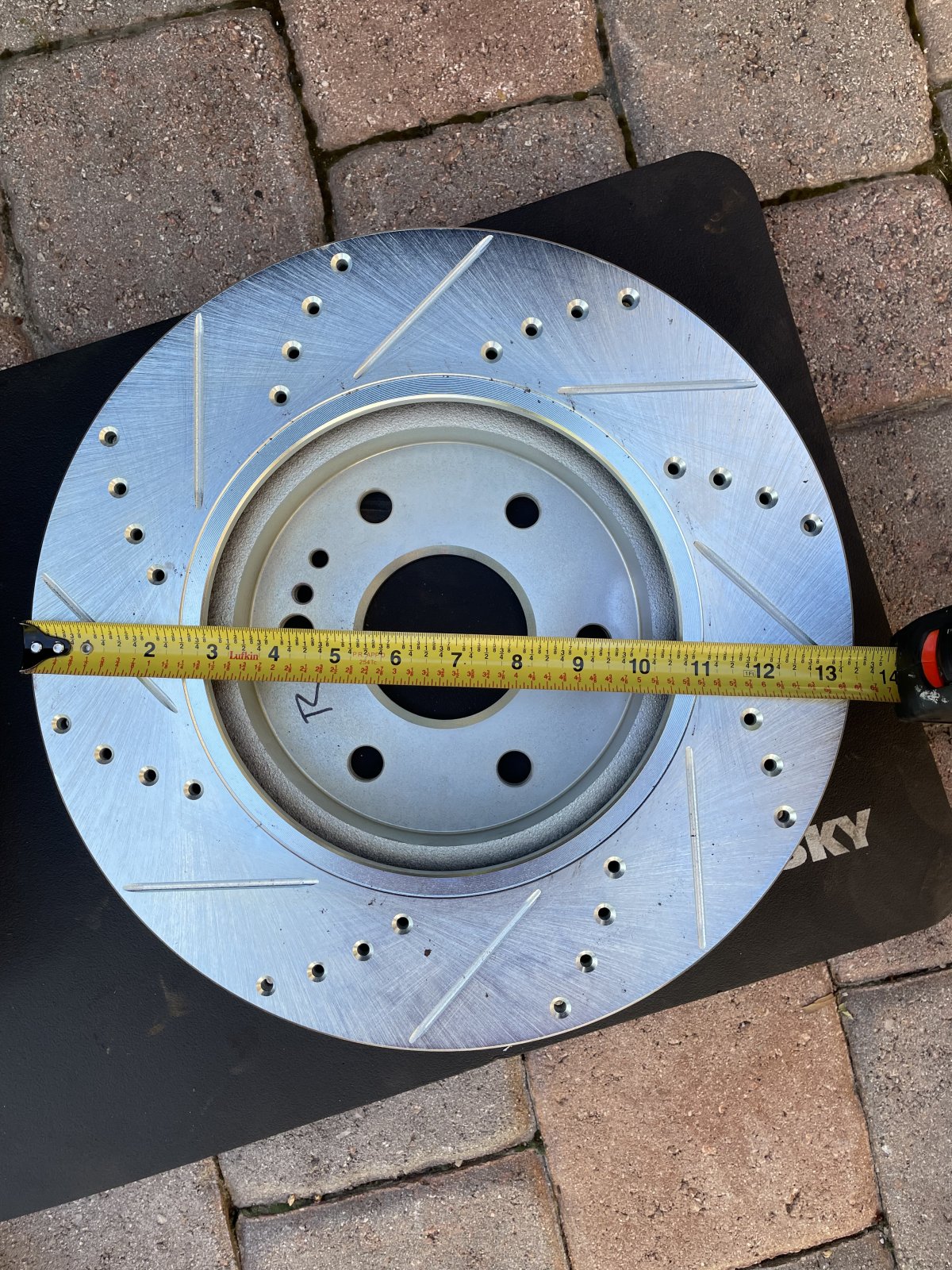

Silverado specs:
Diam: 13.58”
Thick: 0.790” / 20.06mm

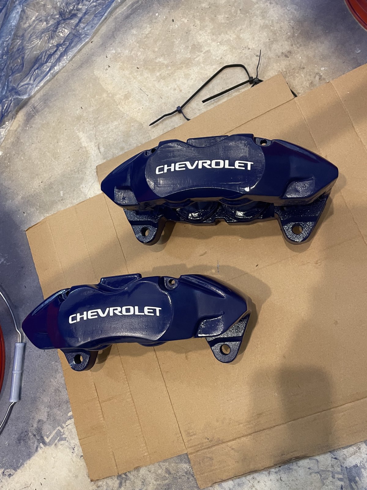

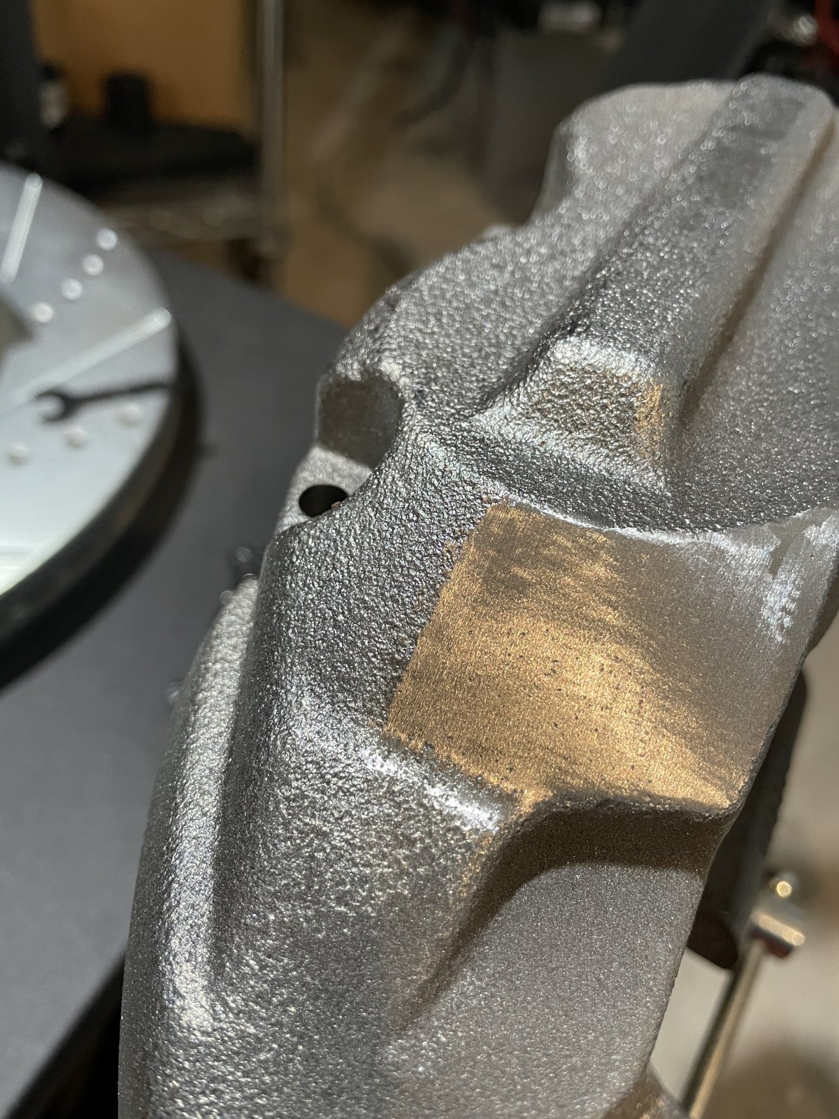

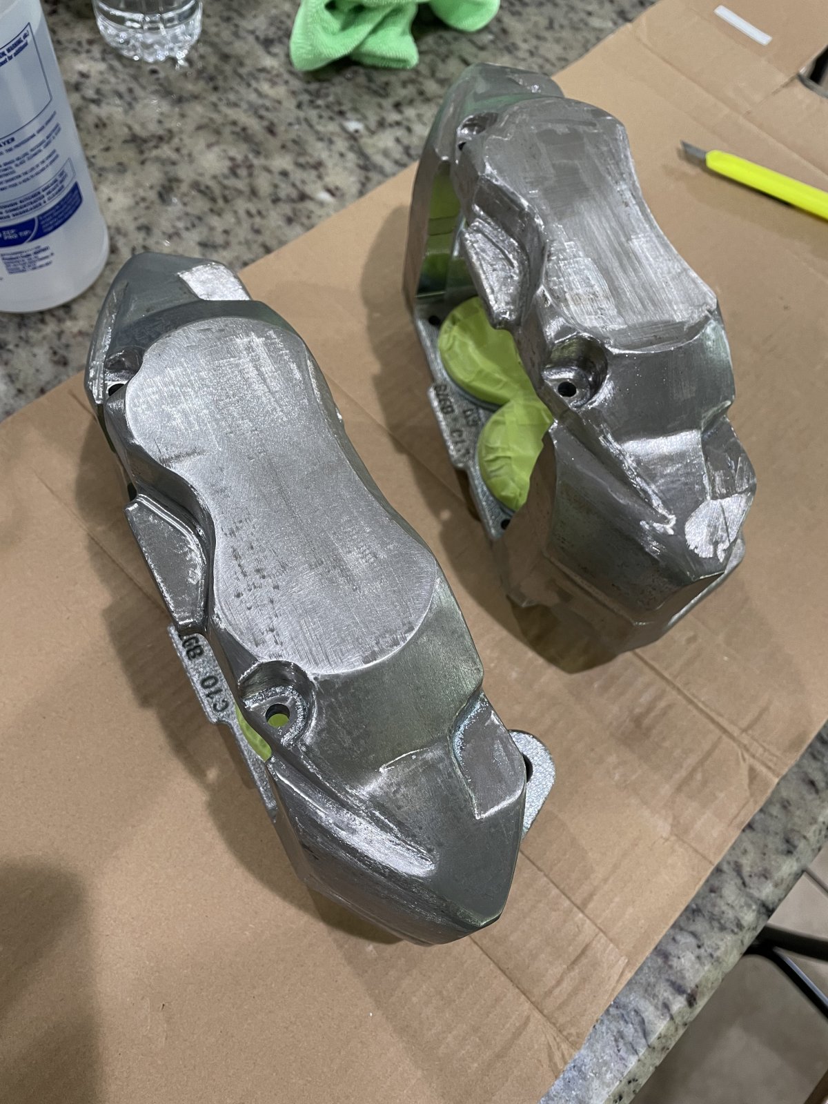

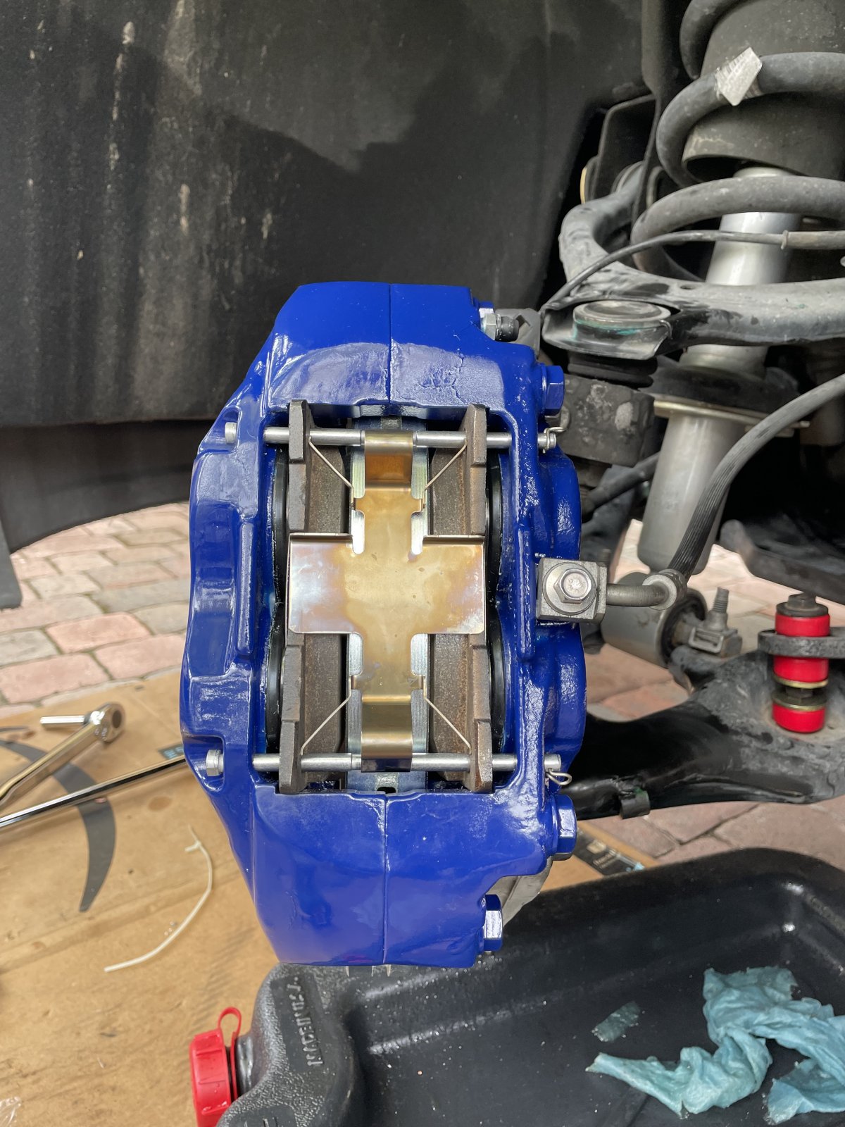

Calipers:
GM# 13545382 DRIVER
GM# 13545383 PASS

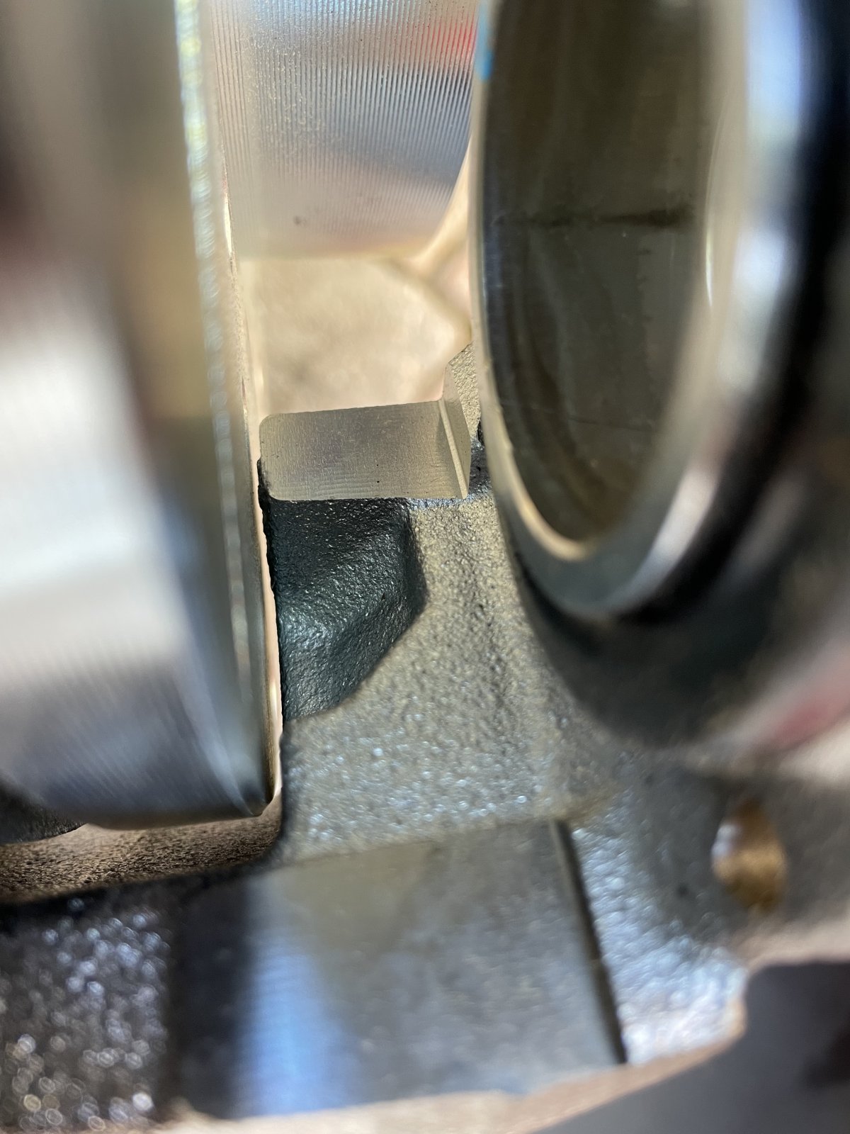

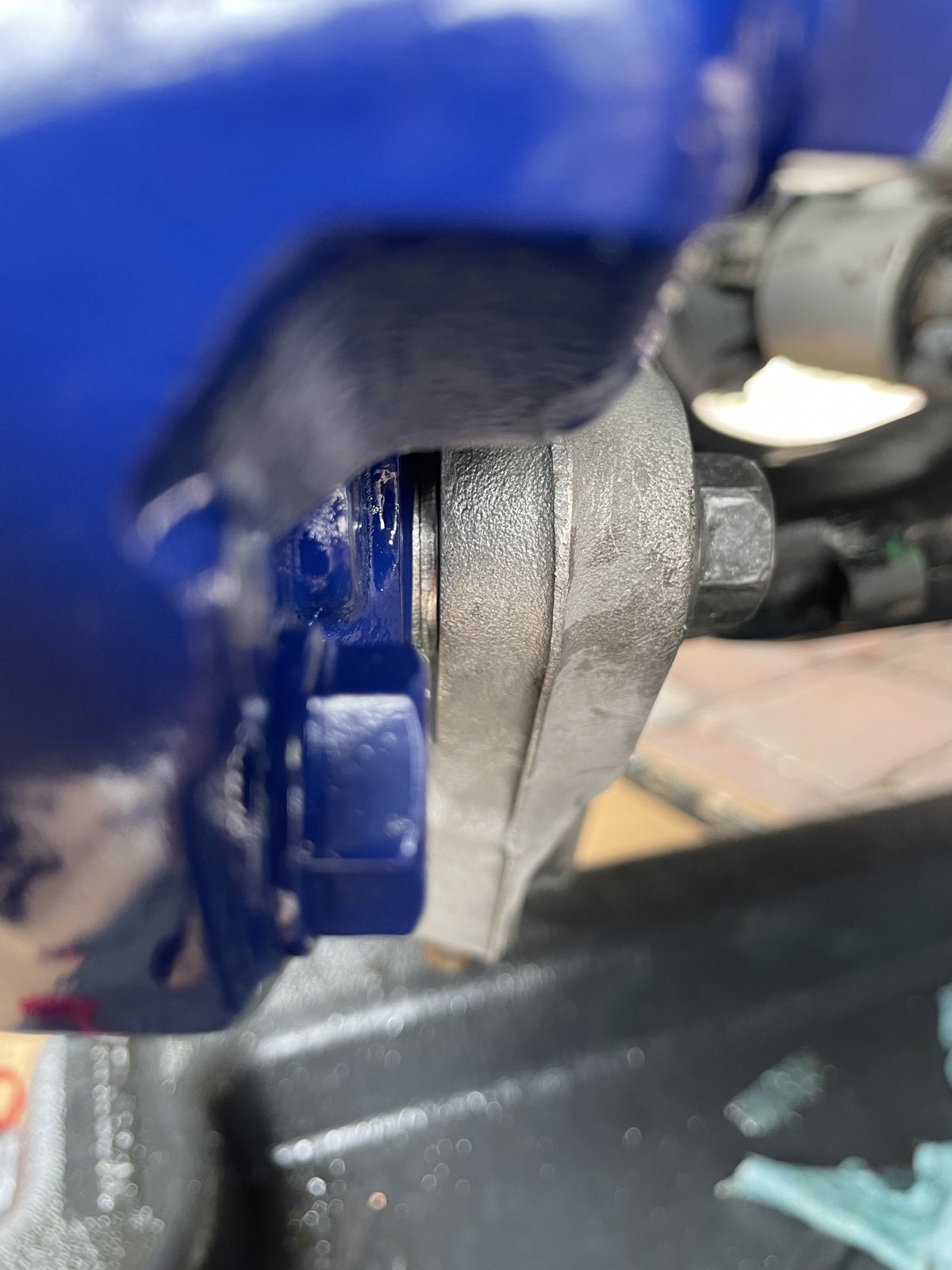

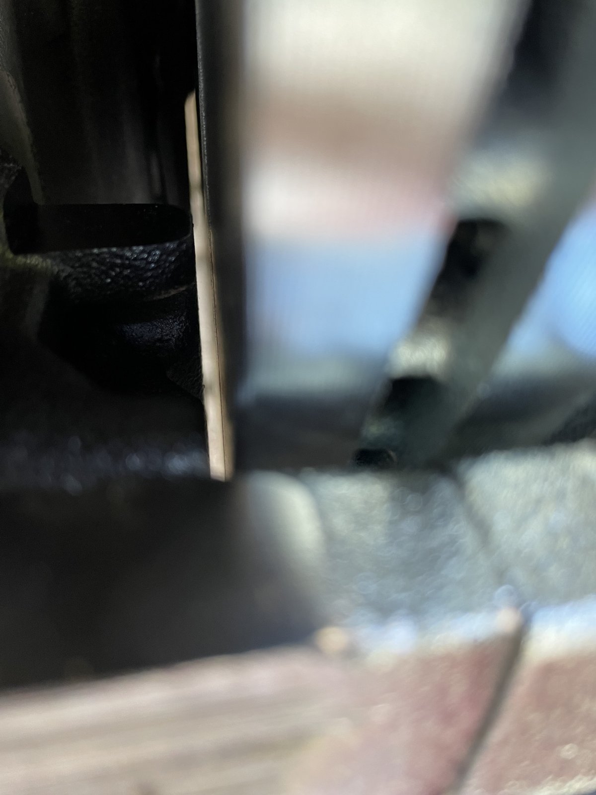

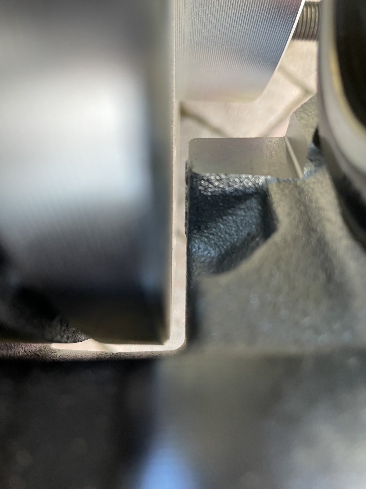

8 1/8” thick washers/spacer so the caliper can center with the rotor.
Banjo bolt:
GM# 11569589 30/ftlbs
Caliper bolts:
GM# 15016308

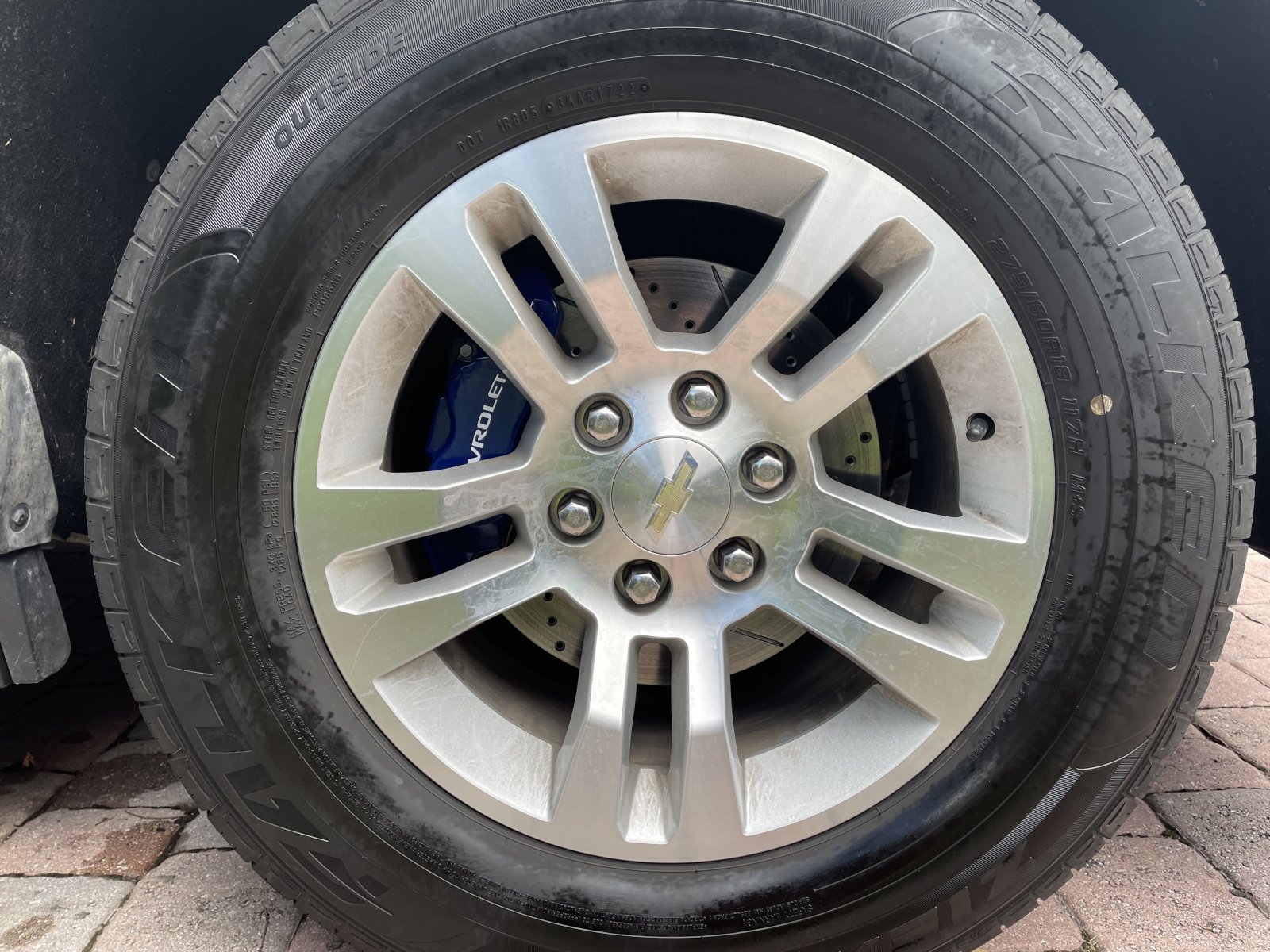

OEM 18" Wheels
1/4" spacers for the Calipers to clear the wheels
Rotors:
OEM Rotor specs:
Diam: 12.99”
Silverado specs:
Diam: 13.58”
Calipers:
GM# 13545382 DRIVER
GM# 13545383 PASS
Banjo bolt:
Caliper bolts:
GM# 15016308
OEM 18" Wheels
Rotors:
