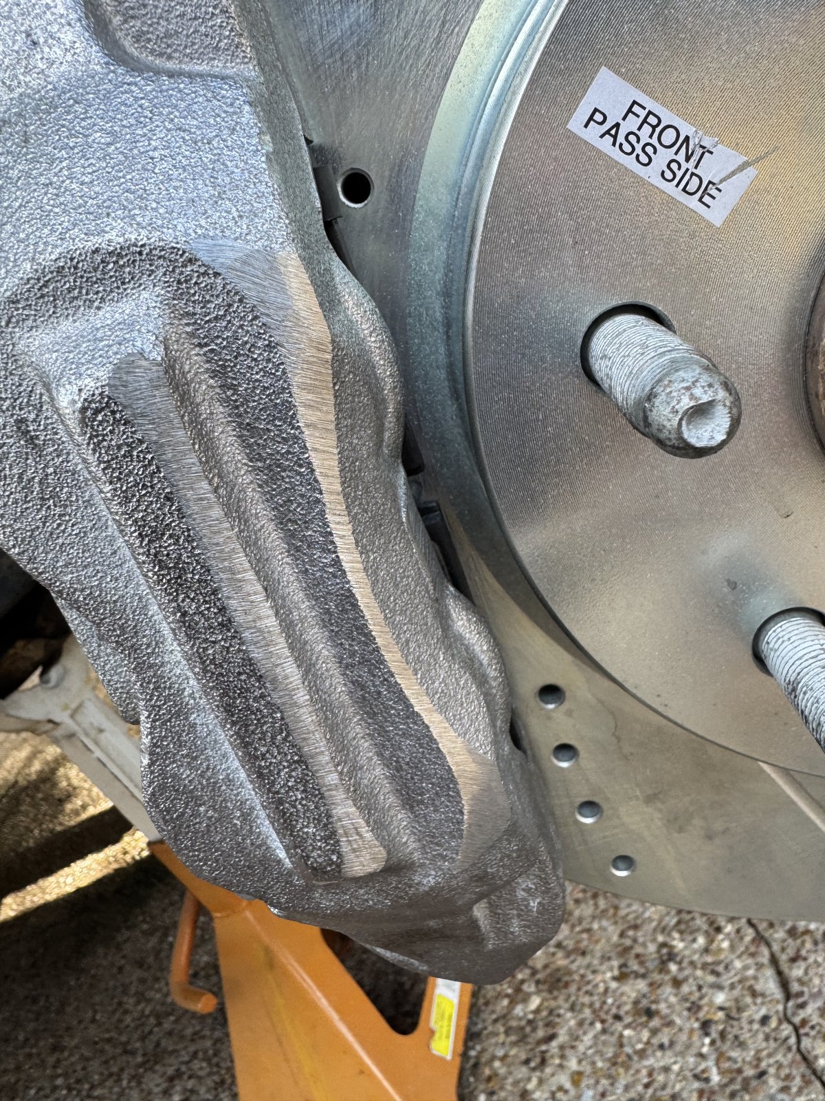

Here is a photo with caliper on my 2017 TAHOE with Z71 Wheels-18in. One could get away with grinding a chamfer on to the inside edge of the caliper before installation. However, I did the grinding after it was mounted so I had to touch the center rib to get that angle.
