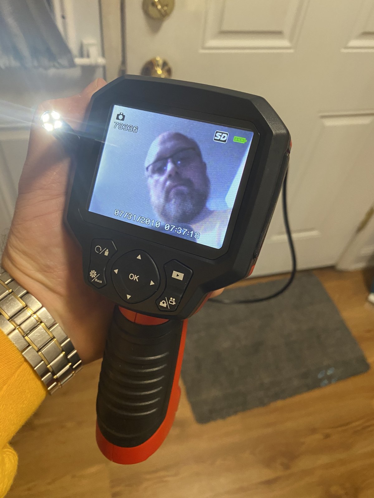

Would those be good enough to examine the cylinder wall?
I wonder how good the resolution really os
I picked one up on eBay. It’s fair, I wouldn’t call it HD. But it would work fine for looking at a piston. eBay has a long shipping time as it came from China. About 3 weeks.
