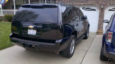

Has anyone smoked their stock tail lights on their Denali? Thinking about doing that instead of buying new tail lights. Just wanted to see if anyone else had done it and the process.

Get some spray tint and clear. Rough lens up with 1000 wet sand, spray 2 layers of tint with 1000 wet sand afterwards, spray 4 layers of clear then wet sand 1000, 3000, 5000, compound wax, polish wax.

I tinted the lenses on my nbs truck. as long as its done correctly I love the look of tinted tails
