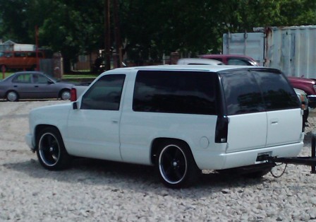

ive done a few sets with vht...great stuff but be sure to wet sand the shit out of your lights before you apply first coat. if you want them black....3 coats is perfect...mine are almost completely black and light comes through them perfectly. if you want a real glossy finish...lightly wet sand between coats. heres what mine look like:

clean with carburator spray before. it'll get rid of any waxy dirt. then clean with any household spray. you'll get a nice glossy clean coat.
