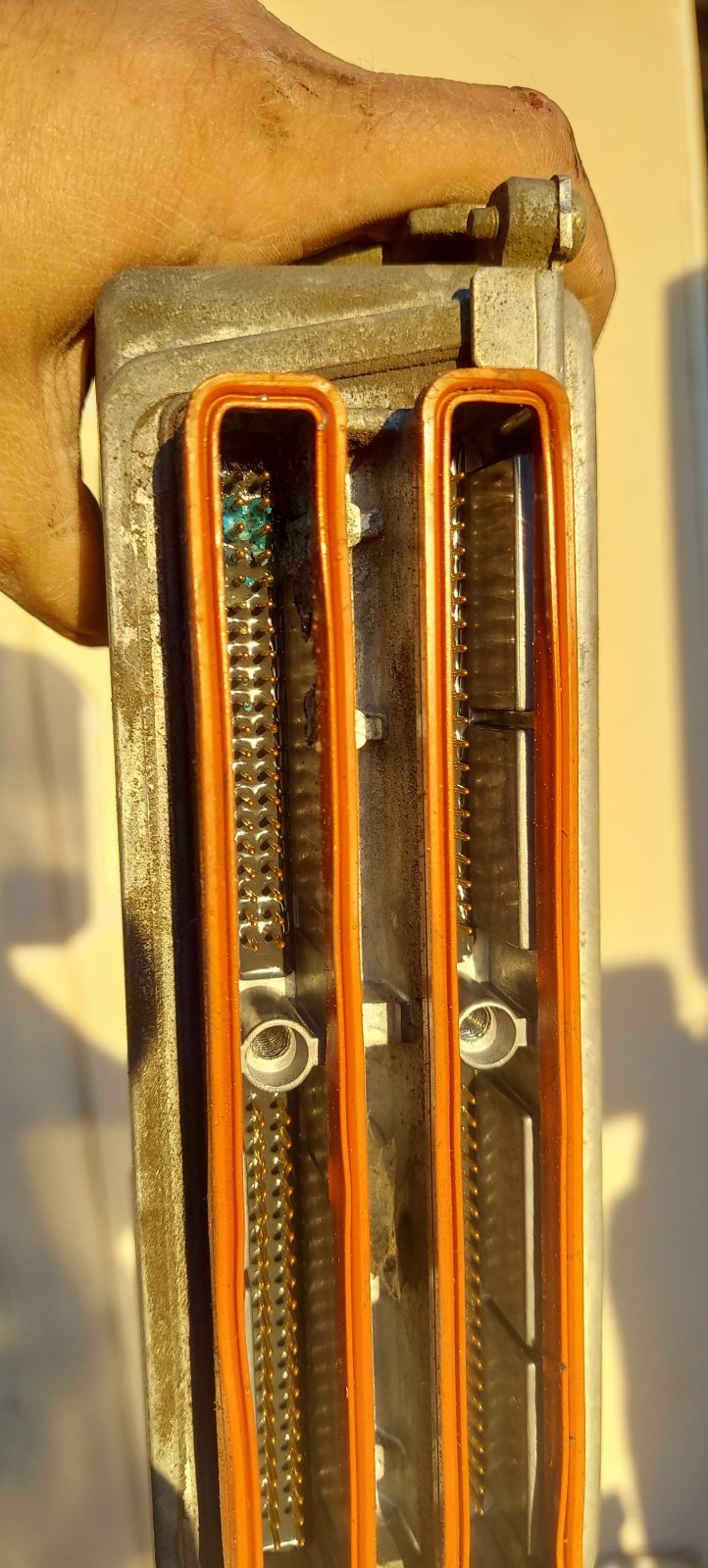

Well, found some corrosion in the connector. Used wd40 and q-tip to clean it up. Can't find any dielectric grease, so I'll probably wait to reconnect everything until I have some. Is this cause to pick up a new pcm? Is there something else I should be doing then what I've done so far? I still need to look at the harness connector and see how bad that corrosion is. I'm hoping not to bend it too much, I've heard the harness get brittle at the drip loop below the pcm.

I would clean up the contacts as much as possible with either Deoxit D5 or CRC QD Electronic Cleaner. WD-40 makes an electronic cleaner but it's not the regular WD-40 and I wouldn't necessarily use that regular stuff.
You may want to replace the water gaskets, too. And worry about the PCM later after you have success cleaning things up.

So far so good. it fired right up without any relearning necessary. Drove about 40 miles thus far with two heat cycles. no codes. I didn't check all the monitors, but I will again this afternoon. it looks like the problem has been solved.
