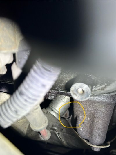

Now for the original issue. The smell. There was smoke coming from inside the engine compartment and I could smell something burning. I traced it back to the top of the block. Smoke is coming out of what seems to be a crack. Am I correct in thinking this is in the exhaust manifold?
