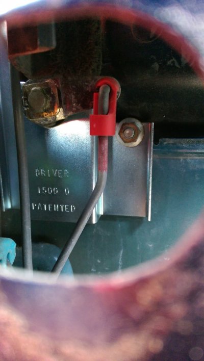

if it is not broke off on the inside (happens often) then you can just grab one at the junkyard and any locksmith can re-key it (just take them the lock and your existing key) and then just install the new lock, there easy it's just a clip on & off, if it is broken on the inside then you need a new housing also.
the housing is plastic on the inside where the lock sit's that's why they pop it there because it's easy to break

There's a steel plate that goes on, along with a clamp for the lock tumbler. Of course this is the driver's side. The steel plate also goes on the passenger side.
