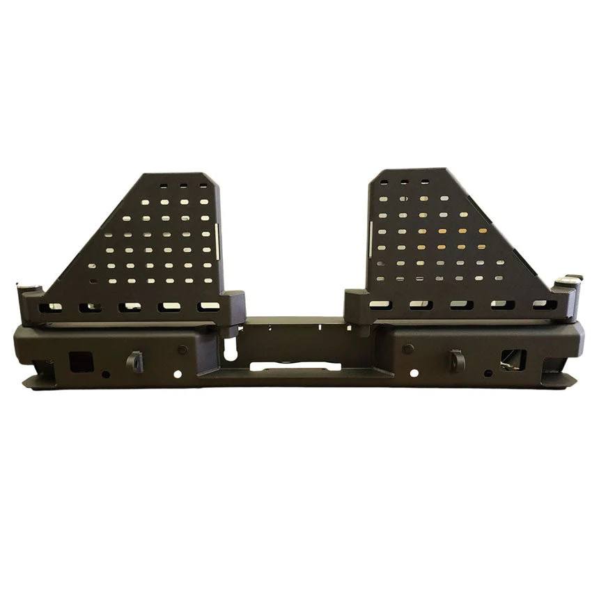

I was thinking about one of these below. I have a 2" receiver front and back. Anyone try something like this?
I tow a lot, so I'd probably put it on the front just when off-roading and keep it underneath when towing. I've had to dig out sand, snow, rocks and dirt too many times where that big spare gets me hung up.
Edit: Just read the Amazon reviews and the one that drops down (which you would need to open hatch in back) doesn't sound heavy duty enough. For me, I'd be more inclinced to get the CURT and mount it on the front.
