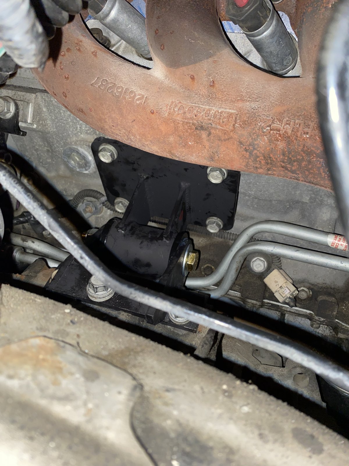

After seeing this I too bought a set of these and I’m definitely not worried about breaking them like the factory mounts. When idling I do get a minimum vibration but after a week of driving I don’t notice it anymore. He was a nice person over the phone & was quick to build and ship them. I’m very pleased with them. Wish he made transmission mount but he wasn’t interested in doing that.

My main concern about the poly is heat resistance near the exhaust...
Just make sure to use some sort of heat shield where the new mounts
are near any exhaust. It would be nice if there were a grease zerk to be able
to lube them up with silicone based grease occasionally. I found out years ago
on my GMT400 with poly A Arms to NOT use standard grease gun grease..
It ate up my sweet poly bushings in about 2 years of limited use.
So always use the super expensive silicone on all your poly bushings !!!

Fitting could definitely be added to these.. Drill & tap
