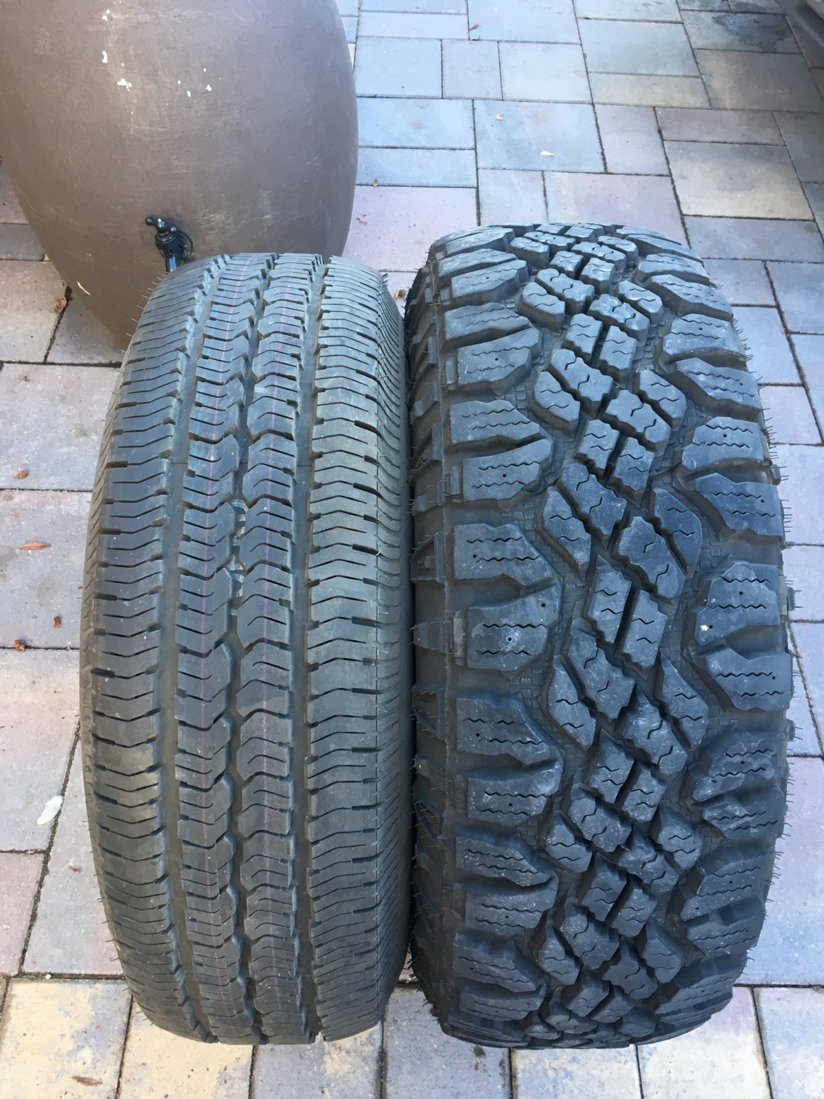

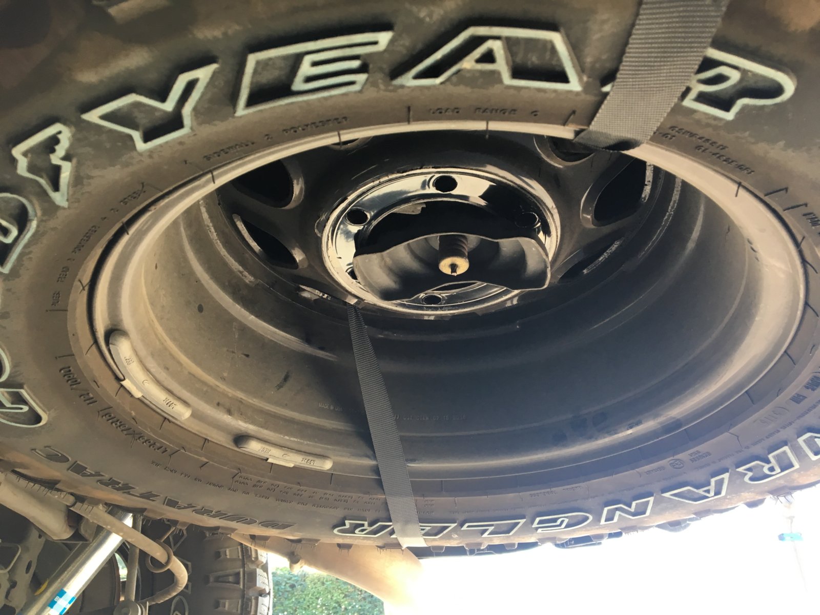

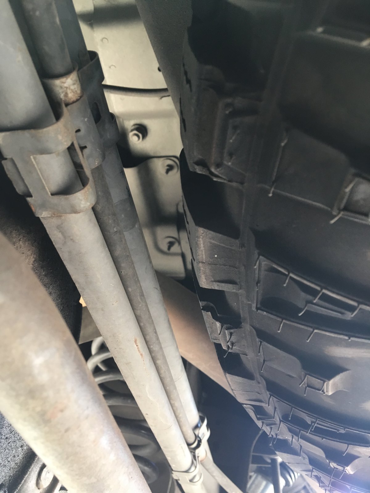

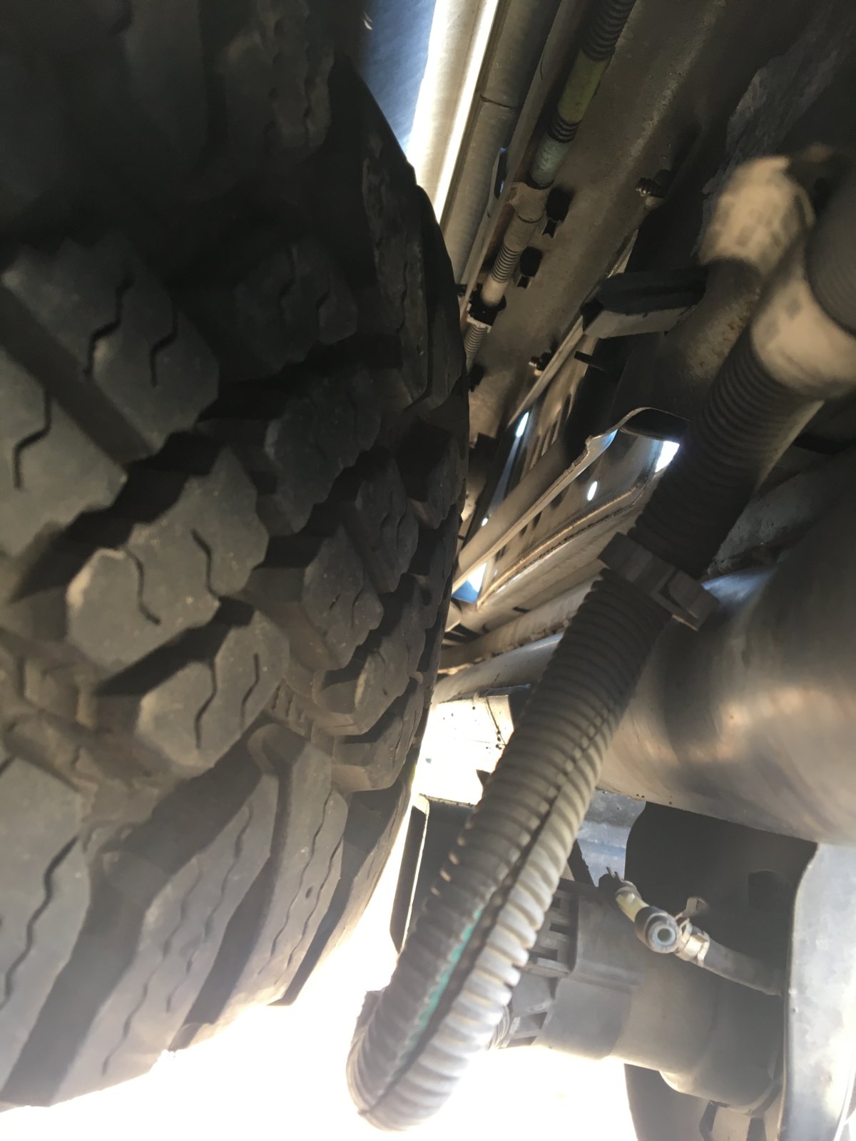

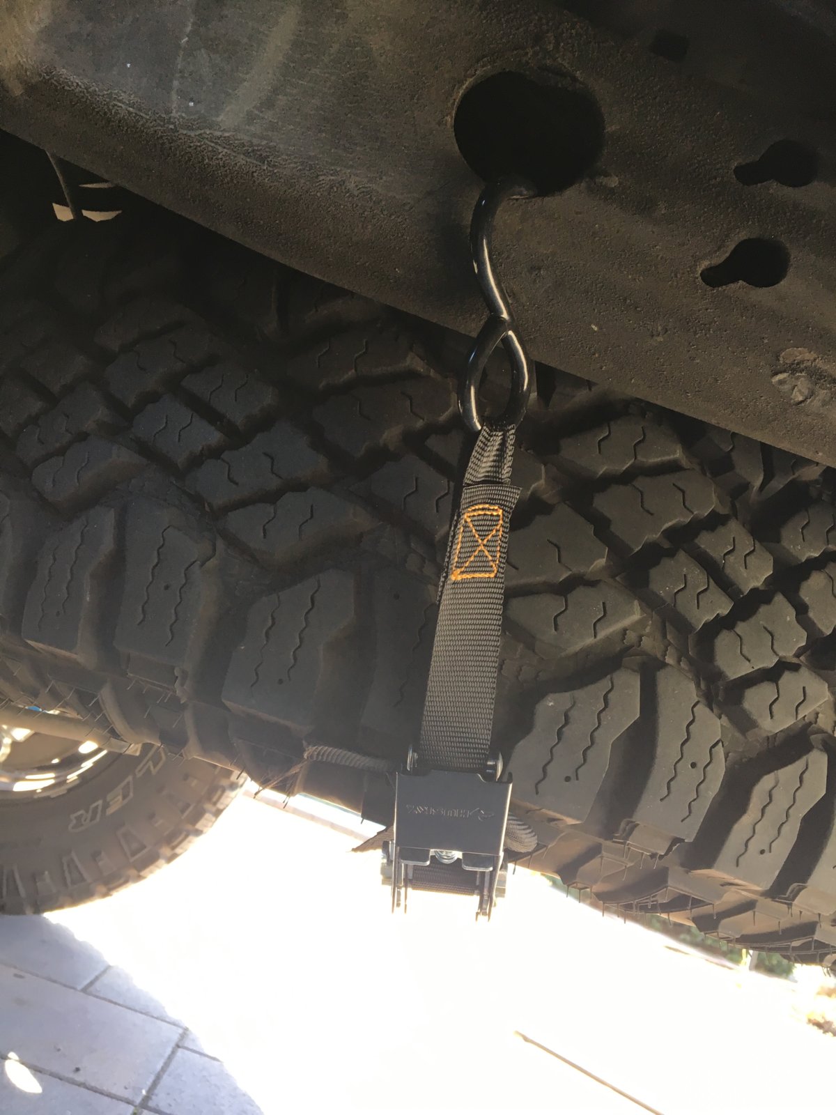

Hey All... new poster here, longtime lurker. I have 2000 NBS Tahoe and have wondered if the spare tire well will fit my slightly larger tires. I have Cragar D window steels 16 x 8 with Goodyear Wrangler Duratrac size LT 265 75 16. The spare is a 245 75 16 Goodyear street tire on cheap stock ugly aluminum wheel. I know, not much difference in overall height, but with the bigger knobbies, I just didn't know and want to have 5 matching. I swapped out the spare and put one of the Cragar/Duratrac up in the well and it fits in stock fashion. Luckily, I have an upgraded hoist without the secondary lock thing and it is easy to get up and down. It is barely a 31" if it is at all, however it does weigh more, I just hope the hoist cable is strong enough for the matching heavier wheel tire combo. I have to imagine it is being they have steel wheels and LT tires on other models and I doubt they made different hoists. The fit is tight at the front, nearest the crossmember, but does indeed clear...So, 33s and up will probably not fit in any way...I know peeps always wonder how big they can get back there, hopefully this helps someone...Thanks
