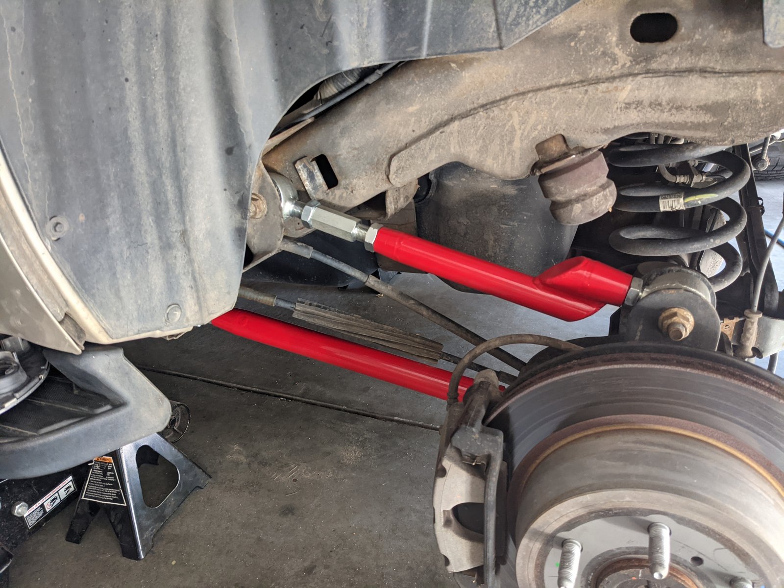

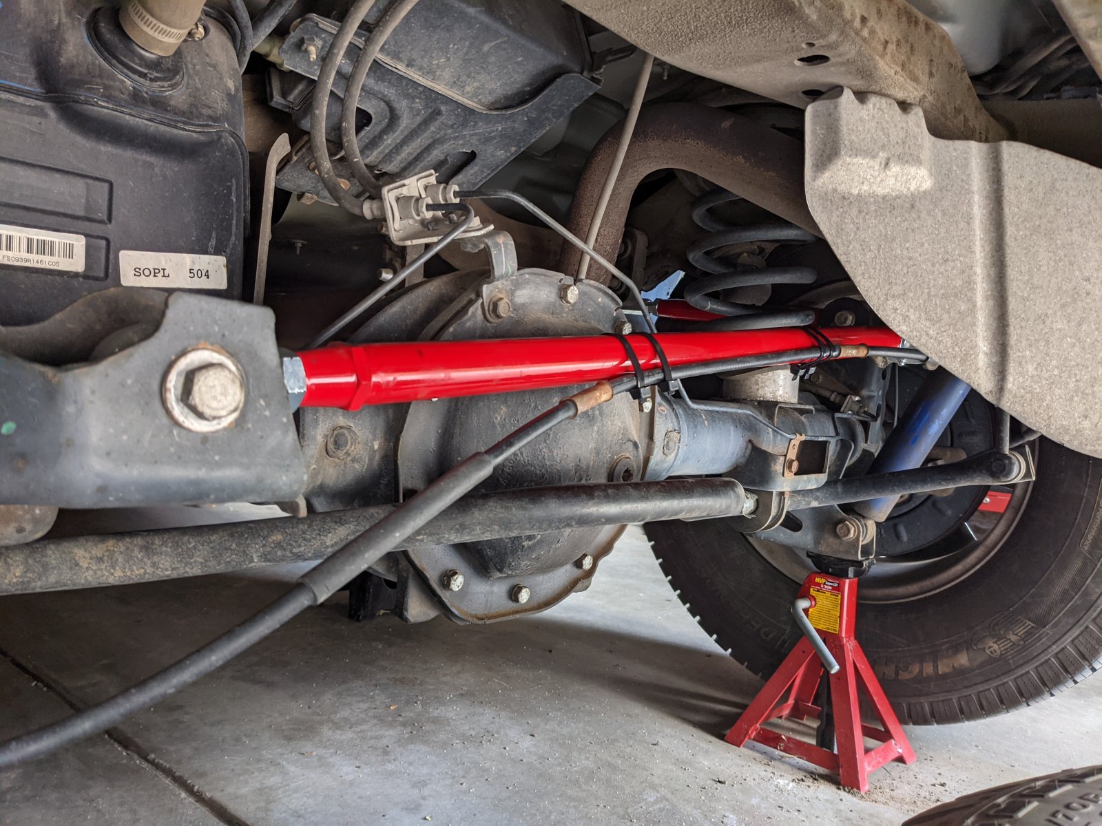

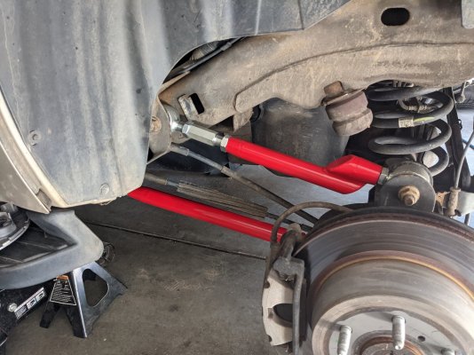

I got my Spohn arms and trackbar installed!
The brake line used to attach to the OEM track bar with clips that kept it up and not hanging near the ground. I used zip-ties to hold the brake line up on the Spohn track bar, but it is still too low for my comfort.
For those of you who have the Spohn trackbar, how are you holding up the brake line to where it's out of the way and not hanging down where it can get snatched?
