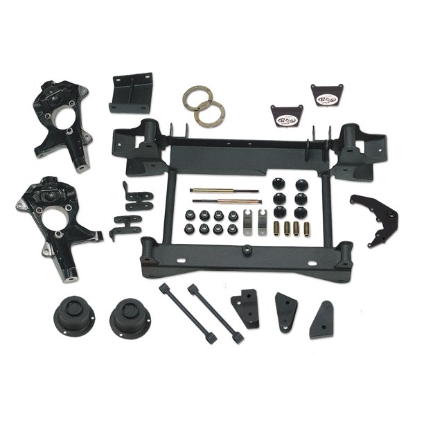

I lifted my 2003 Yukon a couple years ago with Tuff Country's 4" lift kit (picture of the approximate lift parts attached) and love the new stance! However, ever since doing so I will get the "death wobble" when hitting certain bumps or wide crevices on the road over about 50 mph. It's not all the time, but just sometimes when I hit those bumps. The truck otherwise drives smooth, straight, and has no issues, pull or wobble when braking. There's no other shakes regardless of what speed I drive on smooth roads; the wobble only occurs sometimes after hitting that bump at speeds between 45-60 (ish).
