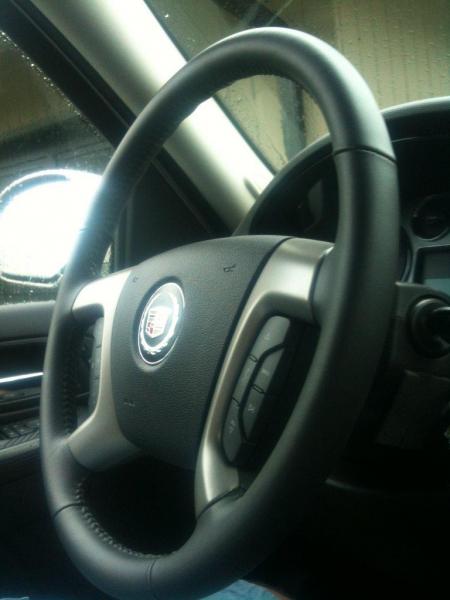

So I got the new wheel in but was a bit of a pain. Got the air bag off no problem. The trick to that really is having the right depth or you just end up stabbing around aimlessly looking for the right spot...if you go in 1 5/8" it's right there and easy. The main issue I had was the wheel on my 07 Escalade did need a puller. I luckily had a puller I made way back in shop class in high school (why I still have it I don't know) and bojanged it to work. Took me an hour and a half but got her in. Nice to have a brand new wheel again...like having a new car.
