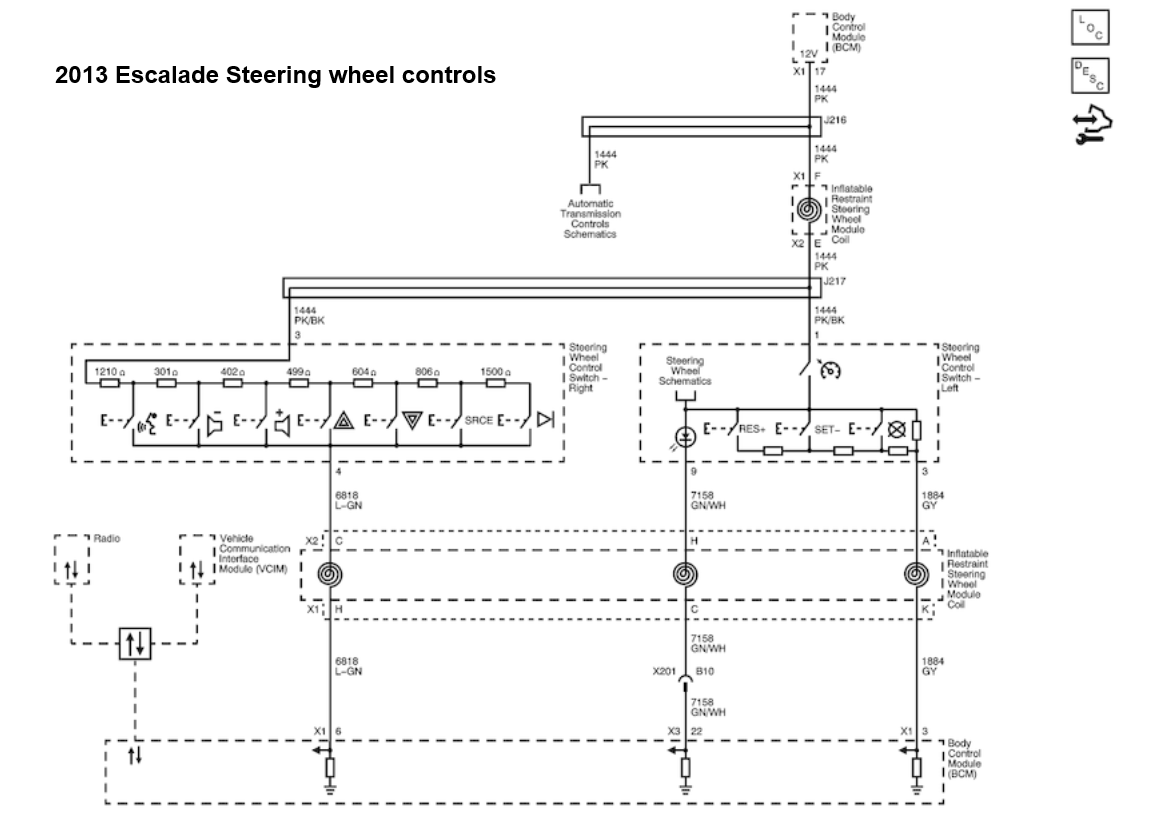

The real gamble with this situation is hoping the BCM is pre coded for a heated wheel. The wheel
Controls work off a 12v reference signal with different resistors in between each wheel button with a returning wire to the BCM. Each button send back a different voltage which the BCM is programmed for to carry out the desired function.
Not for heat, it's a on/off button with ground and 12v power. if you wired it to a constant power source and left it on it would drain your battery.
has no connection to the bcm.
if the button is on and power is on, it is heating.
which is why you connect it to accessory power only. that way key off, power off..
I could be wrong but I think the only button that goes to the bcm is cruise and even the lowest trim levels have cruise.
radio controls go to the radio (i think) otherwise all the people that have done the steering wheel upgrades wouldn't work
Notice the PNK/BLK wires both sides, your right on about the wheel heat, that would be a simple relay to setup.
