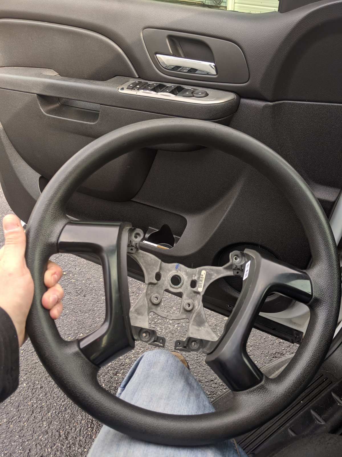

Yup, its just splined. There is a keyway near the top, you cannot put it on incorrectly. Just be mindful to not just rip the wheel off, since you need to unplug a couple of connections in the back of the wheel once you pull it off of the splined shaft.
Ah, that is good to know, so better take it off gently.

I ordered it earlier today :)
Also picking up a "steering wheel puller", I know.. I probably won't need it BUT, karma dictates when I don't have one, the steering wheel is stuck and I need one, then I have to drive all the way to town and back, and waste the money on gas. :)

thanks, but I already ordered one, it's here tomorrow.

@Ron C, just leave the nut on partway and wiggle the steering wheel loose; the nut will keep it from coming off completely. After the wheel breaks loose, remove the nut all the way.

Hmm, that's an idea, why didn't I think of that? (I did buy a steering wheel puller a few days ago, so might as well use it). Just keep my fingers crossed the airbag doesn't act up. (I read to disconnect battery and let it sit for 15-30 mins)
