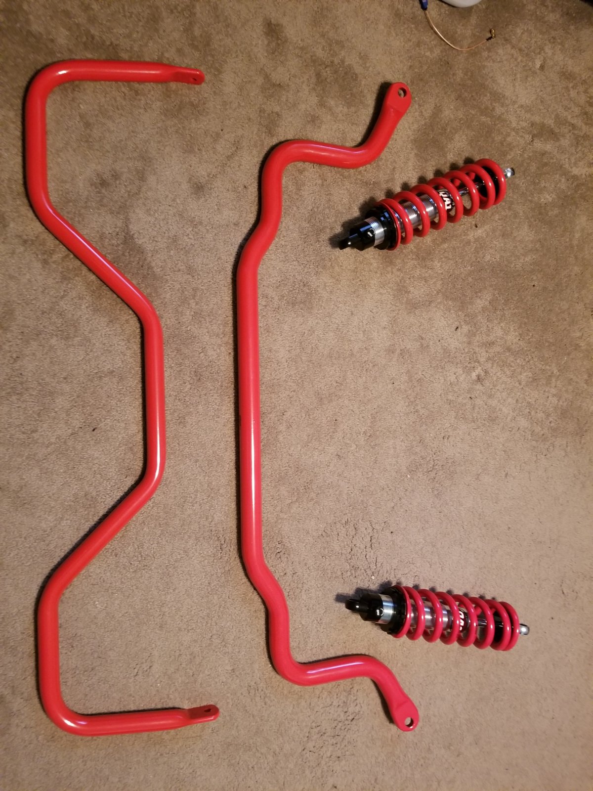

front prob wont happen for a while, figured i can unload drop spindles pretty easy and go back to stock if needed so i wasnt to worried about it. liking the ride at the moment, rear springs are much more lively, maybe not as plush as before but i think it'll be nice and do what i want being able to adjust the rear shock. sway bars will probably next suspension mod

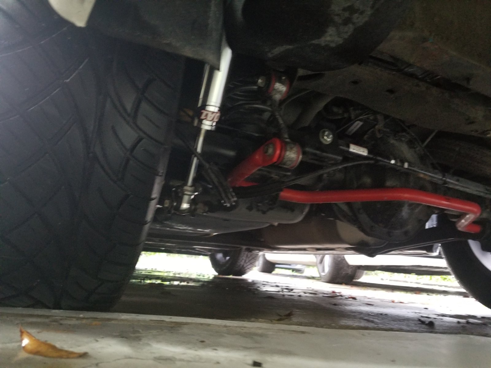

Checked the front level sensor links had pulled out of the cup a little bit, maybe 1/2" ...think that may have been why it was sitting uneven - havent remeasured but i dont notice the difference anymore

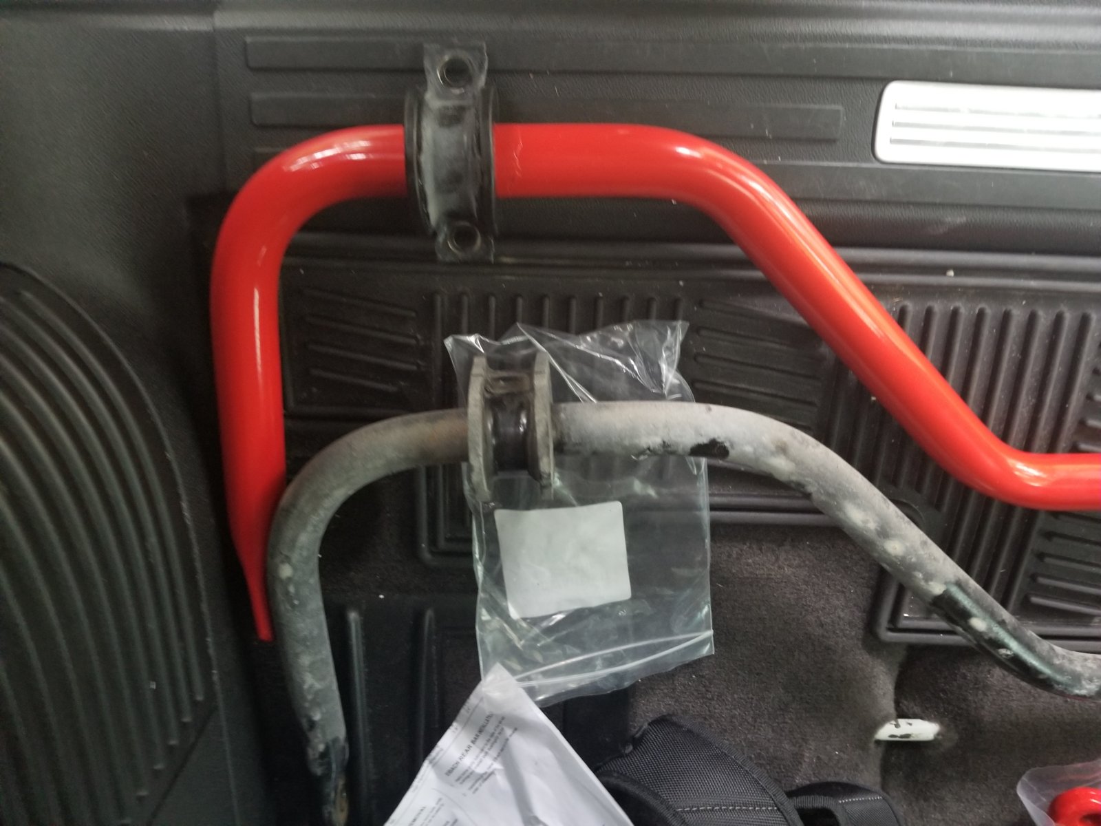

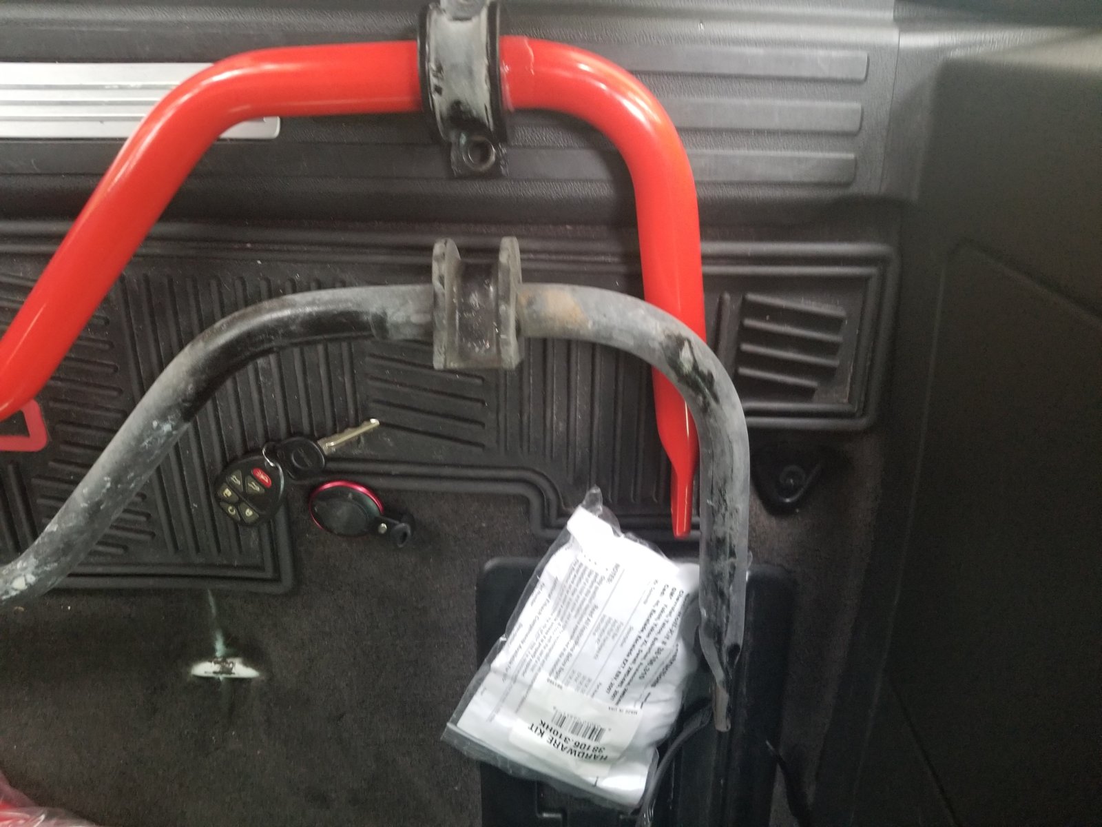

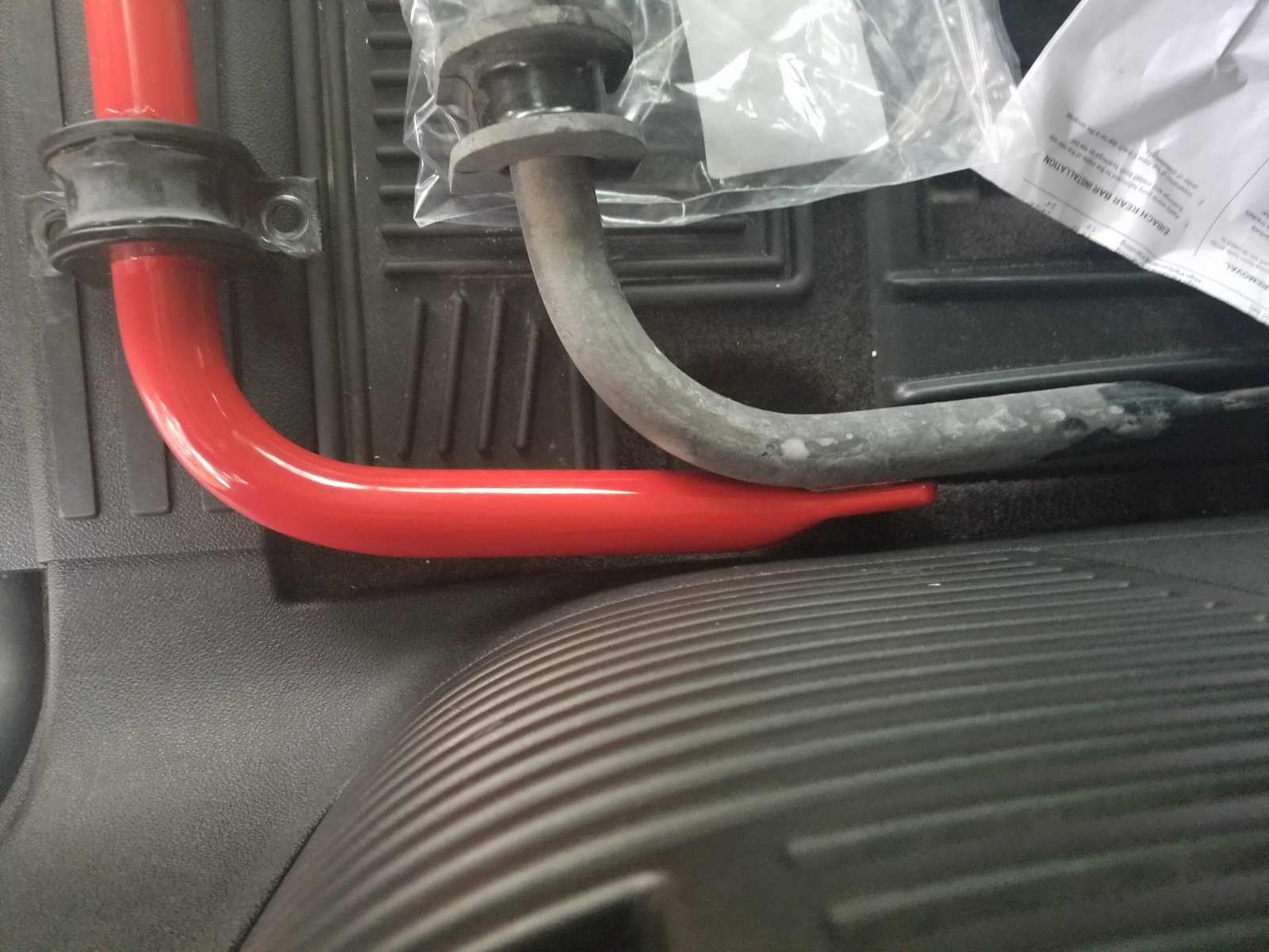

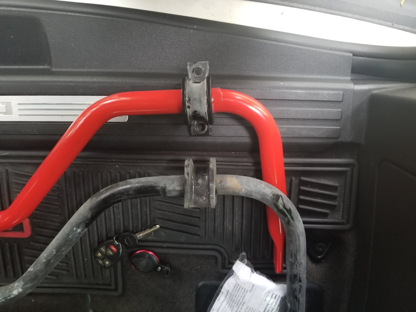

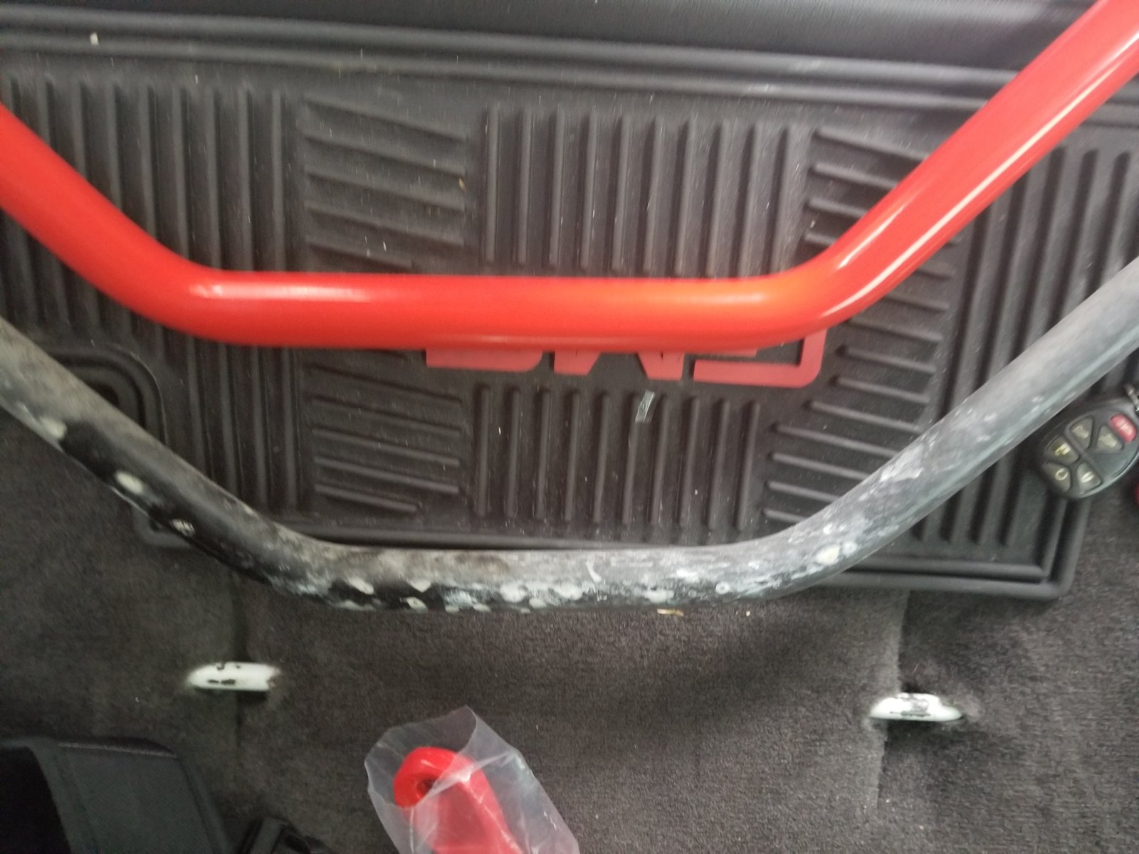

I did get the sway bar links on, didn't move the driverside bracket tho so it's kinda into the radius

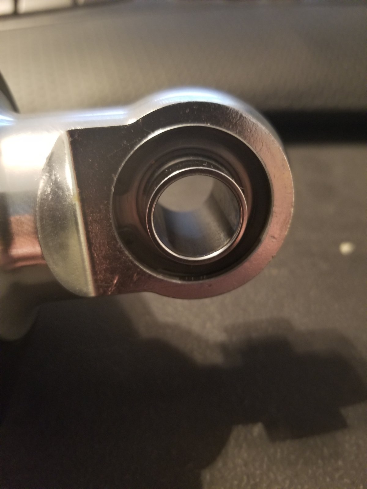

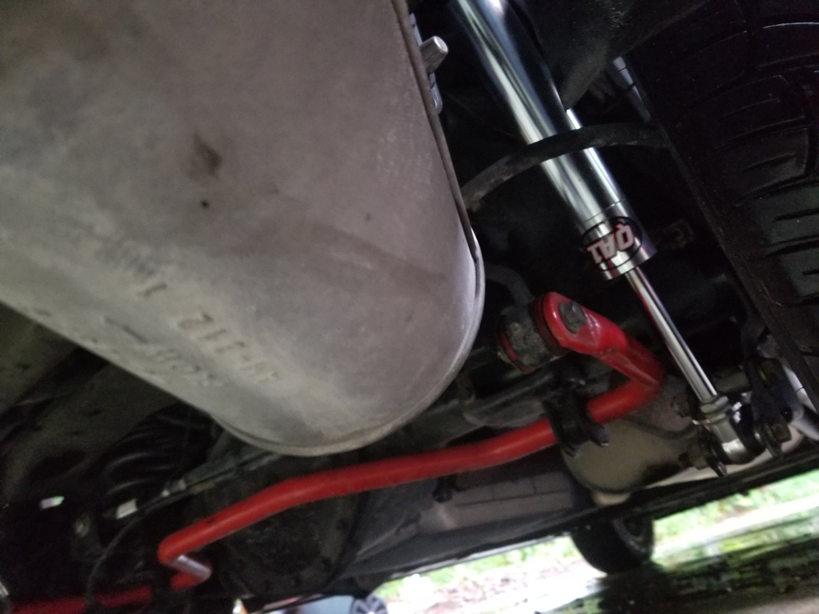

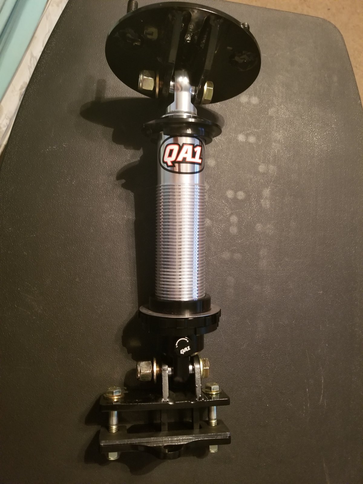

I ordered some QA-1s, ride height as it sits now (with autolevel) is right about 18" shock length. I may throw the spring spacer on if it drops much more deleting the air. I grabbed the delete resistors from ebay and hopefully the correct shock eye bushing.
QA-1 TS806: Compressed Height-13.50", Extended Height-21.00" single adjustable, 3/4" poly eye on both ends

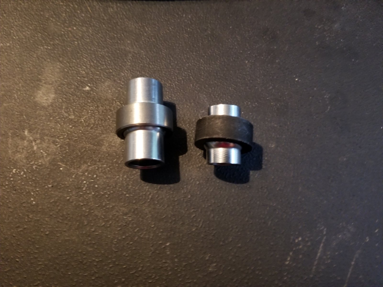

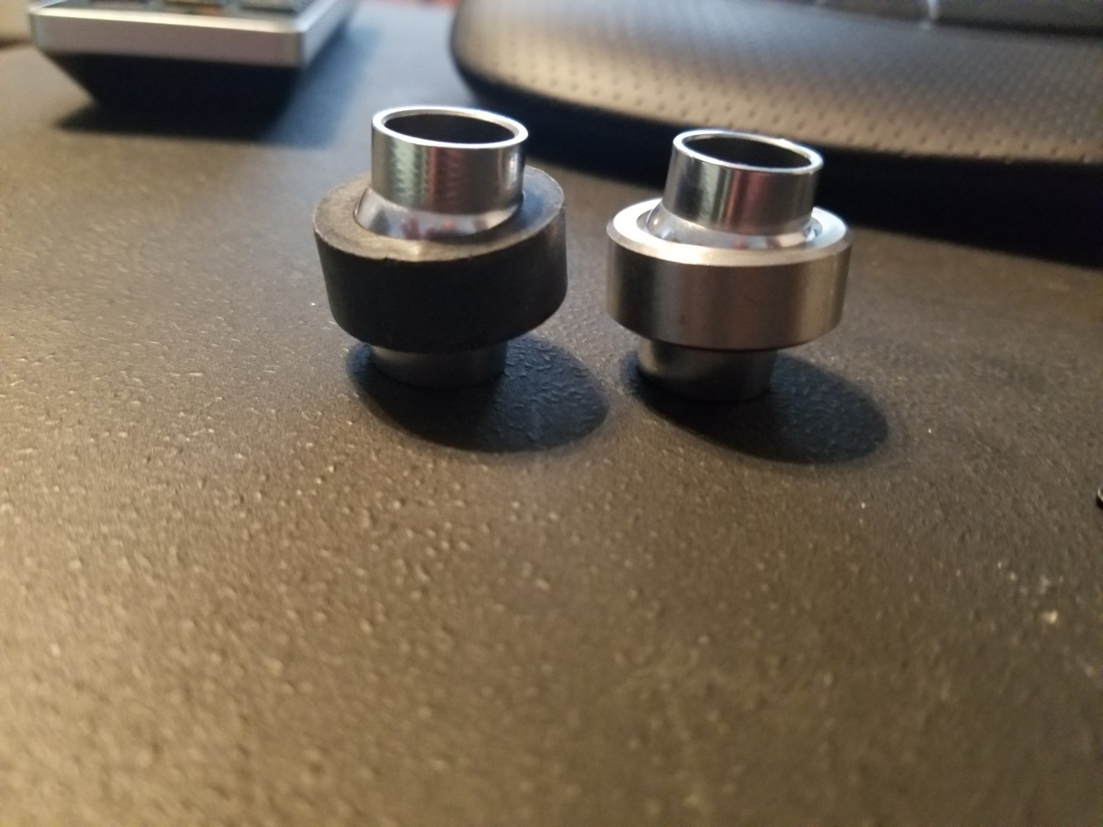

Fox shock makes a sleeve that is 3/4 OD, 14mm ID, and 1.675"L which i'm hoping is the correct one needed, i ordered 4 of them
part no. FOX-213-28-001-B
Got all this on earlier to day, everything worked out perfect - i am horrible about taking pictures but i'll crawl under and take some in the morning. The QA-1s come with a bushing in the 3/4"poly (it's "for" a dodge dakota) that is the correct length at the mounts but is only 1/2" - My truck had 9/16 (14mm) so i did grab the correct sleeves, also the ones that it came with have two c clips that keep the shock centered ion the bushing, i couldnt find any sleeves that also had them (ours are pretty well in line i dont know how big of a deal it will be) i will see if it forced it's way to way side and figure something out. QA-1 makes a longer sleeve 2-1/8" iirc that could be cut down that has the indent for c-clips if needed.
removing the air ride shock did seem to drop it some more - i will end up putting the spring spacer in for now until i figure out what i'm doing with the front. Also the panhard bar is kicking the axle over and getting some tire rub so i'm going to go ahead and order the spohn adjustable. i drove around with it on the softest setting and ride was still pretty smooth. anything over like 10 is real bouncy

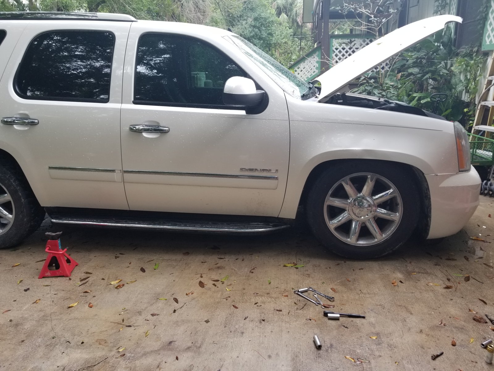

Fender heights are now 33-1/2" driverside, 34" passenger side front and back, to me I still think the front needs to come down a hair tho.

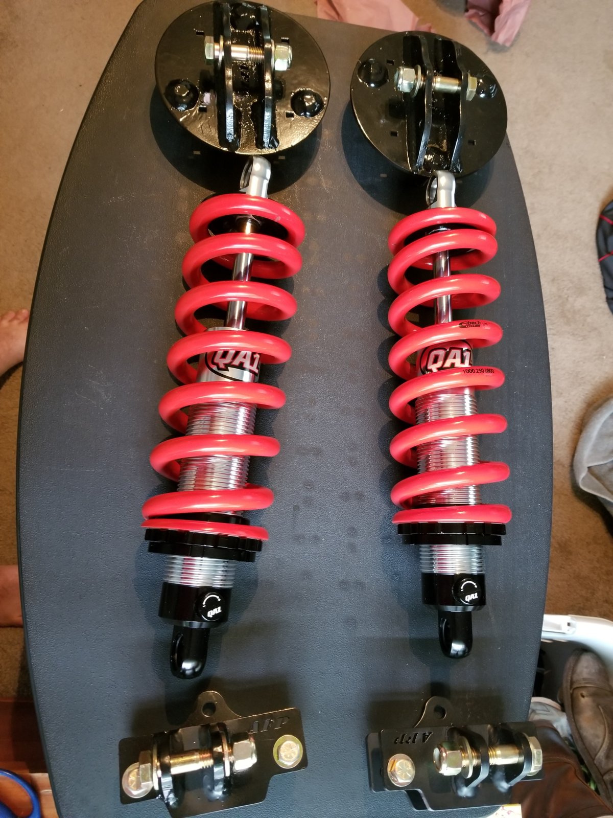

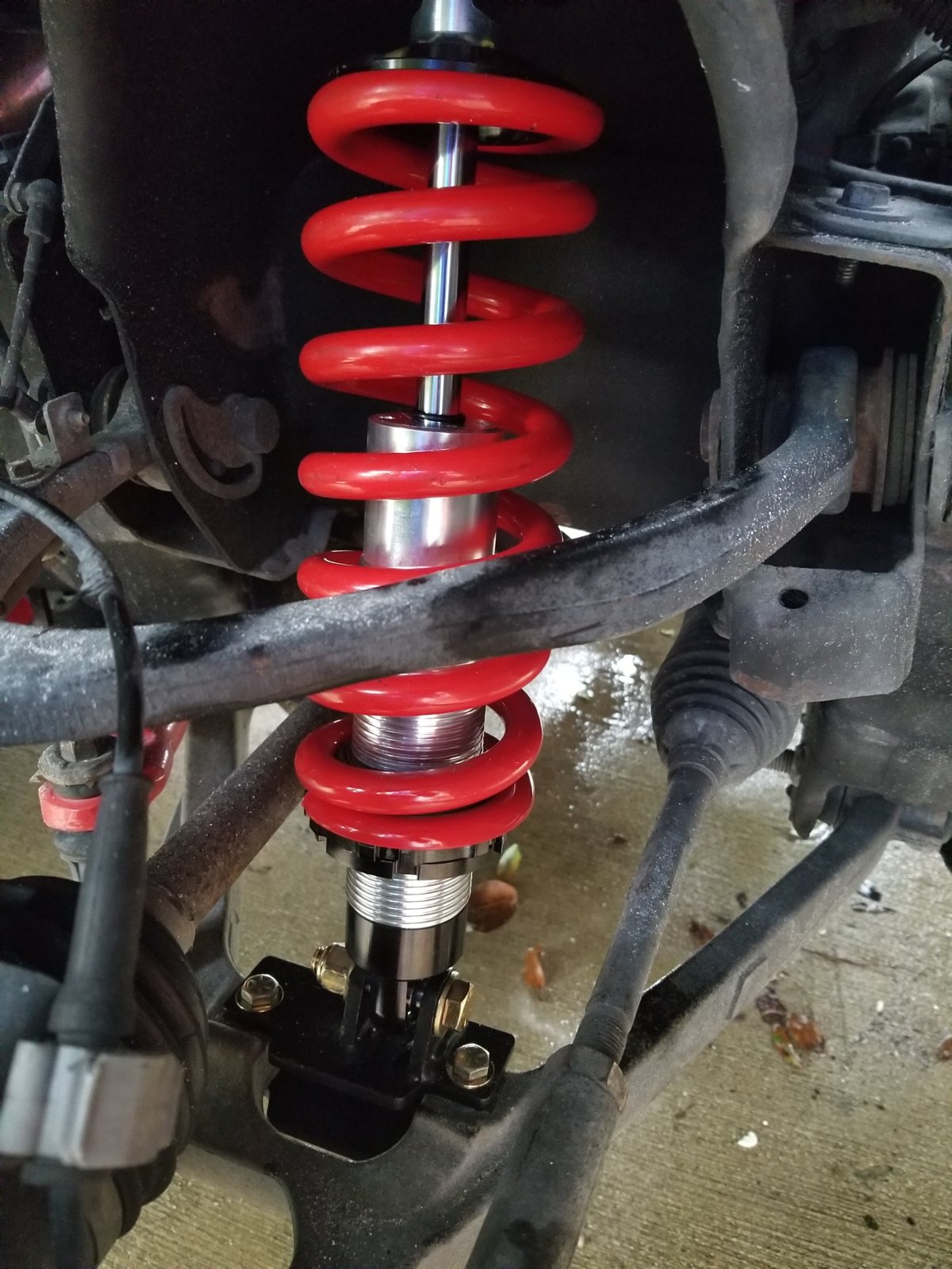

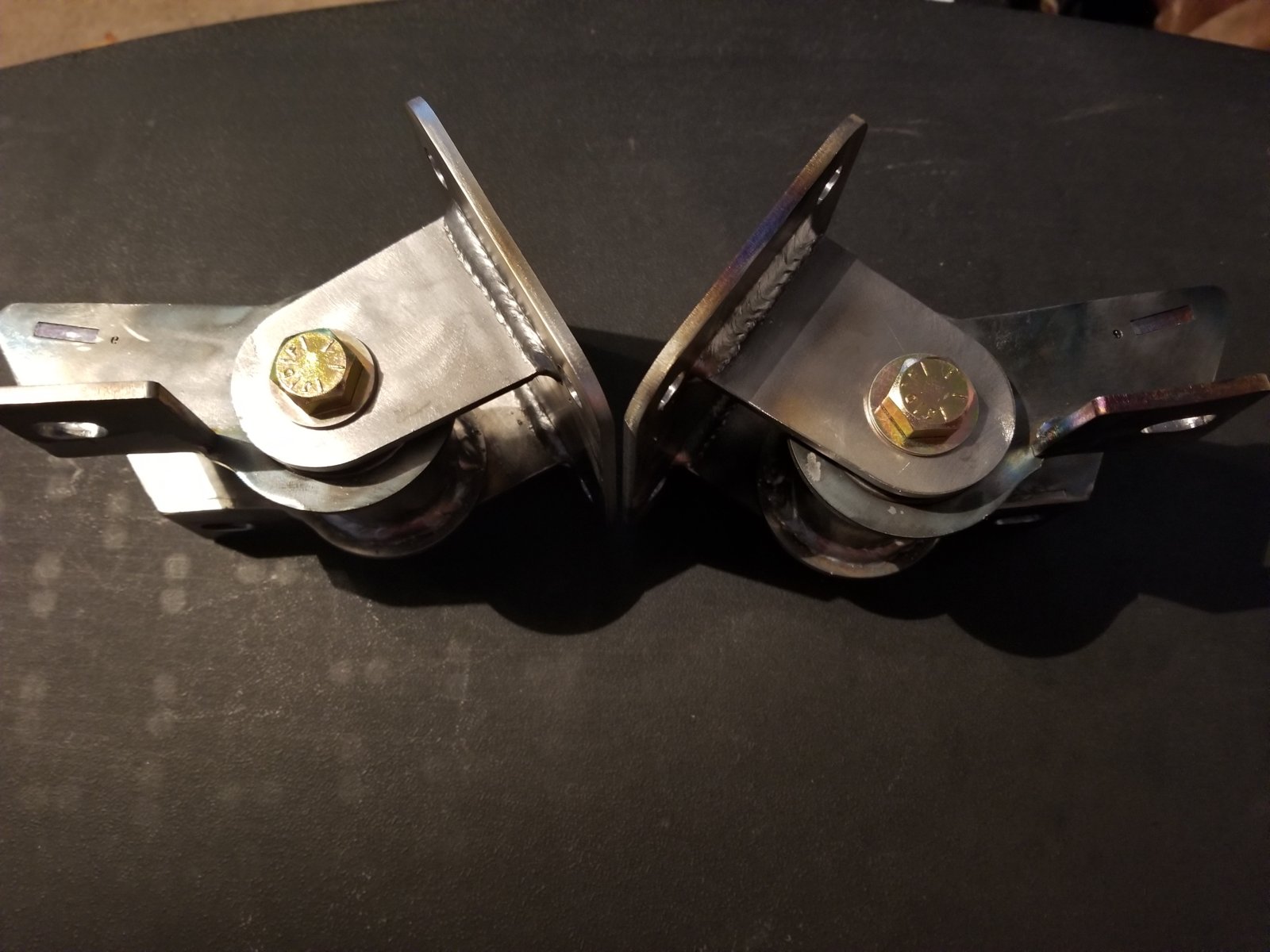

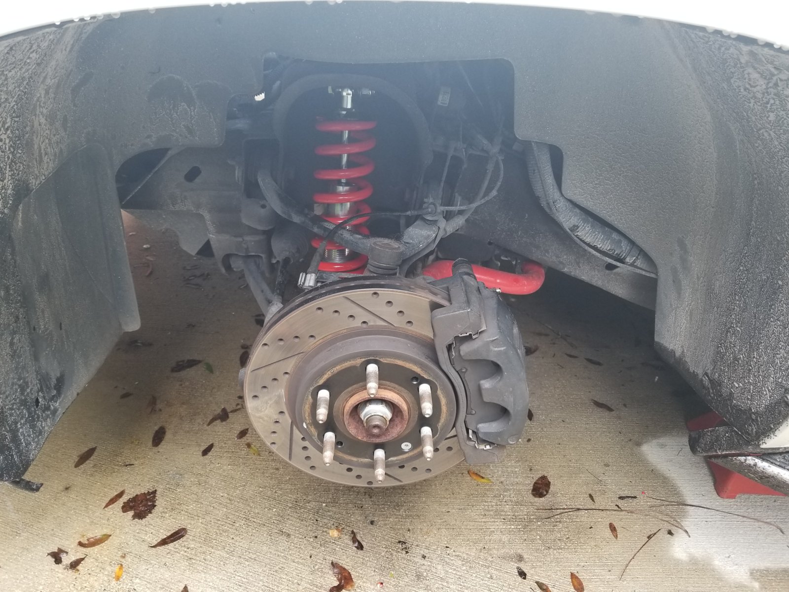

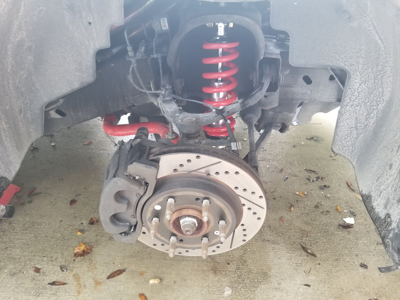

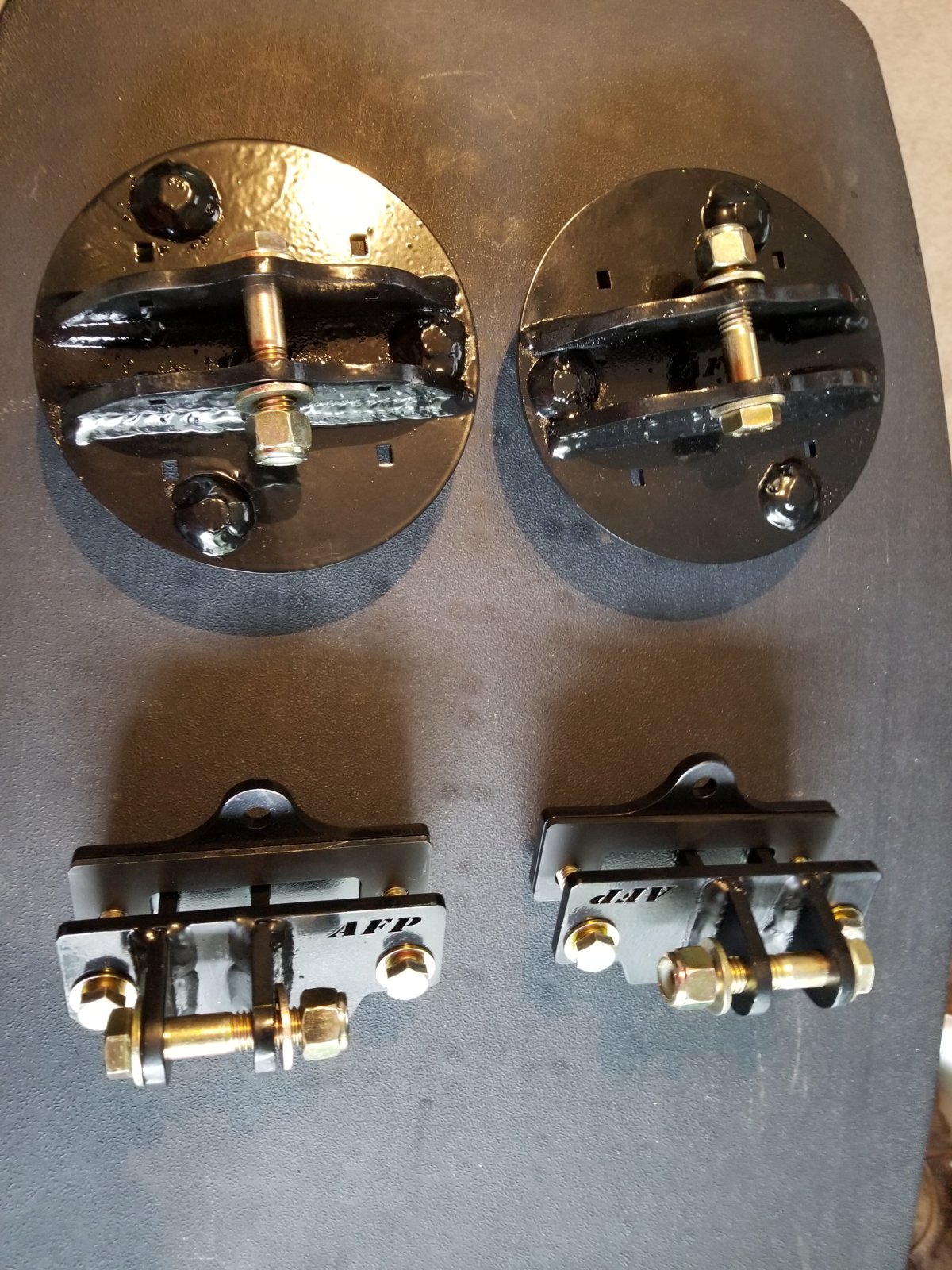

Next up for the front....
Well i was trying not to go much lower, another inch i think would make me happy :anitoof: . These should give me another 2" drop on top of the drop spindles - 800lb/in springs, 900lb/in springs are available and may put me where i want to be. Otherwise i gotta go back to stock spindle, but i think it'll be fine.
I will pull the rear spacer out and probably do the heater hose on the coil to drop the back as far as possible.
waiting on a brackets for the front, I may try and get free mod done this weekend if i got nothing else goin on .
kbuskill
Mar 11, 2017
5,314
8,342
NE. FL.
Are you having custom brackets made or does someone already make them?
