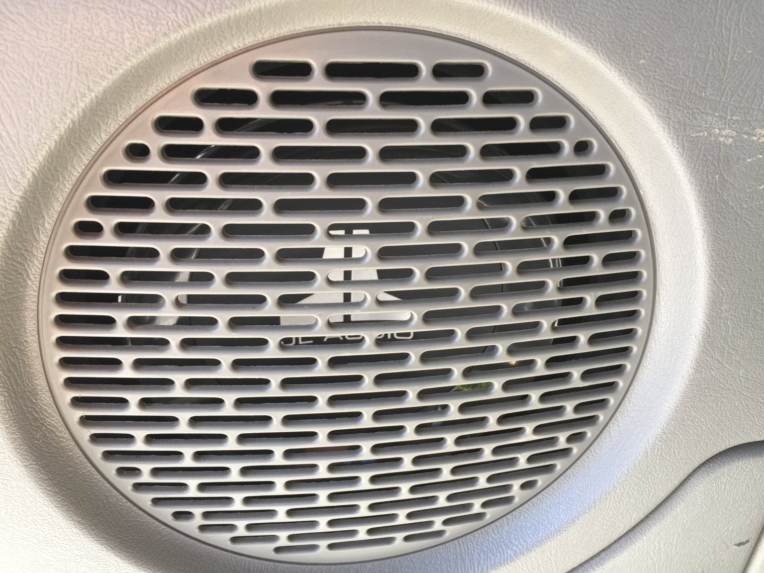

IMG_4333.JPG I put a JL Audio 10W1v3‑4 10"' in the stock location using an MTX Thunderform enclosure. Kind of expensive but it works real real well. Here's a link to another member's post with pictures of the setup: http://www.tahoeyukonforum.com/threads/01-denali-thunderform-install.52397/IMG_4333.JPG
Edit: if yours isn't a Denali, no problem. Just install the enclosure and disregard the part about the stock amp. I went with an added Soundstream Nano amp for the sub along with the stock Luxe amp for the remaining speakers in my Denali.

I installed a Sony DD head unit so I just used the subwoofer output on it. I installed the Soundstream under the 2nd row seats and just taped up the original sub speaker leads. Mines now a "hybrid" system with the Sony HU , the stock Lux amp running the Bose speakers minus the sub and the new sub setup. It really sounds loud and clean. If you're going to run the stock head unit, you'll need a line out converter or an amp with a speaker level input. The Soundstream has both types of inputs (RCA and speaker level). You can use the original sub speaker leads.
