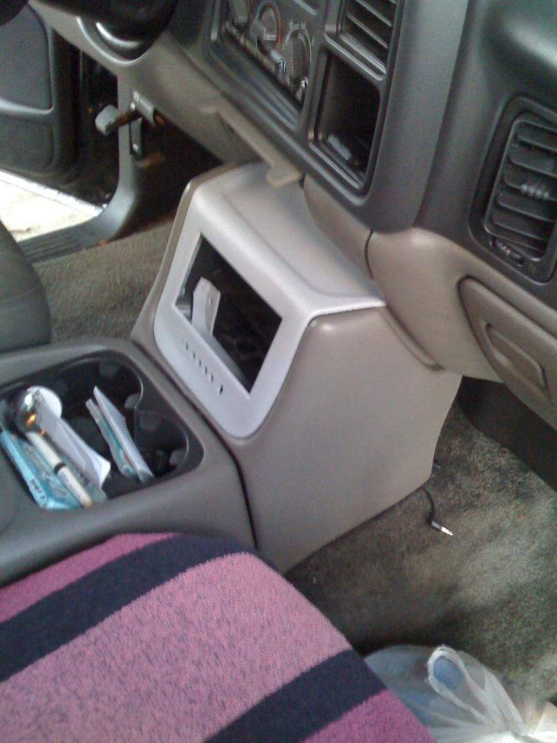

i took my cassette player out and got the metra peice that is ment for the spot. perfect fit and easy to install. however it was $100...thank god circuit city didnt notice it was missing :wink wink:. i ran my ipod cable to the pocket and i store my ipod in there when it is connected.
heres the pocket in the top of this pic

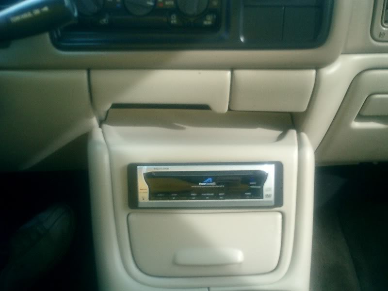

id like to see more pics of what people have done with this space. i myself was wanting to get an eq installed in that space. what din size is it and is there a kit that will make that work?

it's almost a single din and no "kit" to make a radio or eq work. If you cut it out correctly, the cage will hold it in place

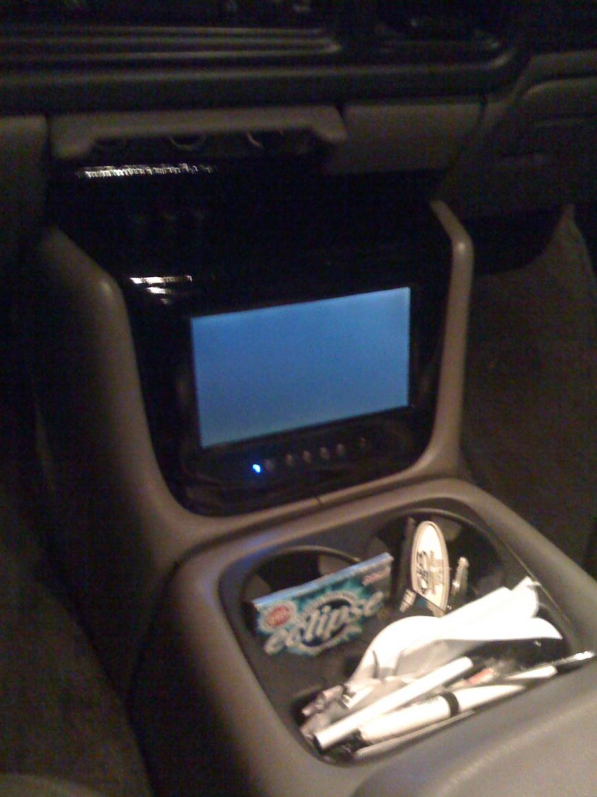

My friend actually put a flip out monitor and wired all his screens to the video out put of it.. That way he could use his alpine deck separate... Dont know why but he just cut it a little and it slipped right in. Pull up the cup holders and alot of room for connections and what not then put them back in

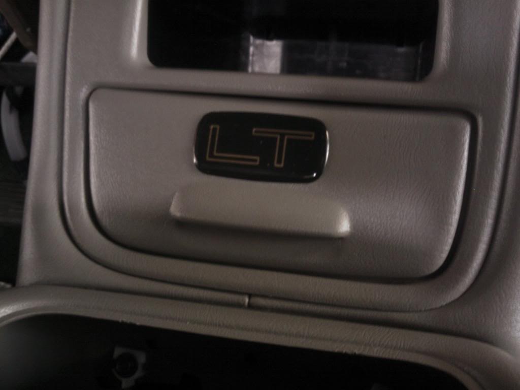

I found little cubby for it at my local chevy dealer, it was 15.44, a guy on ebay wanted 30 plus 8 to ship. I also read on another forum that car install shops will carry these as well. It should be in today and then i can get it installed hopefully some time this week. Thanks for the posts and ideas
