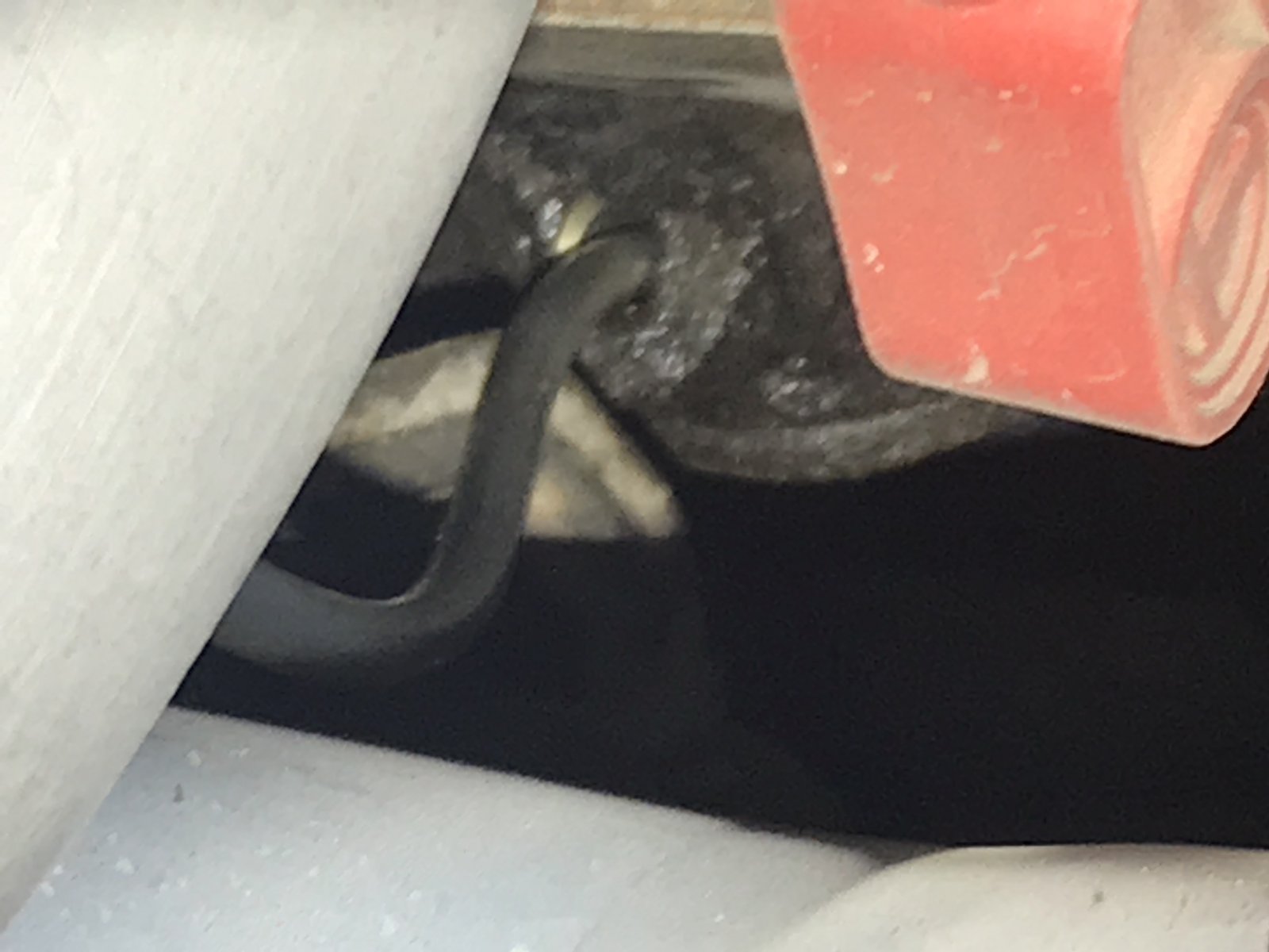

After a lot of twisting and pulling, I was able to free the tube from the dipstick hole. I have no idea what it was hung up on and it certainly sucked more time from my day than anticipated but it's done, oil and filter changed and ready to go again.
Thanks for looking and considering this issue even if you didn't have any solutions. This forum is always great for quick replies when needed. Cheers.
I was using a Vacuum Oil Extractor which I have used before to pull some oil out before I drained the remaining oil by unscrewing the oil pan drain plug.
This time, the plastic tubing got stuck inside the dipstick engine port. I removed the metal dipstick holder by unbolting the bracket and pulling the holder out of the engine. The plastic tube remained stuck inside the lower part of the engine.
I have tried twisting and gently pulling but it feels like the tubing is stuck between some metal parts. I have looked for schematics of what parts might be grabbing the tubing but have been unable to find anything that indicates what is in that lower section of the engine.
Before I start yanking and possibly bending some fragile engine components, can anyone offer some guidance on what could be holding this tubing up and risks of pulling the tubing out with force? To be fair, I have giving the tubing some pretty good pulls and twists within my comfort level that I wouldn't break or bend anything from the pulling. Without knowing more, I am a bit hesitant to pull any harder.
Thanks for your help. Until I get this tubing out, the truck is stuck in the garage and awaiting new oil, new filter, dipstick holder to be reinstalled, etc, and cannot be driven until I sort this out.
Thanks for any help.
