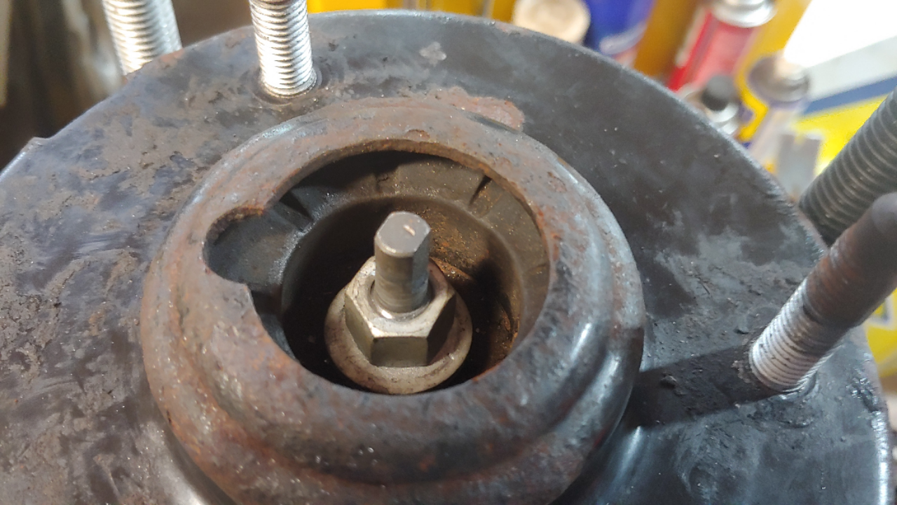

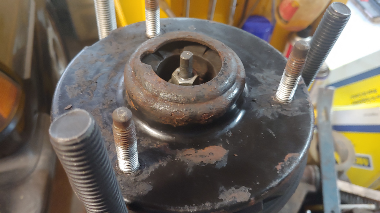

View attachment 375477View attachment 375478
@LaxCoachT I ended up grabbing the top with vise grips and using an open ended wrench and going around it at an angle. Certainly wasn’t the best method, I’d do what the other guy said lol
