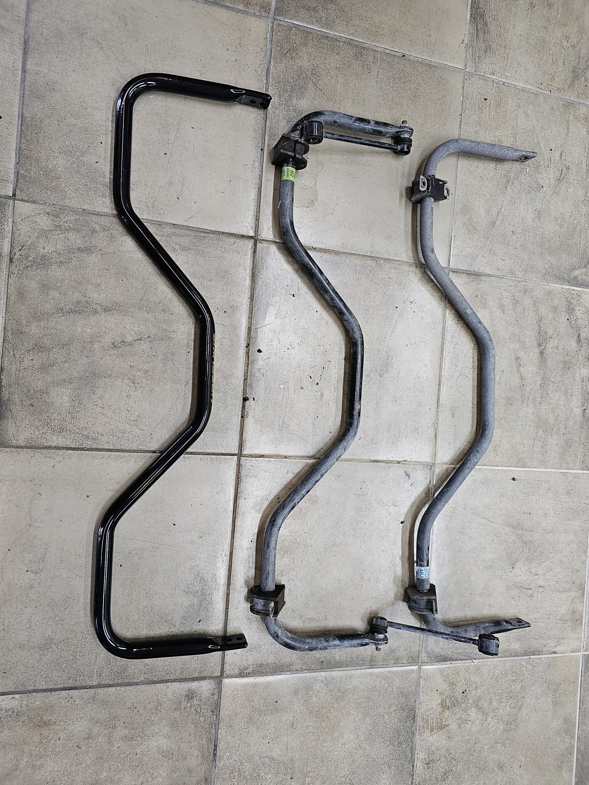

I put a caliper on the old sway bars, and they are both 1" in diameter, however the suburban bar is much heavier so the Hotchkis claims appear to be true. The Hotchkis is 1 3/16" and about as heavy as suburban bar...

Interesting observation! Is it possible the lighter bars are hollow even though they share the same exterior dimensions?
Either solid or thicker sidewall - I dont really have a scale, but it seems almost twice as heavy but it still has the links still on it.
I wouldn't mind this upgrade. Do you know if there are any weight differences in the front bars?
