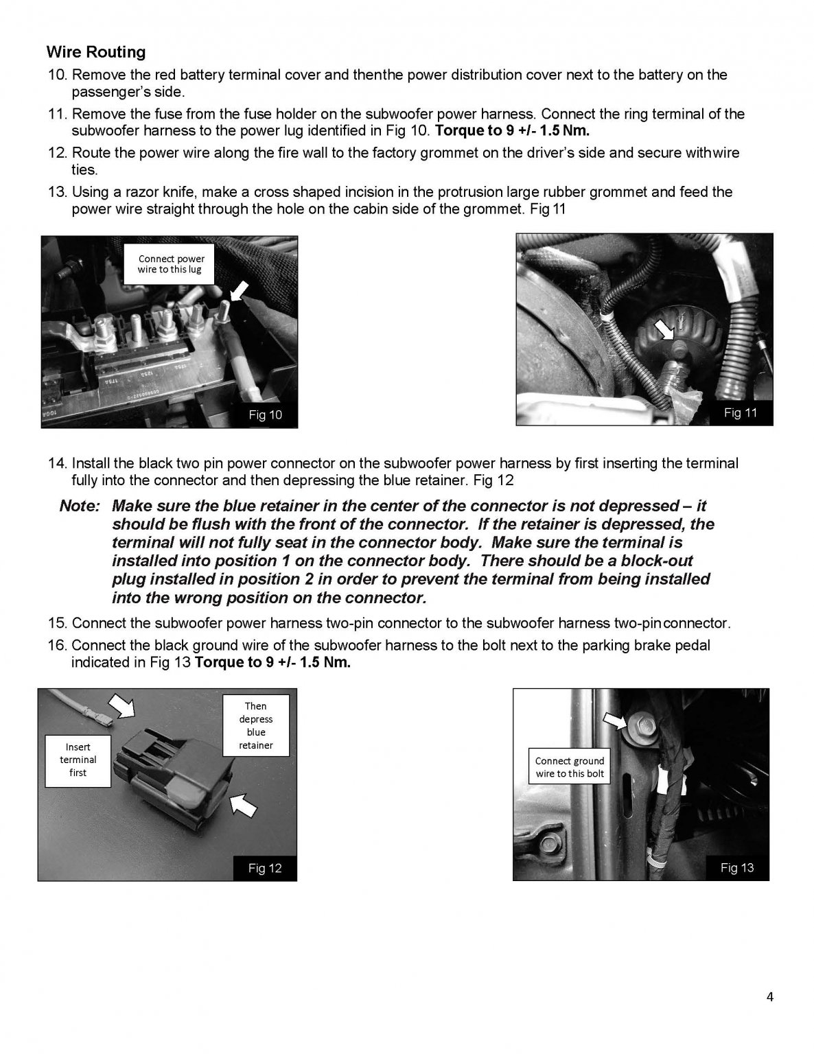

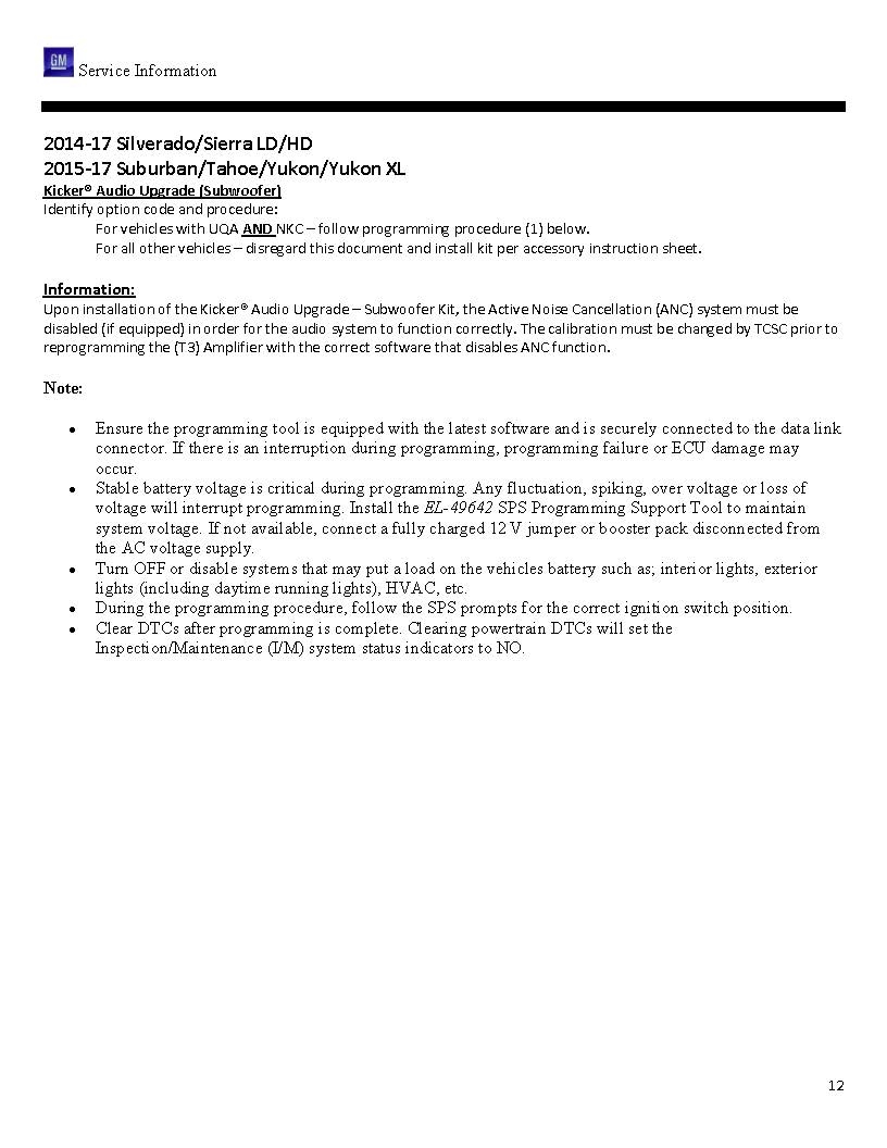

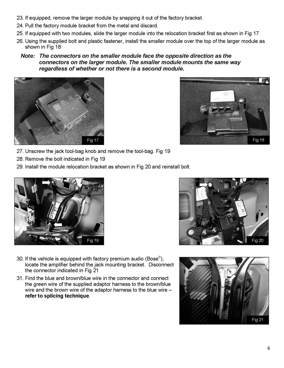

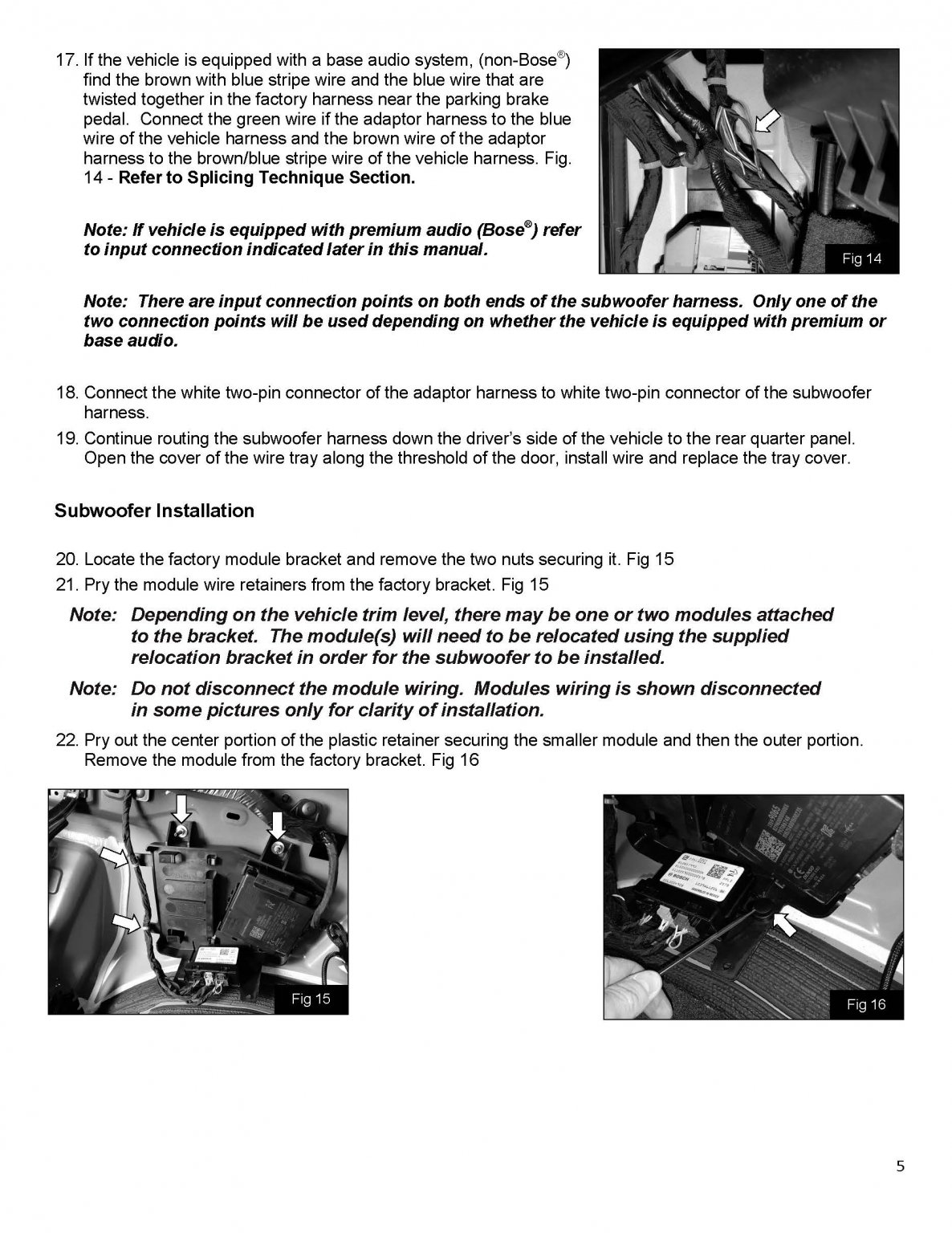

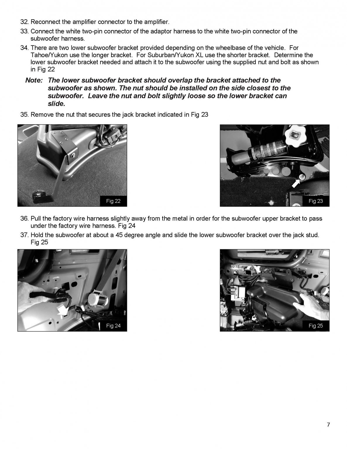

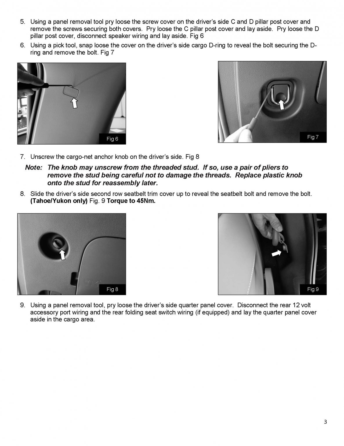

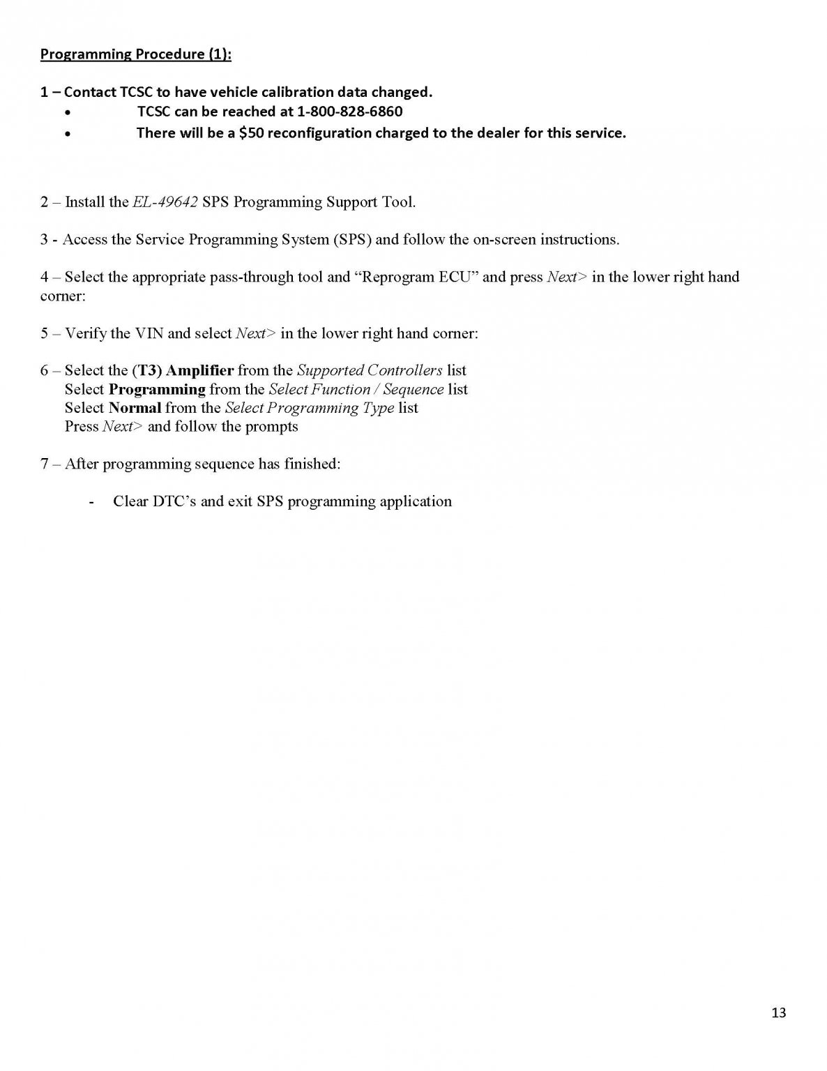

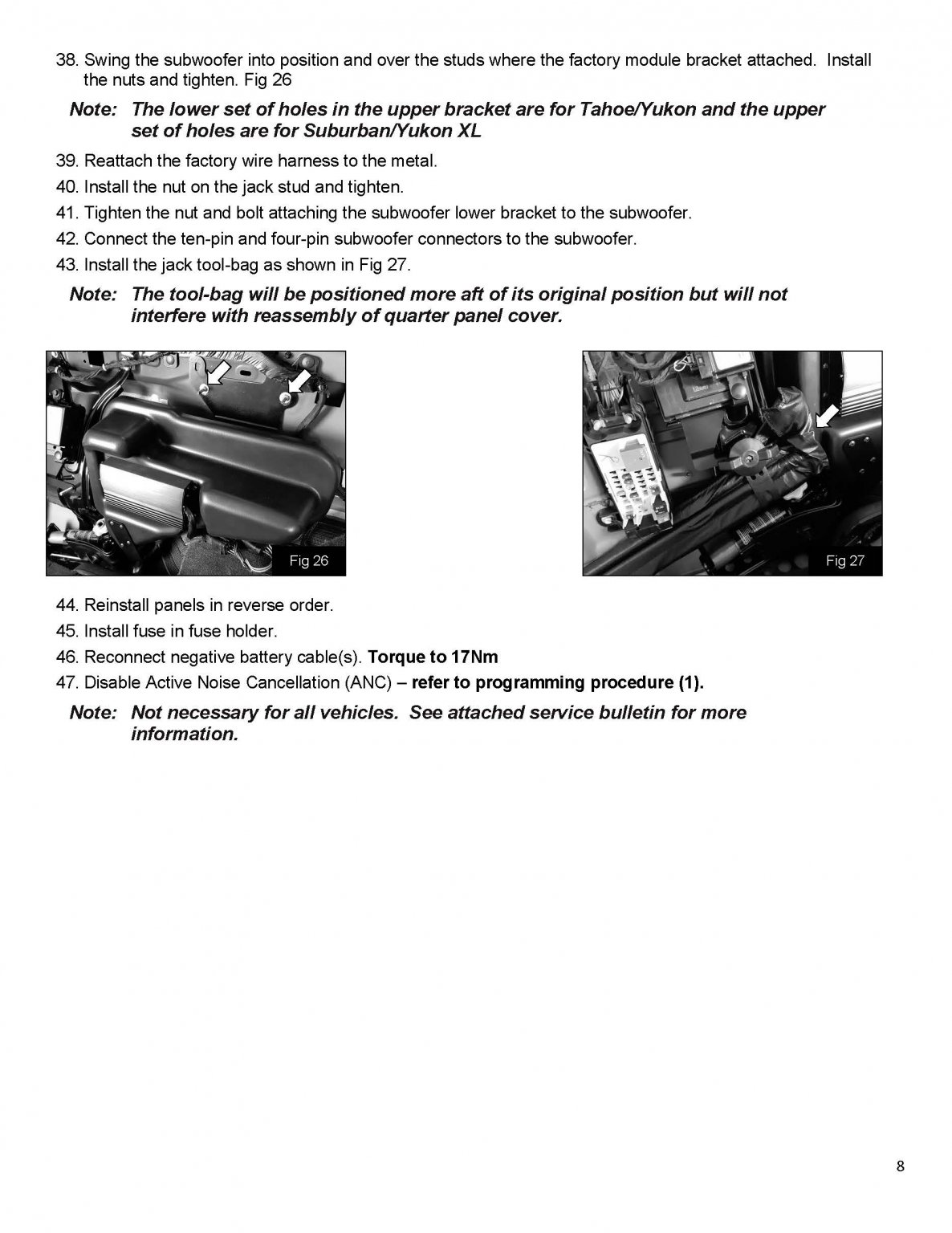

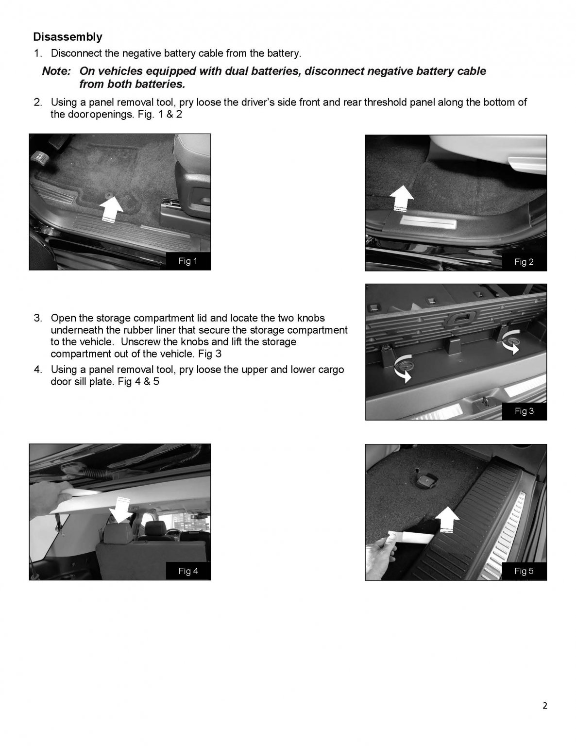

Kicker emailed me the instructions. It looks like it goes in the rear panel where the jack is located. It also looks like if you have the Denali with noise cancellation that the dealer has to reprogram the ecu to turn it off. Did anybody know that could be done.
