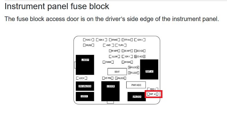

My sunroof died as well—in the open position. But I didn’t have a windshield replacement or anything like that. Turns out fuse 8DL had blown, which is unusual since nothing has been added to any circuit.
If someone else has the same problem, be sure to check not only the sunroof fuse in the right fuse box (30A), but also the 10A fuse for the switch in the left fuse box.
