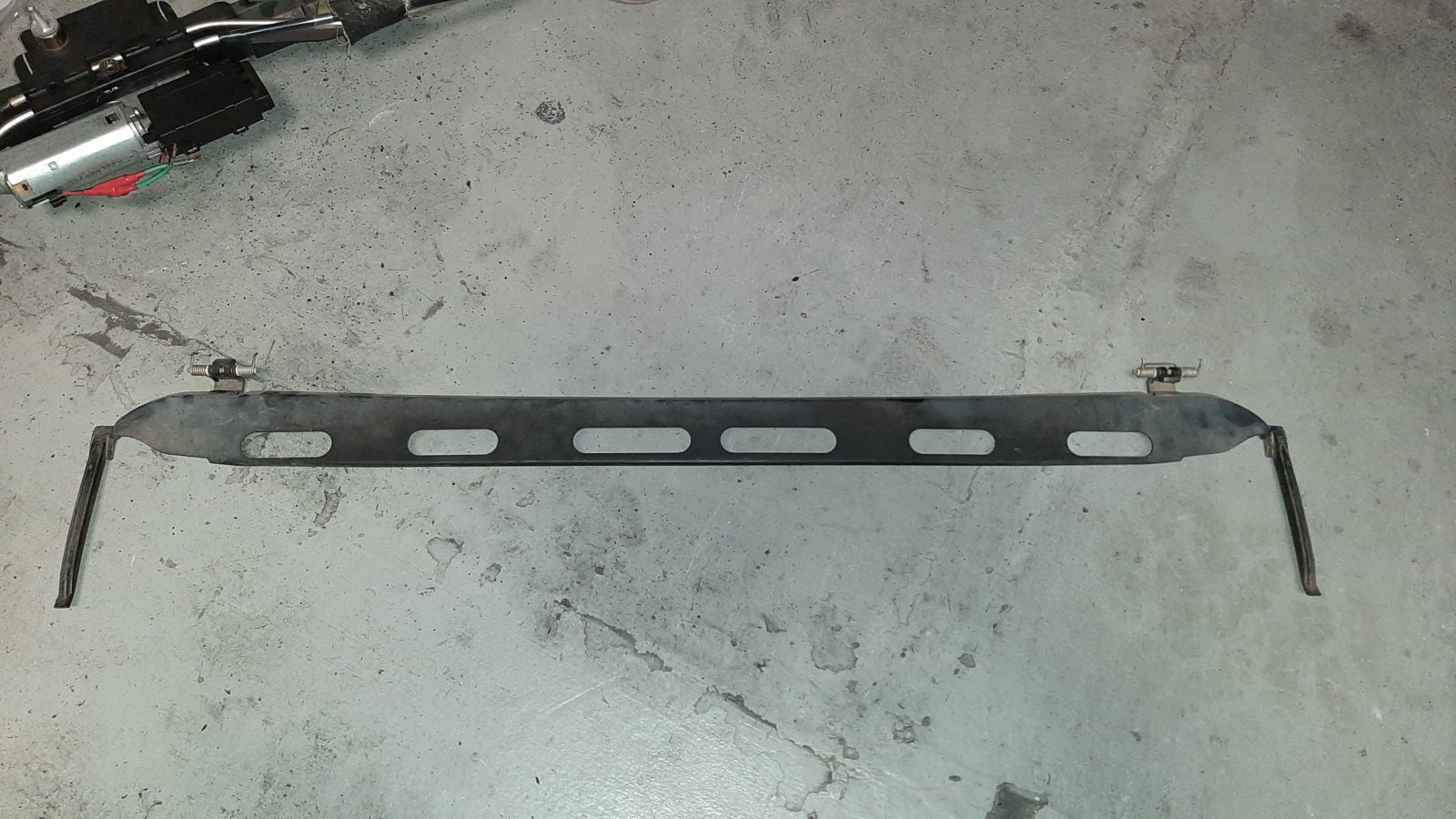

Now I need to learn howto reinstall this factory wind deflector. It came out when I removed the sunroof from the truck in the junkyard. I looked at GmPartsDirect / factory exploded view of parts. Didn't shed much light. I'm watching youtube sunroof videos hoping to catch a glimpse of how it sat in there lol
Hey Matt,
Did you ever figure out the reinstall of the wind deflector? While looking at cleaning my sunroof drain tubes, I noticed my wind deflector wasn't springing up as usual. The rear of the arms on either side of the deflector (on mine) look like they should be attached to the sunroof channel with small rivets, but appear to have broken off? The forward part of the deflector has a tab on either side that slide into small slots. I played around with the tabs/springs and was able to remove/reinstall the forward part of the deflector, but going to have to figure out a way to reattach the side arms in the channel. For the time being, I just removed the wind deflector so I can at least use the sunroof. Hope this helps.
