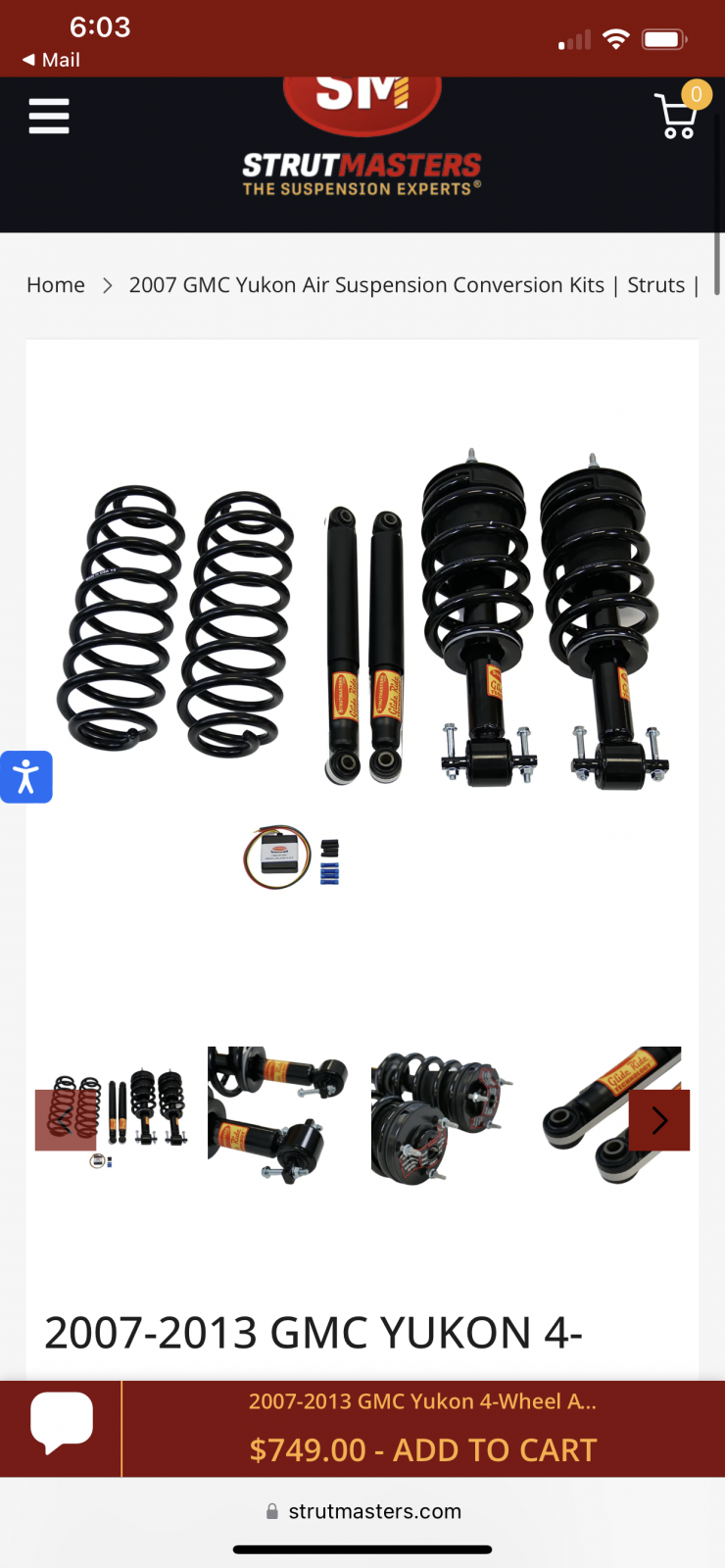

Question, if I buy this kit could I reuse the front springs and transfer them over to this kit or would I have to purchase new springs?

You can reuse the front springs, but they will have 200k+ miles on them and they do weaken a bit over time. Youcould still use them, or buy new OEM springs for about $65 each.

Should I get Denali springs or a more heavy duty kind such as like some for a Z71?

If you liked the smooth Denali ride, then, I'd go with the Denali springs. A heavier spring in the front will do nothing positive, and will make the ride stiffer.

Your right. That makes sense. You know after researching all of this I am now thinking that if I’m about to shell out 800 on new suspension components I could just lower it instead. There’s a Belltech kit for 600 to do a 2-4 drop. In the end the suspension gets updated and I’ll get the subtle drop I’ve wanted.

This is the kit I’m referring to. A guy on YouTube has a video of him installing it on a 08 Denali I believe. Except he kept the air ride but I’m not worried about that. 1ECAF73A-F5C8-4673-BB44-A3721DF26103.png
