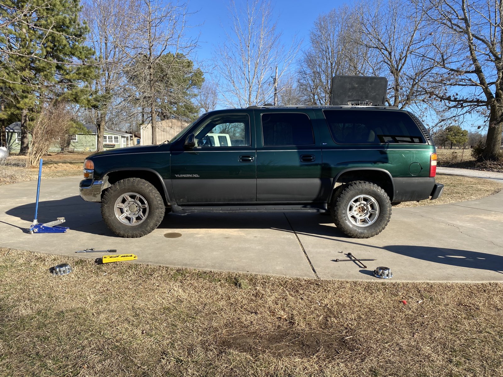

I also have a 3/4ton and was thinking of installing some H2 wheels, I think 285 or even 305's would fit and barley rub on full lock on H2's.
Would love to see a picture of this setup!
I think I am going to see what 285's look like on the same stock wheels you have first before making the wheel swap. The H2 polished/machined wheels would look great though!
Tons of '07-'10 2500 GM trucks running this setup, same frame and suspension clearance and other then a rub at fill lock no problems, you will have to crank the bars all the way but that isn't saying much as turned up all the way is only about 8-9 turns so not a lot of adjustment anyways.

I am looking into doing this with my '10 2500 xl. The main difference is the offset on the stockwheels is +29 and the h2 offset is +18.

Wow. It looks great. What is even more impressive is you coming back after all these years and posting pics. That is next level!!
