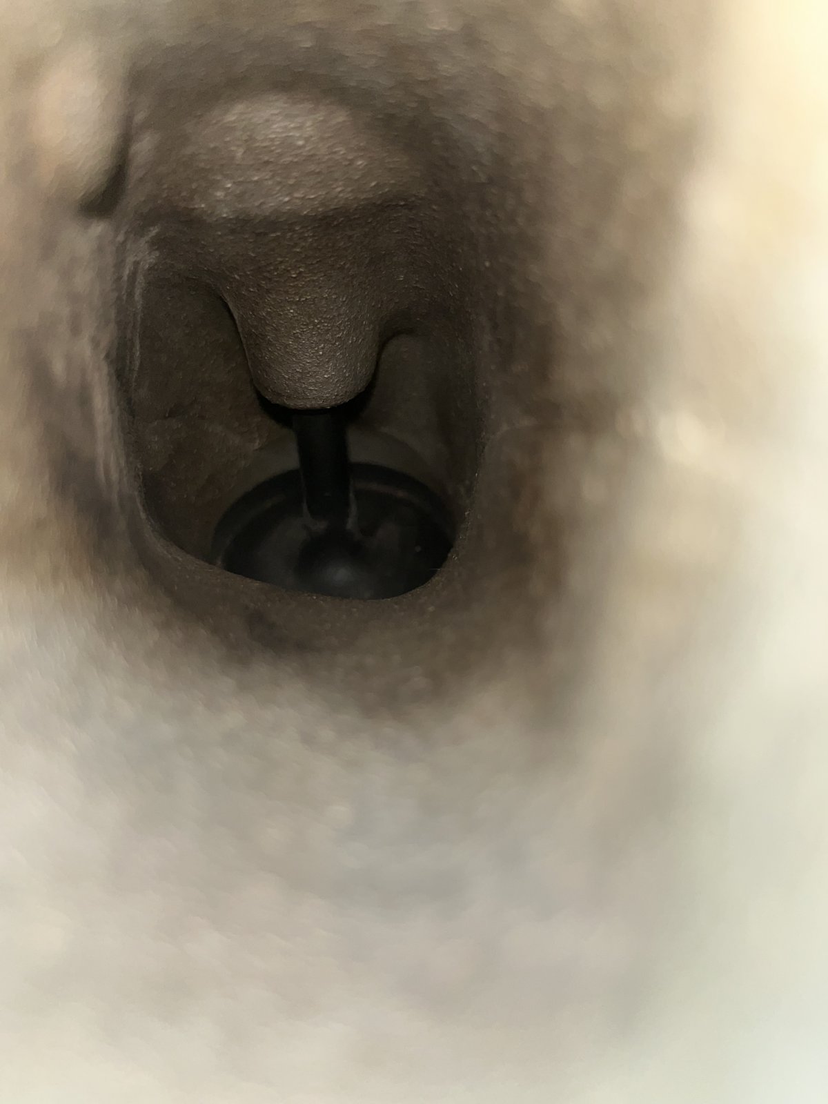

Figured I’d update the thread-
I removed the intake manifold and found the ports to have a lot of buildup, not as bad as others ive seen but pretty bad. I walnut blasted all the ports, new plugs, and cleaned the intake manifold as there was a lot of oily buildup in there as well. It runs significantly better but still feels like its missing slightly under load and idle, not as noticable. I’ll try and post some before and after pics of the ports IMG_8114.jpeg

Get a catch can now so you keep it clean. These DI engine need it.
Here is what mine looked like before I cleaned it. Bought it used and it had 100k miles with no catch can.
