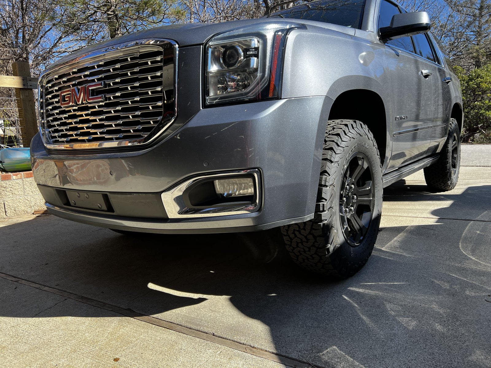

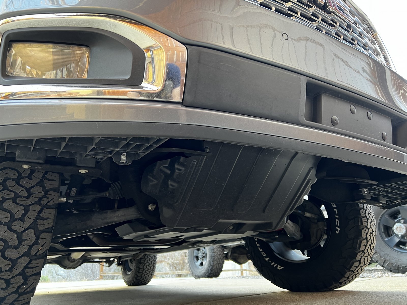

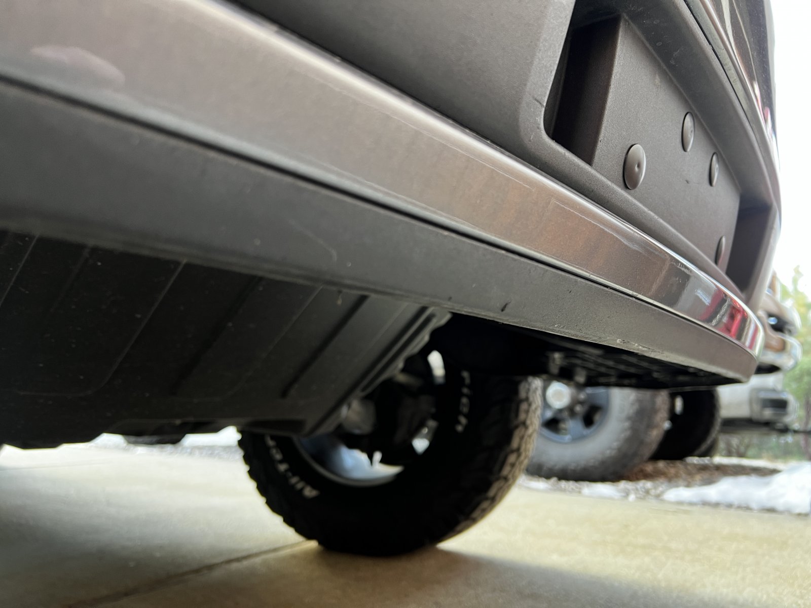

K, flathead driver, bend the black tab down dig into the gap and voila. Way more force than I expected. Airdam is off and I am going to dremel trim it to PPV-ish size and see how that turns out... Gotta cut a notch for the front hitch (for bikes) anyway.

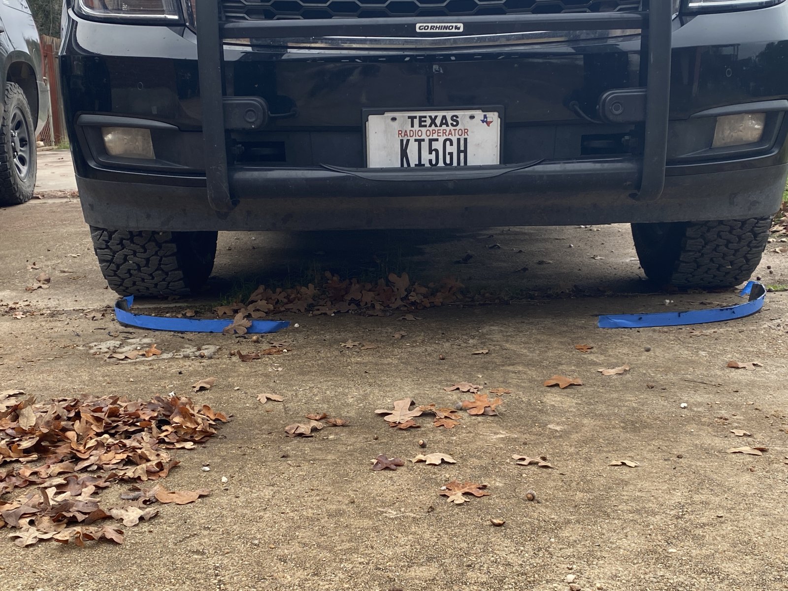

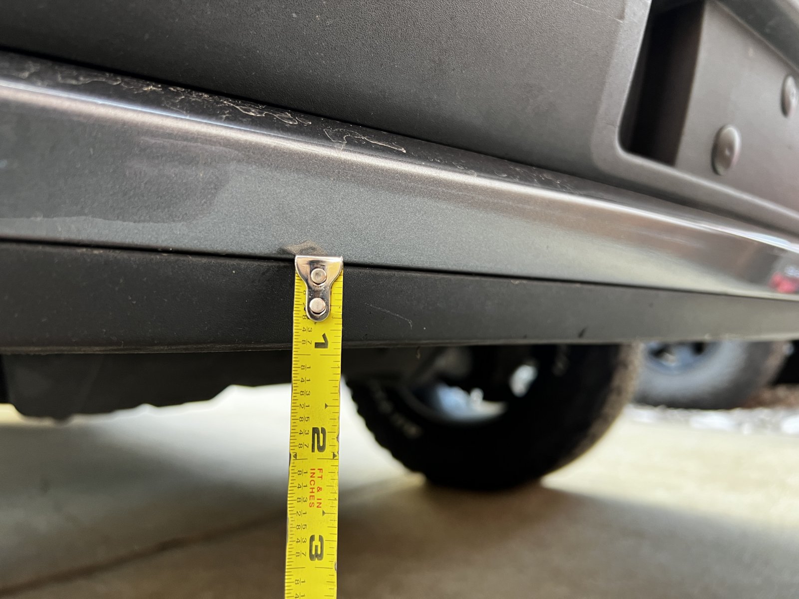

That looks pretty excellent! What lines/measurement did you use?
I'm getting ready to do this to mine.
There was kind of a natural crease I loosely followed. Pretty much just eye-balled it and then measured the tape line at intervals as I was masking it off to make sure the line stayed consistent.

We just finished putting on GM Part # 23365760
It is the Lower Deflector that comes on Tahoe PPV. it is about 1/4 of the length of the stock piece.
It's a small mod but I believe it has changed the look on our suburban quite a lot, we like it.
I got it at, for 281 plus shipping
https://www.gmpartso...lector-23365760
The main reason was to gain ground clearance, for these off-road times, like when parking at a mall to clear curbs smile.png
Also already helps on steep driveways and coming out of parking lots...
The removal of the old piece and installation of the new one was quite simple. Remove some bolts/ torque screws, pushing down some clip, partial removal of front wheels liners.
