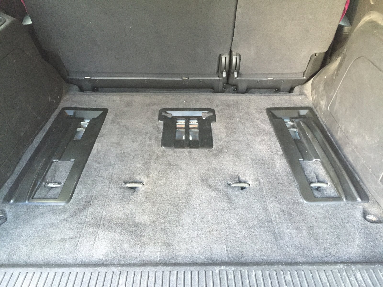

Tahoe/Suburban 3rd row seat installed

Looks great! Mine went pretty easy too. The bolts came out with no problem and the epoxy sealant stuff came right off. Just have to make sure that you give the openings around the floor brackets plenty of room otherwise the seats may not connect right. My 3rd row seats came out of an Escalade and went in no problem. For those who haven't done this yet, it's a quick and easy job.

I had to use totally different bolts cause I felt like i was stripping the threads.

Thanks. The trim pieces came out of the donor vehicle I got the seats out of. Havent thought about locking them in, didnt think they would be something somebody would steal but nothing really surprises me anymore.
