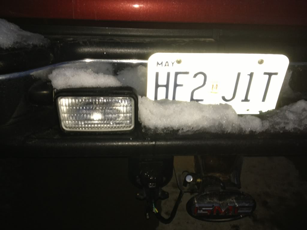

When you are done it should look similar to this.
(The black is my ACC (Tail Light) the Red is my 12v (Power)
When you flick the switch on the reverse lights will turn on.

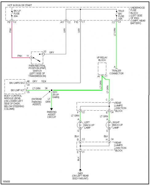

Now let's say you don't want to put that much wire in to the reverse light. That's fine, you can tap into the wire in the dash. It goes to your onstar system and tells the vehicle when it is in reverse. To get to that open up the fuse box on the side of your steering wheel under the A-Column.
Find the wire harness with the foam wrapped around, rip the tape open.
The wire you are looking for is olive green.
Just to make sure it is the right wire, get a test light, poke the point side into the olive green wire and connect the other side to a ground, now when you switch into reverse the light on the test lead should turn on, and when you switch out, it should turn off. You can tap into this wire for the ACC on the switch instead of running to the back. ENJOY!
